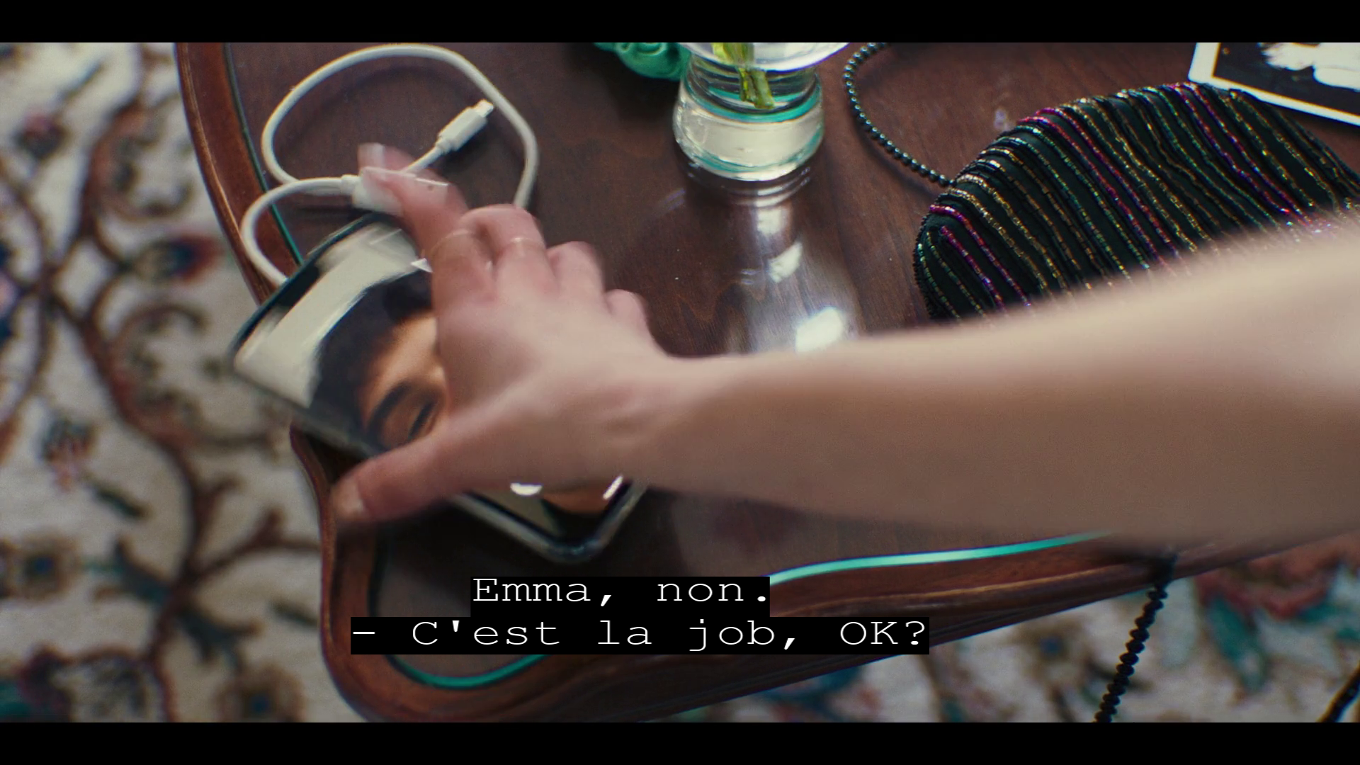

    I am quite the amateur when it comes to video and subtitles.
    When I open a video in VLC, it shows 6 subtitles track. 2 tracks that MKVToolNix and CCExtractor recognise, and 4 others that they don't. Alas, that one I want to extract is one of those. I don't know how to figure out what sort of subtitles they are.
    Here how VLC presents them:
    [Attachment 92674 - Click to enlarge]
    I first thought they were teletext but as I said, I'm quite the amateur so I'm not sure. I've come across the term DVB subtitles as well.
    I've also seen ffmpeg been recommended but I'll admit I really struggle with command lines. I cannot begin to fathom what to write to figure out how to get the information and how to extract the subs/teletext/whatever they are.
    The reason I want to convert it to a srt file is to change their appearance in VLC because they are not easy to read at all in this format.
    Hope you can help
