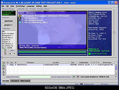

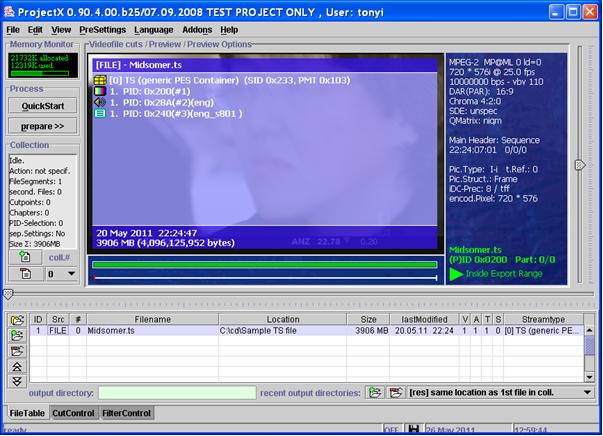

    Download ProjectX and then follow these simple steps :
    DONT make any cuts to the TS file (yet), as information at the start of the recording is required to extract the subs and align them.
    1. In ProjectX, under "Pre-settings -> Subtitles", check one of the Unicode output options (e.g. UTF-8 or UTF-16) (either will work)
    2. under "teletext pages to decode", choose 801 (for Australia) (Type this in, as it's not in the drop down menu)
    3. choose your subtitle export format (SRT is reportedly the only one reliable across all channels)
    4. under that select txt.
    Demux your recording into video (MPEG-2), audio (usually MP2 for SD), and subtitles (the format chosen above). If you just want the subtitles decheck everything except subtitles.
    Summary:
    1. Set the subtitle format to decode: SRT and text
    2. Click on Output and select all stream types to process
    3. Close window
    4. Click on Process > Prepare
    5. Click on Action: and select demux and close window
    6. Click on File > Add and browse to the subfolder where the *.ts file is stored and select the *.ts file
    You will notice that the preview window now changes to the first frame in the imported file.
    7. Click on Process > QuickStart
    If you aren't sure whether there are any subs in a particular TS, open the file in ProjectX and click on it in the display list below the viewing screen area. The details will then be displayed in the viewing area. If there are subtitles, it will state that there is a video PID, an entry for the subtitles.
    It will export the files to the same folder of the original file.
    NOW you can make a COPY of the TS file and trim the start and end if you want, and then use a subtitle editing program such as Subtitle Edit or Subsync to change the start times and synch the subtitles.
    If you coose to remove advertisements, you'll need to do a lot of aligning of the subtitles though.
    Thats it. Good luck, and I hope I've made this simple for everyone once and for all.
