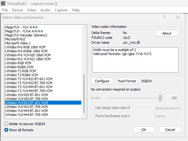

  7. and UTvideo codecs for lossles or the standard one provided ?
    May 2005
    Australia-PAL Land
    UTVideo is good for lossless capture. Use the "ULY2" version:
    [Attachment 88974 - Click to enlarge]
  9. Originally Posted by Alwyn View Post
    good because the compression is better than Lagarith? (or there is some more ? )
  10. Kawaiiii
    May 2021
    Italy
    The main reason is that while UT codec is still developed Lagarith isn't.
    Anyway.. UT is a very good codec for realtime/lossless capture.
  11. UT is much faster than Lagarith. You're less likely to have dropped frames with UT.
