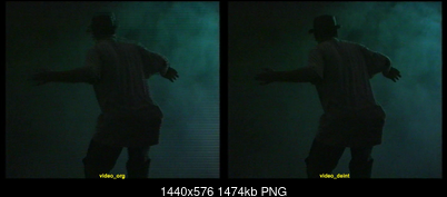

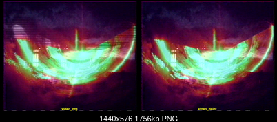

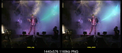

    [Attachment 70875 - Click to enlarge]
    [Attachment 70876 - Click to enlarge]
    [Attachment 70877 - Click to enlarge]
    Maybe a decimation at the end with appropriate parameter to remove duplicates (if any) can be added.
