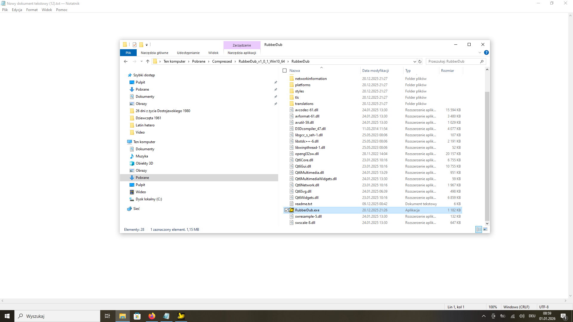

  13. I unpacked RubberDub_v1_0_1_Win10_64.zip, and this is what it looks like.
    [Attachment 90560 - Click to enlarge]

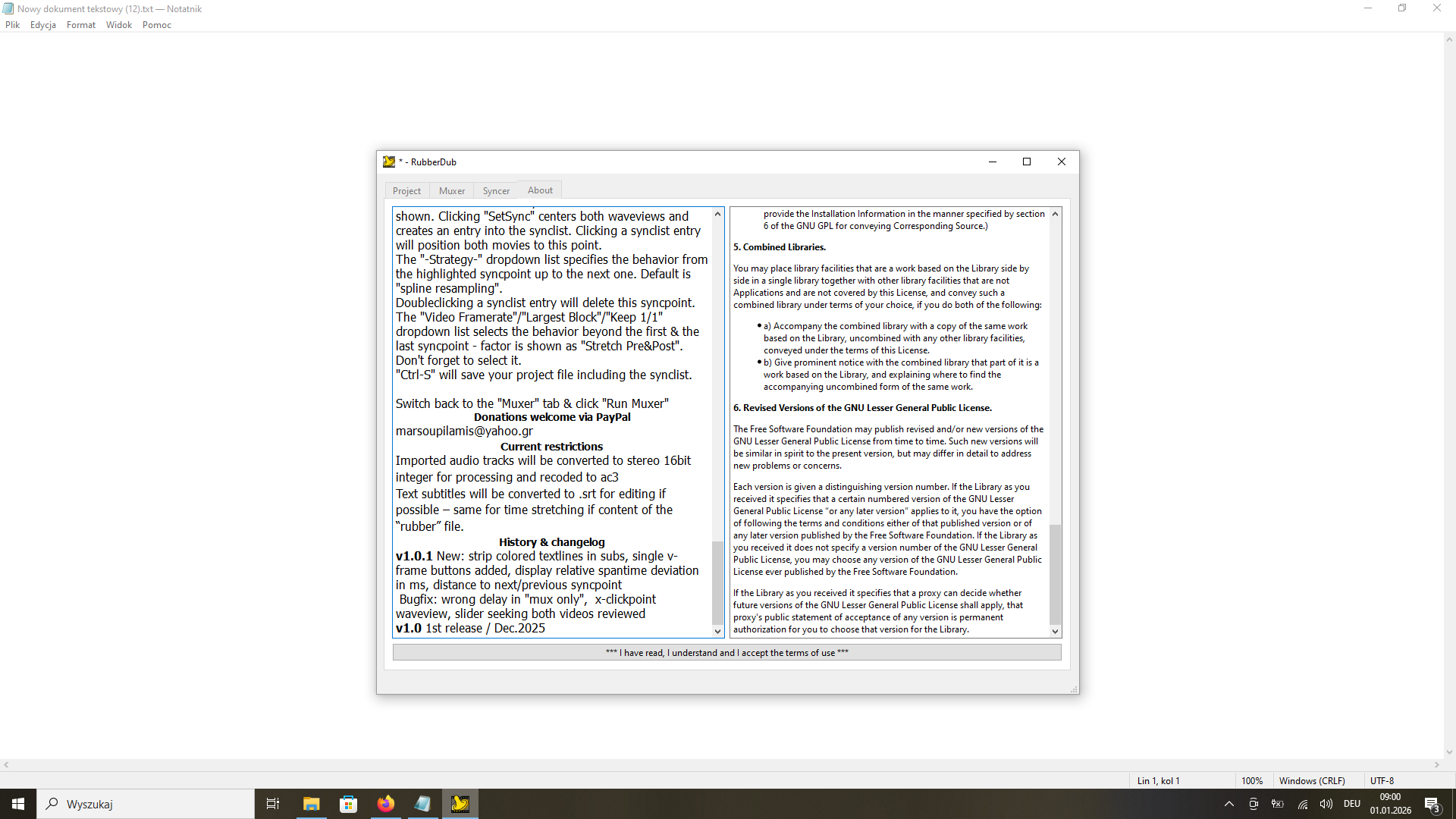

    Then I clicked RubberDub.exe, and a two-page information window popped up, but without any "Next" button. In this window, functions like Project, Muxer, Syncer, and About were disabled.
    [Attachment 90561 - Click to enlarge]

  14. Click on I have read..
  15. Thanks for the quick reply, ProWo. That bar in RubberDub.exe was so narrow and long, I almost didn't see it, but I accepted it, and now everything's fine.
    And there are two windows, one for video and one for audio synchronization, I think.
