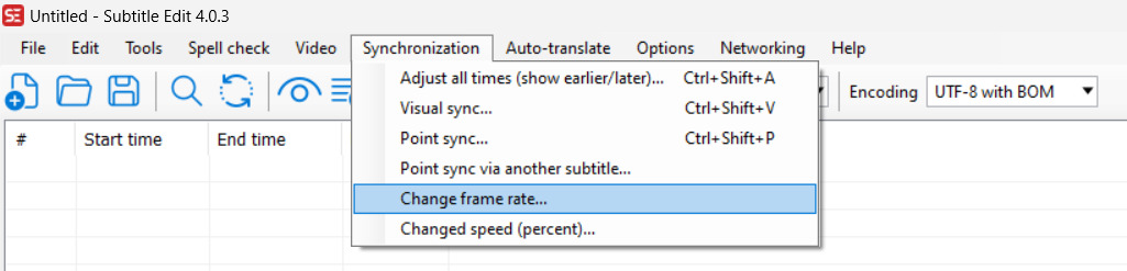

My problem is that I have a sub(.srt) that I cannot sync, because when I put the first line in the correct time the flowing ones get out of sync as the video progresses. To be clear, I'm using Subtitle Edit: Synchronization > Adjust all times, this way I fix all the lines at once.
The only way I can sync the subs is by selecting: Video > SMPTE timing, but I guess this just adapts the video to the subs.
I checked the source video of the subs with MediaInfo and it says that the Frame Rate is 30.000 FPS (Constant), and in the other video that I want to synchronize the subs is 29.970 FPS (Variable). I don't know if this is the real problem and how can I fix it without having to do it line by line.
Another thing I can say is that I ripped the subs from mkv and I'm trying to sync to mp4, I don't know if this is a problem too.
Thanks for all the advice you can give me.
[Attachment 77162 - Click to enlarge]
