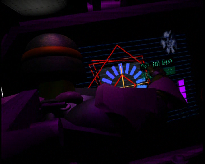

I attempted to use jagabo's fix in my previous thread from a few years ago.
Unfortunately nothing appears to fix the issue. I've even tried reordering the fields in to no avail.
[Attachment 73223 - Click to enlarge]
Frames 189 and 193 in the attached m2v are stubbornly broken. I suspect what Brad said in the previous thread applies here as well:
Still it's been almost two full years since that thread, so perhaps there's now a way to fix that and these better?
This works pretty well:
Though I saw the frames as 177 and 181.Code:Mpeg2Source("messed_up_progressive.d2v", CPU2="ooooxx", Info=3) TFM(field=0) -
Indeed it does! Thank you.
As for the discrepancy in frames numbers, I believe that was due to my using FFmpegSource2 to load the m2v in VirtualDub.
