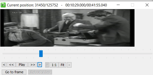

  1. Hi. I downloaded a programme off the TV and got a .ts file. I used MeGUI to index it and saw combing in the preview. In the 'script' tab I put 'separatefields()' and then clicked 'Preview Script' and there was motion every field. I then saved the script and closed MeGUI.
    I opened the saved script with MeGUI and, as a double check, added separatefields() again. Motion every second field! I started from scratch but the result was the same - in it's pre-saved state, I'm seeing motion every field but after saving the script, it's every second field.
    Why should that be and which one do I go with - QTGMC or TIVTC? A sample of the file follows.
    Supplementary question: when I use separatefields in the pre-saved (preview) version of the script, the preview is squashed as in the attachment. The 'Fit' buttons don't work despite looking active. Why should this be and can I fix it?
    Many thanks indeed.

    The preview would be squashed since separatefields gives a half height image. It looks interlaced to me, 25 frames/50 fields per second
  3. Yes, it's interlaced TFF, not telecined. One should just apply QTGMC for (bob-)deinterlacing.
    The frame width of 544 (including the pillarboxing) looks a bit unusual to me, but when one forces the playback as 4:3 the AR looks (about) correct to me.
    As has been mentioned by davexnet when you separate the fields they will be displayed at half height, so 576/2=488, hence nothing wrong there.
  4. Thanks, guys. It would be interesting to know why using separatefields in the 'preview' stage i.e. before saving the script, gives motion every second frame.
    In the circs, would it be fair to say that the separatefields test should preferably be done on a saved script?
  5. Originally Posted by pooksahib View Post
    Well, you probably saved the script which contained the separatesfields(), then re-opened that script and added separatefields() again. Hence you ended up with a fieldsequence of 100 fields per second of 144 pixels height, duplicating every field. You should separate the fields only once, getting 50 field per second of 288 pixels height.
