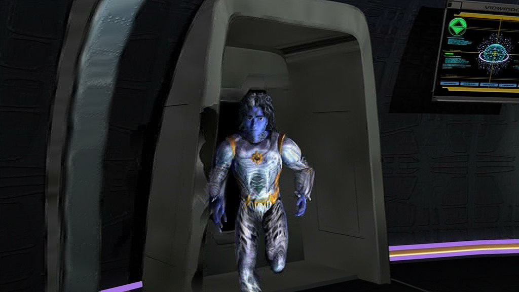

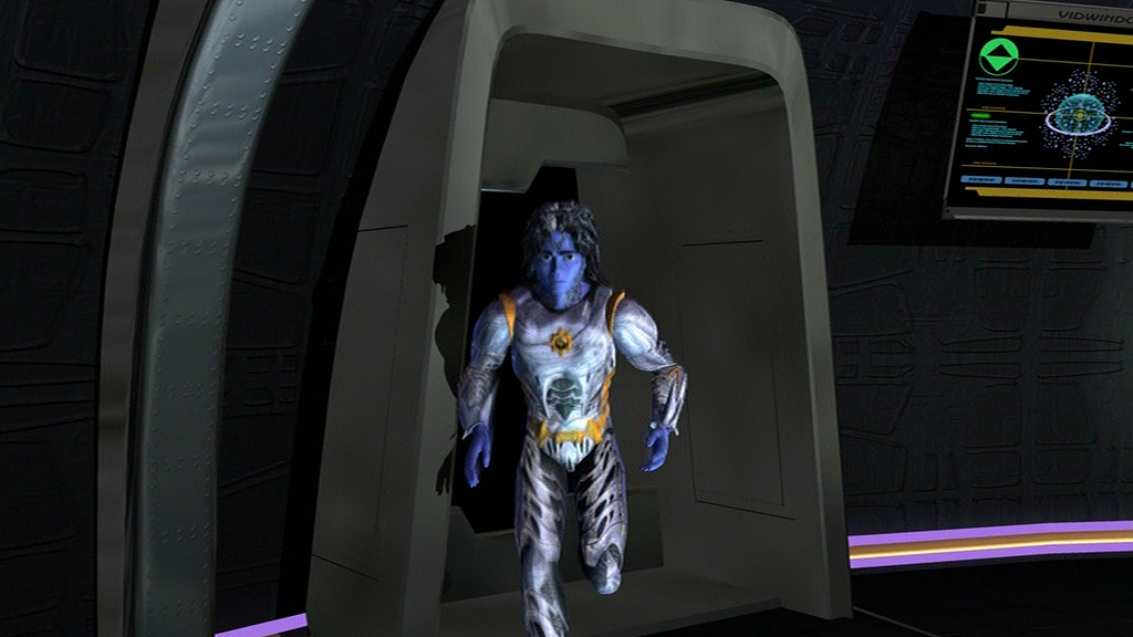

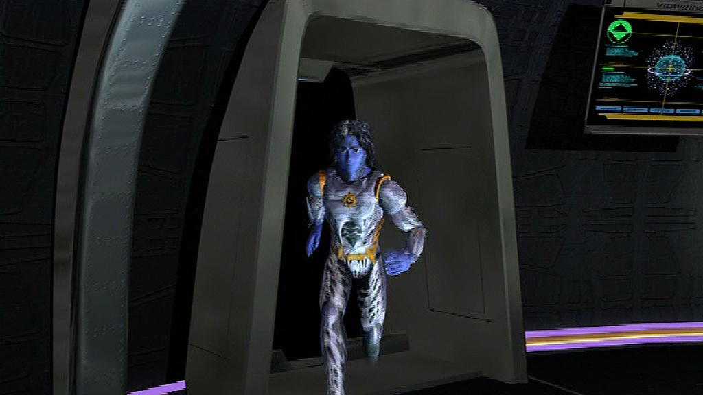

    So usually I'd use TFM() or even QTGMC(FPSDivisor=2), and that'd take care of it, but neither yield satisfactory results.
    Raw:
    [Attachment 61847 - Click to enlarge]
    TFM: (note the duplicate frame afterwards which still has issues)
    [Attachment 61849 - Click to enlarge]
    [Attachment 61850 - Click to enlarge]
    QTGMC (again a duplicate with issues):
    [Attachment 61851 - Click to enlarge]
    [Attachment 61852 - Click to enlarge]
    There are also a few very aliased frames as well. Almost the entire scene is just one big mess.
    [Attachment 61848 - Click to enlarge]
    Looking to avoid duplicate frames and maintain the 25FPS if at all possible.
    Many thanks in advance!
