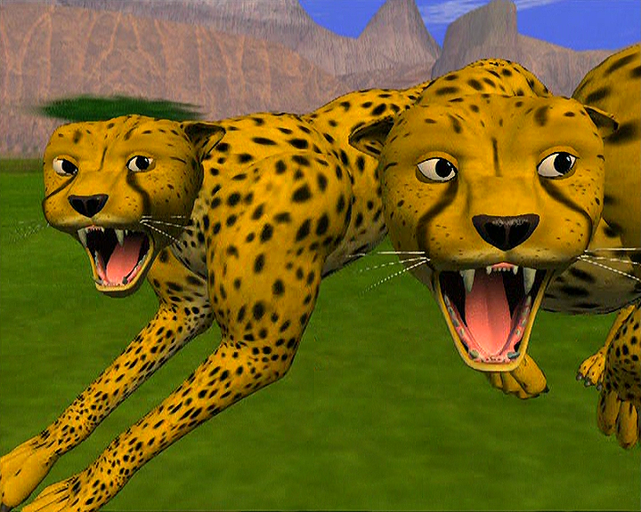

    Overall the video is progressive 25FPS PAL, but some scenes with shaking have this severe telecined issue.
    [Attachment 57939 - Click to enlarge]
    I've tried TFM() but that only partially fixes it.
    Is there any method to correct these frames?

  3. QTGMC() or QTGMC(FPSDivisor=2). The latter attached.
    Oh wow that looks fantastic! Thank you very much, I really appreciate the help.

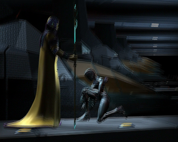

    Are there any ways to do a similar correction to this sequence?
    [Attachment 57955 - Click to enlarge]
    After applying QTGMC(FPSDivisor=2) to it, it does help to a degree:
    [Attachment 57956 - Click to enlarge]
    But if there's any additional methods to smooth out the whiskers that'd be great.
    I don't know of any filters that will fix the whiskers without destroying the rest of the picture.
