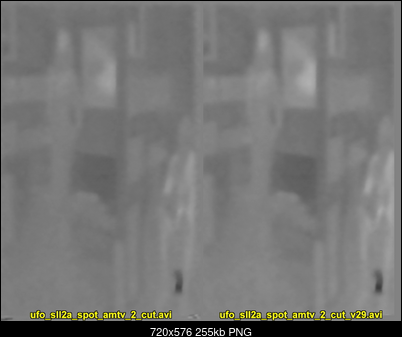

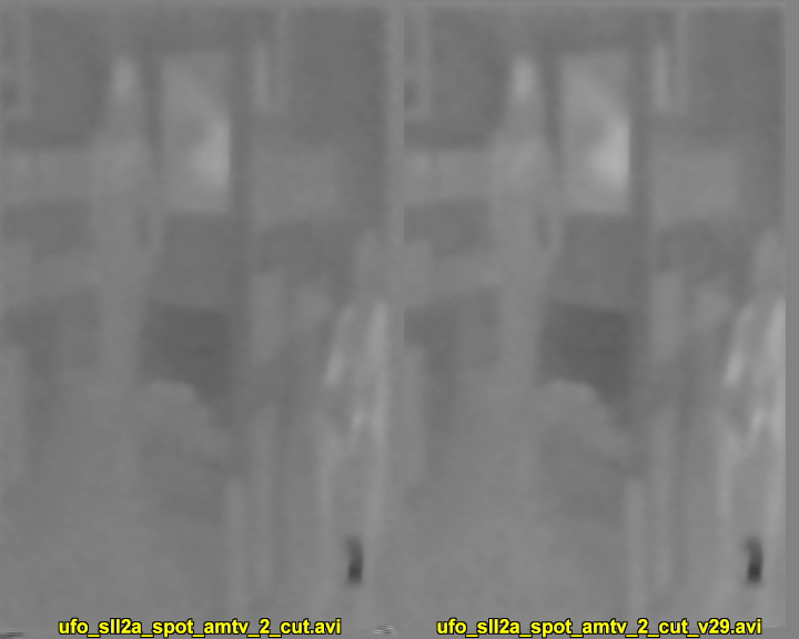

    I thought of this because the sharp edges in the U chroma look a bit "residual" to me, which is an artefact by temporal noise reduction.
    IMO there should be in addition a sharpening on the chroma, otherwise the temporal noise reduction itself is barely able to produce such effect. Here a sample of mine:

    That's why the best sharpener do not touch the chroma, or we set to copy back the chroma from the video before sharpening at the end of the processing.
    For sure the Panasonic NR is not that accurate as what we do in AviSynth...

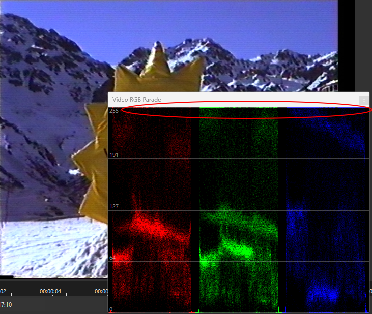

    The color panel in Shotcut shows the RGB parade and one will see any RGB clipping immediately. One will also find that it is not always possible to exploit the full 16......235 luma range in VHS captures, but one may have to re-adjust (normally reduce) brightness, contrast, saturation (levels in general terms) to prevent RGB gamut violations. Buzzword: the inner RGB cube within the YUV color space.
    Maybe someone else wants to confirm (hopefully) Shotcut's correct handling of interlaced 4:2:2 and 4:2:0.
    As Kdenlive uses the same framework from MLT it should handle interlaced 4:2:0 correctly as well now, but I didn't test it as I am not using it.
    Added:
    See the RGB clipping in the 'sample_uncompressed.avi' file. It's not dramatic, but it's there:

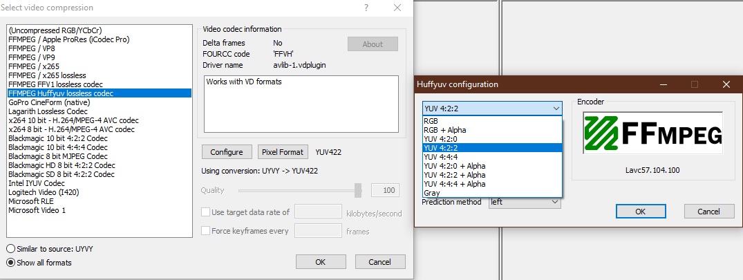

    In terms of converting the recorded "uncompressed YUF" files into HuffYuf, VirtualDub offers several options.
    First question: is HuffYuf better / worse than Largarith or the other lossless codecs listet there, for example x.265 (lossless) or FFV1? Which of these should I choose?
    If I go for HuffYuf, are these options correct? Not RGB but YUV 4:2:2?
    [Attachment 72061 - Click to enlarge]
  26. Looks ok to me, using the ffmpeg Huffy codec.
    It reduces the filesize by lossless compression of your raw uncompressed capture, but it doesn't fix any YUV <-> RGB conversion issues.
    You mean, the thing that @Brad mentioned in #157?
    I thought we had solved this by turning the AV-in NR off, as @Skiller proposed??
    So, you would recommend the Huffy codec? None of the other lossless ones listed there? Wasn't HuffYuf problematic when importing into NLEs which then interpret it as RGB or so I read?

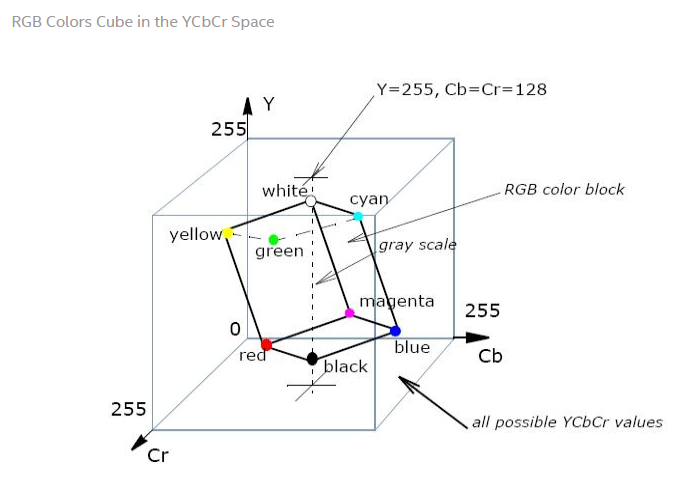

    I am talking about valid 8 bit YUV (Y'CbCr) tristimuli which - when converted to RGB for filtering or just for viewing on a monitor - produce out-of-gamut i.e. illegal RGB tristimuli (<0 or >255) which get normally clipped to 255 or 0 (see post#200) and cause color distortions.
    In extreme case it may boil down to deciding between a brilliant, high contrast/high saturation picture loosing some details, versus a less "shining" but 'technically correct' picture preserving all details and gradients.
    In the picture below only YUV (aka Y'CbCr) tristimuli which are within the inner RGB cube produce valid RGB tristimuli, useful for viewing on a display.
    https://www.intel.com/content/www/us/en/docs/ipp/developer-reference/2021-7/color-mode...en?language=en
    Uh, I may have opened another can of worms ....
    You find a lot about this in posts and tutorials in this and in the doom9 forum from jagabo and poisondeathray et al. Just google.

  30. Originally Posted by Marvolo View Post
    Better/worse in what way ?
    All the "lossless" compressors have pros/cons in terms of encoding speed, decoding speed, compatibility with various programs, quircks, compression ratio. If you're doing it offline (after capture as a 2nd step), encoding speed is less of an issue (other wise you might drop frames during capture)
    Highest compression is usually x264 in lossless mode with temporal compression, or FFV1 with temporal compression (long GOP), but they are the least compatible, most slow to edit (higher compression usually means slower encoding/decoding speed)
    Lagarith usually has the highest I-frame compression. UT video or magicyuv usually have the highest encoding/decoding speed , lowest overhead (fast editing, fast performance for capture), but speed is usually not an issue for SD material. HD / UHD it becomes more noticable
    x265 is the worst for your case. The lossless compression ratio is somehow always worse than x264, and compatibility lower and decoders gernerally do not support interlace
    That screenshot is FFVHUFF, it's a libavcodec/ffmpeg variation on the original Huffyuv . Many capture guys swear on huffyuv 2.1.1 CCESP2 patch version for some reason. It just works for them. It's one of the few that has an interlace flag (but some programs still do not read the flag)
    In short, it depends on how you're going to be using it. Beware of mishandling issues with NLE's as discussed above
