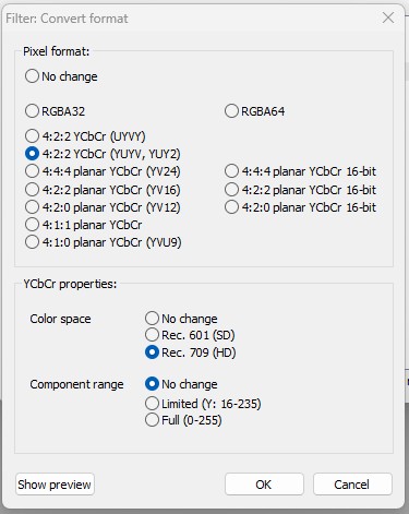

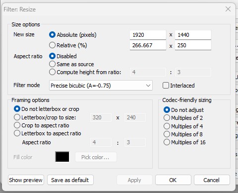

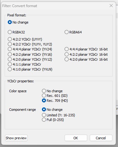

    In VDub:
    To change the colour format, use the Convert Format filter (I did ask a question on VH some time ago and never got an answer so here goes):
    [Attachment 71227 - Click to enlarge]
    or
    [Attachment 71229 - Click to enlarge]
    I don't know which is the correct one.
    To resize (to my preferred YT resolution):
    [Attachment 71228 - Click to enlarge]
    In the x264 encoder, leave both SARs as 1.
    Re YT uploads, if your files are at least 1440P ie for SD, 1920x1440, YT will use the better VP9 codec for your videos. The frame rate and bitrate is irrelevant.

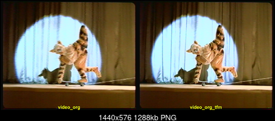

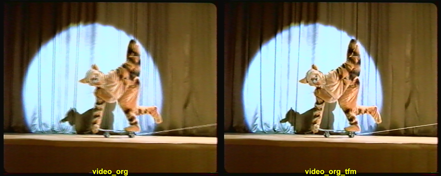

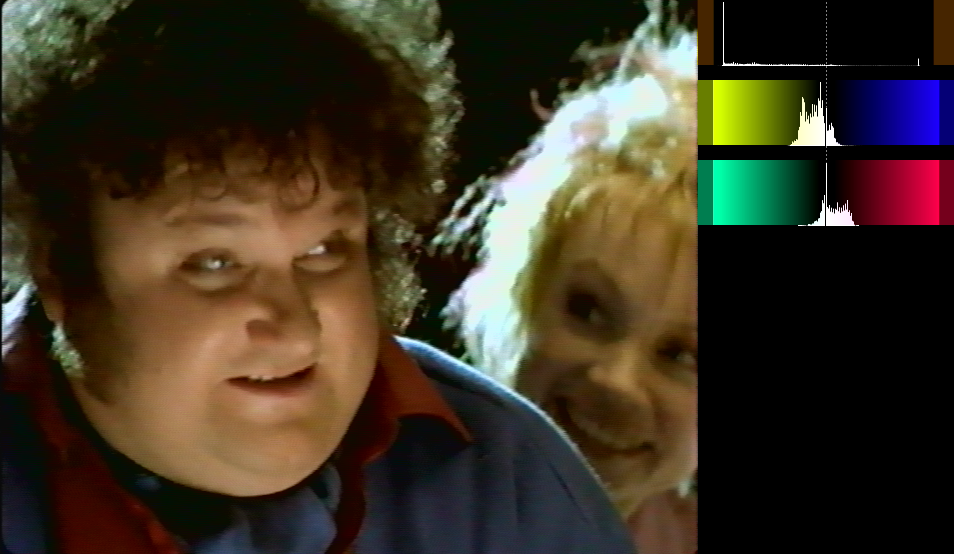

    Your capture is fine from the field architecture point of view.
    The original source shows phase shift for some sequence, fixable with a simple field matching operation (applicable to the whole video, the filter will shift the fields only when needed):
    AssumeTFF().TFM(order=1,mode=0,PP=0,slow=2,field=1)

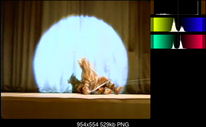

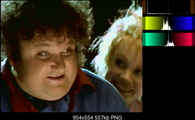

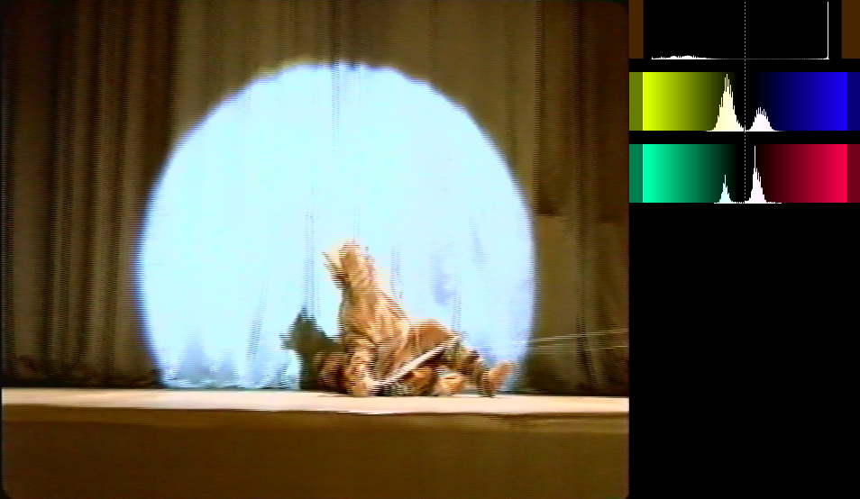

    edit: the histogram suffers of crushed blacks and clipped whites, probably because the card. Try to use its procamp if possible for a better distibution of the levels:
