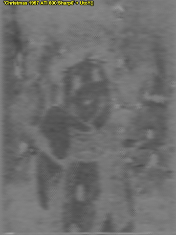

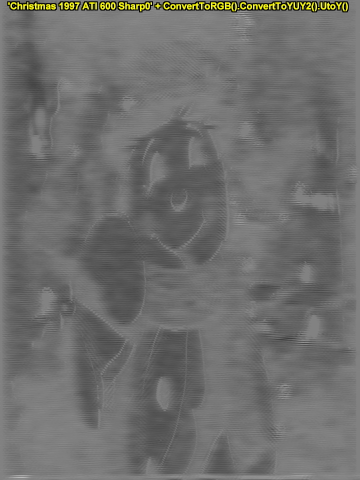

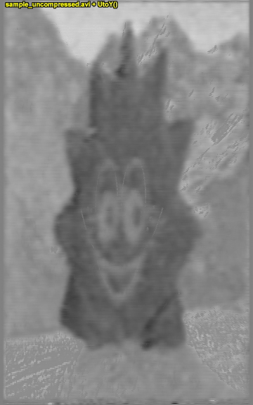

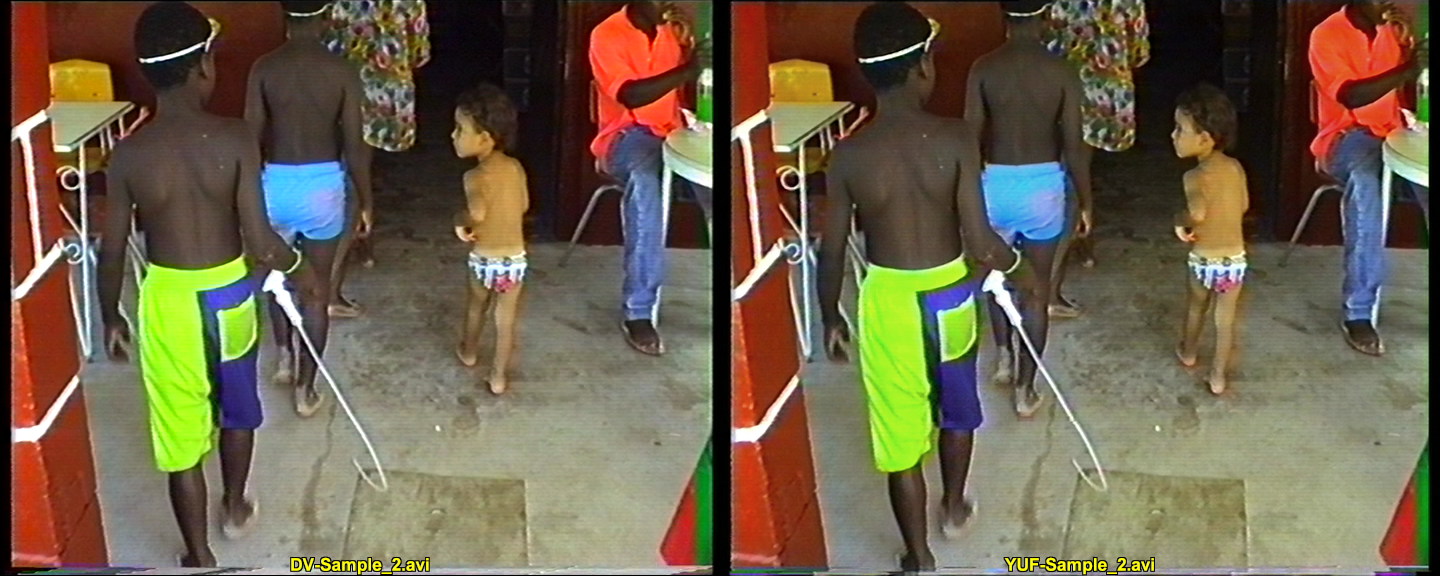

    The uncompressed UYVY sample suffers from a YCbCr -> RGB -> YCbCr conversion at some point.
    Does the German guide include instructions about setting the HDMI output of your Panasonic DMR-EH575 to YCbCr 4:2:2? I think they typically default to RGB.
    LWLibavVideoSource("sample_uncompressed.avi")
    UtoY()
    Subtitle("sample_uncompressed.avi + UtoY()",size=11)
    Example showing how YCbCr -> RGB -> YCbCr affects chroma. Left is straight UtoY from one of my old YUY2 captures. Right has been degraded by conversion. False edges are created.
    My YouTube channel with little clips: vhs-decode, comparing TBC, etc.

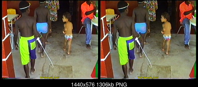

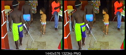

    OK, here's the same sequence as from the very beginning of this thread (outdoor scenery, beach, clouds) when we were comparing the two 2008 and 2023 DV captures.
    This time: one is the uncompressed capture, the other the 2008 DV original (this time, no Smart Rendering with my NLE. I used VDub here as well).

    In this post, I'm going to send another comparison where there is a lot of different colors present. While we now have already observed that for the uncompressed captures, the colors / saturation seems to be increased, my impression is that the colors in this clip here in the uncompressed one are almost a tad too strong compared to the DV one?
    I might make a comparison with the neighbor's cam later when I get to it. Maybe saturation will be not so strong with his cam?!

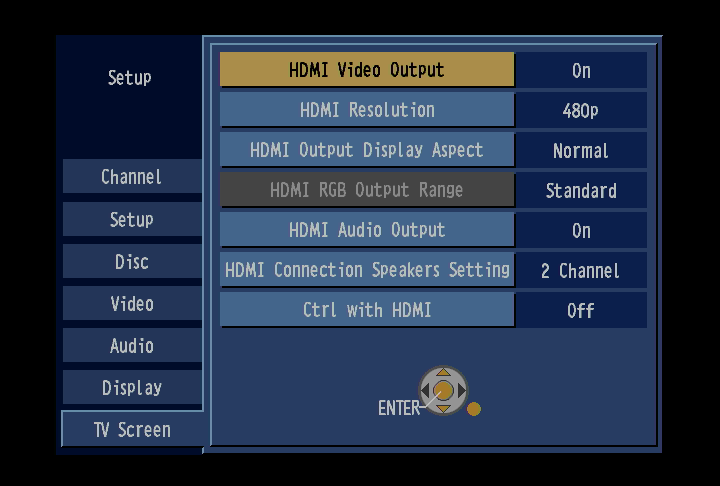

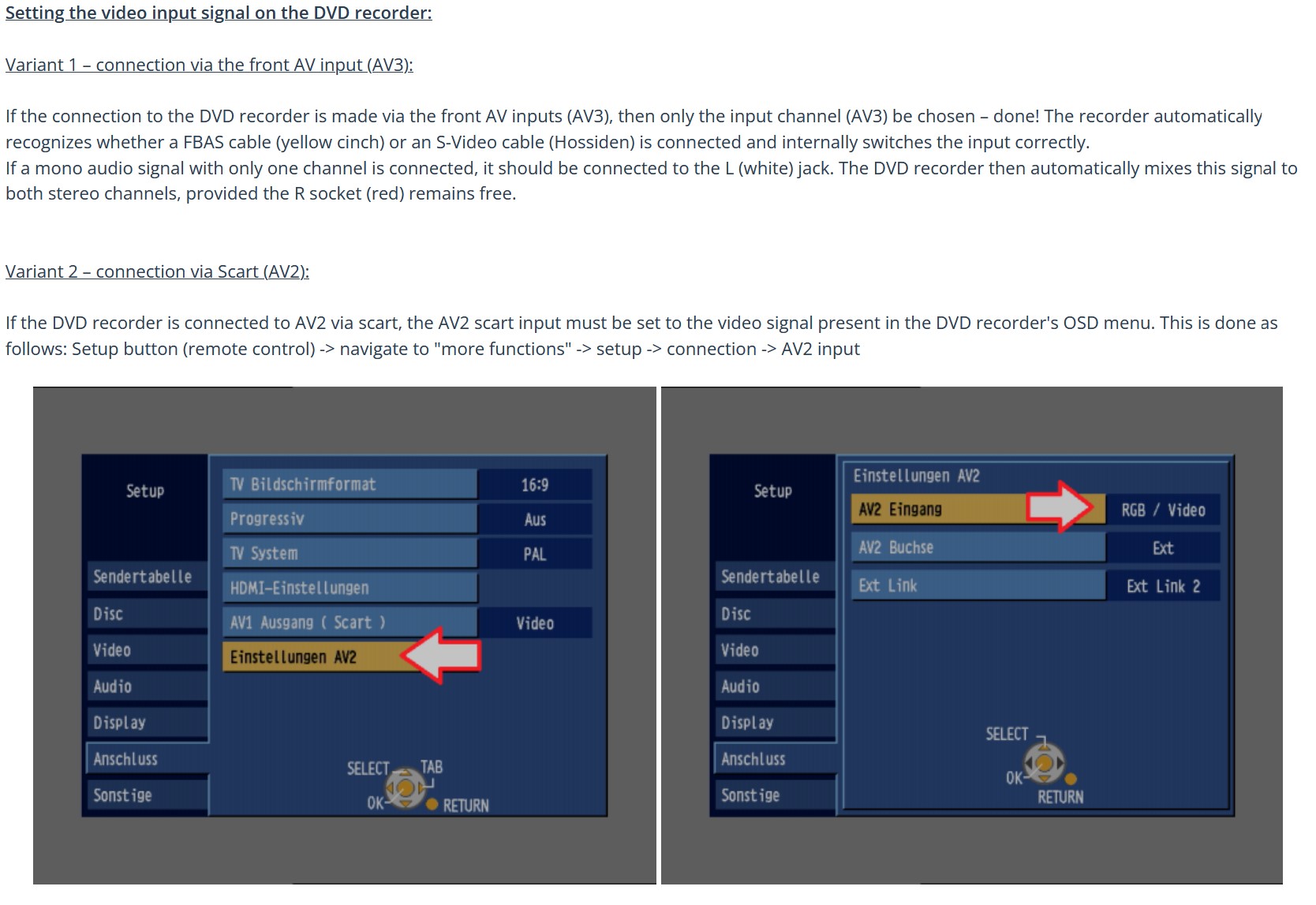

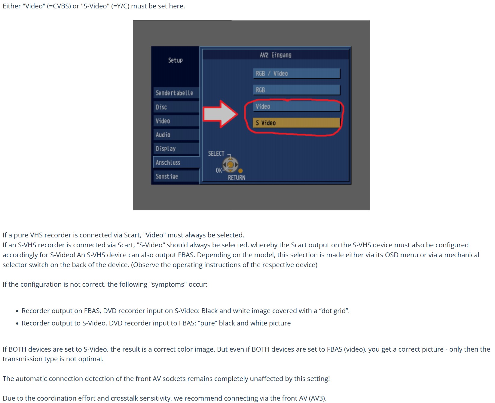

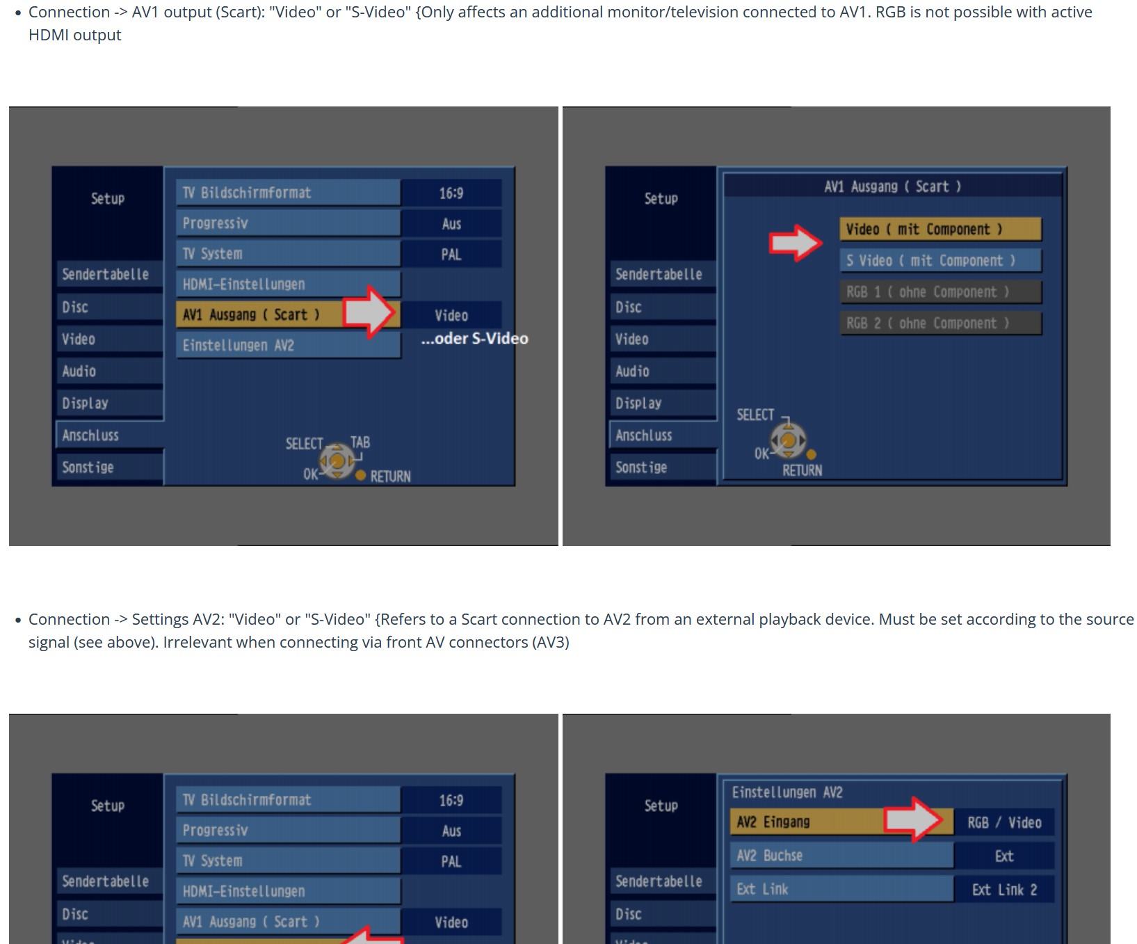

    That's what the guide says:
    [Attachment 72002 - Click to enlarge]
    [Attachment 72003 - Click to enlarge]
    [Attachment 72004 - Click to enlarge]
    The way I understand it, all those settings are irrelevant for me because I connected the D8 cam at the Panasonic's AV3 front panel, not via SCART ports (AV1) in the back.
    The AV3 front panel automatically detects whether S-Video or FBAS is connected and the player then activates the signal path it needs.
    Also, the guide says something that RGB is not possible with a HDMI connection, at least not possible at the AV1 Scart-out port. (Picture 3) Does that mean that it doesn't give out RGB at all or just not at the AV1 Scart port while there is a HDMI connection??
    Might have to ask the author of that guide.
    AV1 Scart is output only (for watching on a TV), and it is the only place where it may output RGB, whereas AV2 Scart is input only (for recording) and it accepts RGB for input, along with Composite and S-Video, depending on the settings.
    However, RGB is not needed and not useful for capturing analog tapes. It was intended for a higher quality recording off of digital TV receiver boxes, reducing losses introduced by Composite and S-Video (although S-Video is pretty good).
    RGB out on AV1 is best used for watching on CRT TVs. If you use HDMI, you don't need it, nor is it available then.

    Then how do you explain what Brad observed in #157 where he says
    Has there been an unwanted conversion from YCbCr to RGB and back again?
    Here the result of the comparison is more contradictory. At first, the DV capture seems better to me:

    but after applying a simple
    tweak(sat=0.8)
    impressions changed a bit:
    slider comparison: https://imgsli.com/MTg4MDk2
    For sure, the overall look of the capture in term of colors, saturation, etc may false the perception. And, once more, for this test case DV and lossless capture are very close.
    Feb 2022
    Those sharp edges in the U color channel could be because of an YCbCr -> RGB -> YCbCr conversion indeed. Just to make sure, the AV-in NR is off, right?
    There are no settings in the Panasonic's menu regarding the HDMI color format. Afaik it defaults to 8 Bit 4:2:2, but it may output other formats as well, which is probably handled behind the curtains via handshake between the devices. Thus, the splitter could have an impact on this, I suppose.
    Do you have a TV at hand that displays color format information of HDMI input signals? That could be used to check.

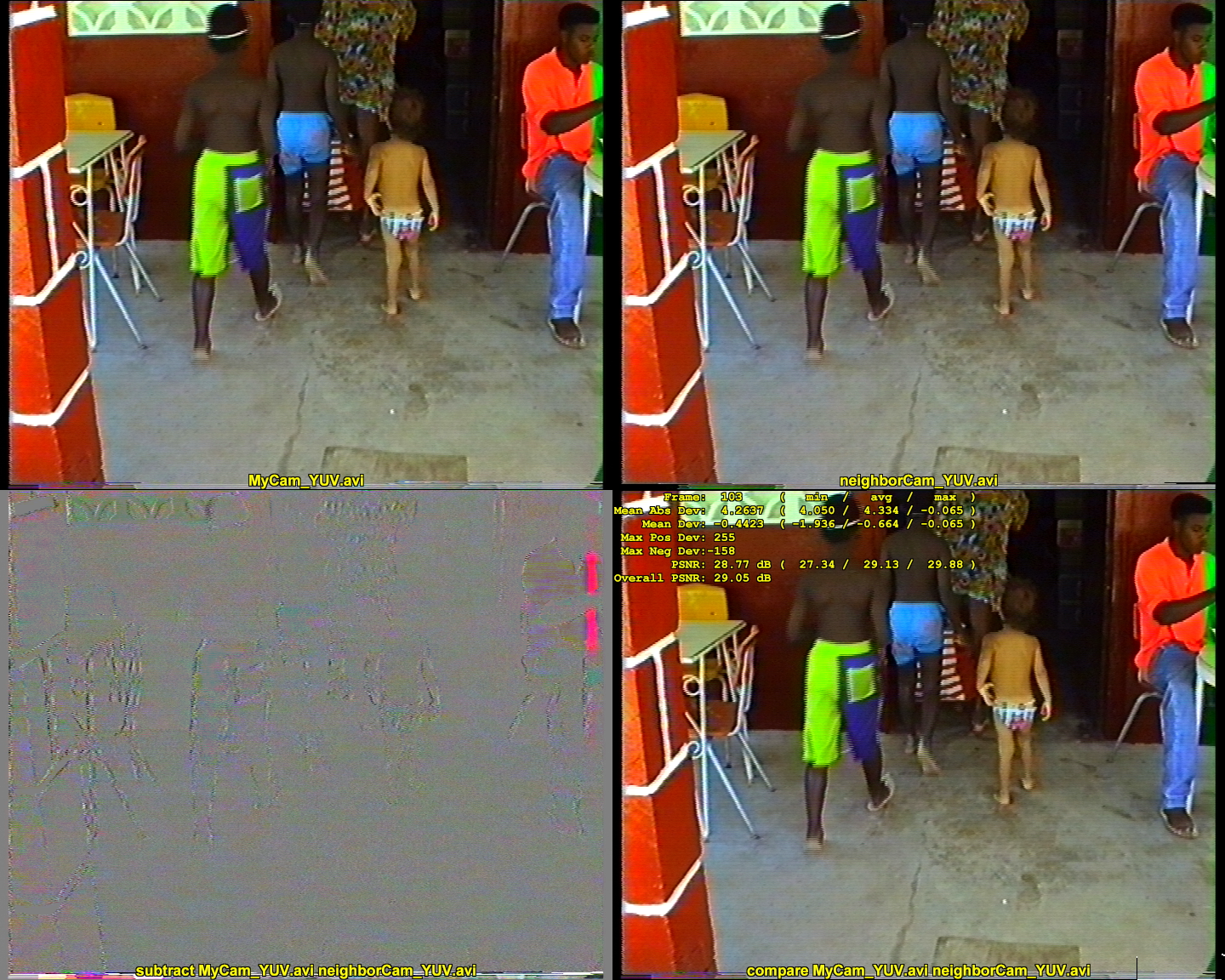

    They are close but not identical: comp.mp4
    [Attachment 72046 - Click to enlarge]

    They are close but not identical Image
    [Attachment 72045 - Click to enlarge]
    This is some cool feature - substraction mode.
    Well, I assume it's not worth capturing with the neighbor's cam without any audio and then having to copy the audio track from the 2008 DV source and trying to make it sync. I'll concentrate on my own cam, I think.

  24. Originally Posted by Marvolo View Post
    .....BUT I can barely see a difference between the neigbor's cam and mine, do you? They seem to be nearly or fully identical to me --> see attached AVIs.
    Nearly identical, yes, but nitpicking: Your neighbour's has slightly brighter brights (checked with the waveform histogram) which results in a very minor loss of details/gradients for the highly saturated colors.

    That's a bit strange to me. My NTSC DMR-ES25 also auto-negotiates YCbCr or RGB depending on the capability of the other links in the chain. But it at least has an option to toggle between RGB "standard" vs "enhanced" (i.e. limited vs full range).
    The handy thing about this is that when HDMI RGB Output Range is greyed-out, I know it's sending YCbCr.
