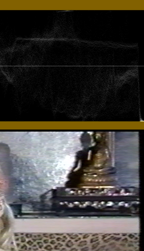

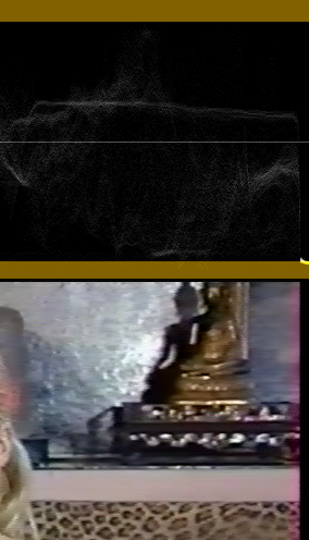

  16. Are you really capturing with that tiny frame size? You really should be capturing at 720x576.
    "01.no pana.avi" has those bright peaks crushed already just below Y=235.
    [Attachment 59316 - Click to enlarge]
    "02.pana.avi" should be adjust with about:
    AviSource("02.pana.avi")
    SmoothTweak(contrast=1.17, brightness=-4, saturation=1.17)
    TurnRight().Histogram().TurnLeft()
    [Attachment 59318 - Click to enlarge]
    You can see that the bright peak isn't crushed flat here, unlike the first image. But that's just one shot. These adjustments may not be appropriate for other shots. And you should adjust the capture device's video proc amp to capture with overall levels closer to this in the first place. By overall I mean not all shots will have full black and full white. But you want your darkest large black areas to be about Y=16, and the brightest large whites areas around Y=235. Ignore small overshoots.

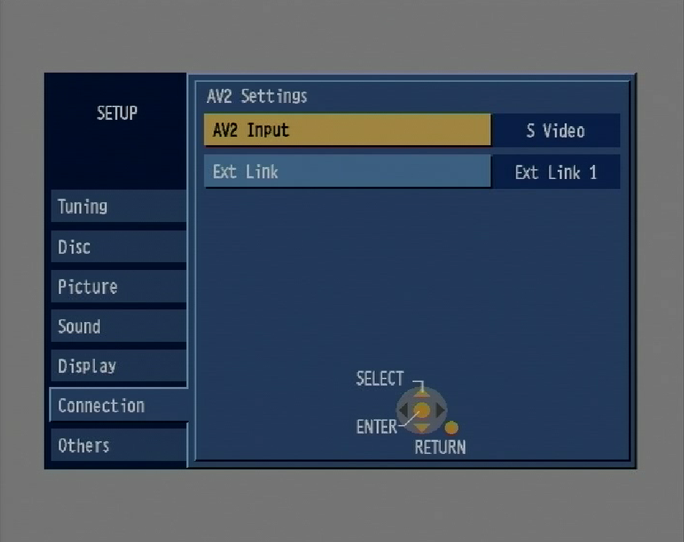

  23. Here's the ES10 settings. Am I right ?

    No I can't set the ES10 to SECAM : it's PAL or NTSC.
    I set the VCR in SECAM, I don't use the "SECAM to PAL" function.
    About "AV-in NR", I don't see it. I attached a picture of this menu, it's all grey.

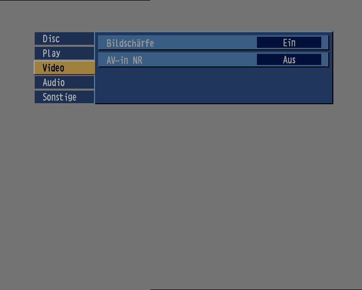

  28. Member Skiller's Avatar
    Oct 2013
    Germany
    Is AV-in NR not located in the Video/Picture tab for you?
    It looks like this on my DMR-EH 575 (sorry it's German):
    [Attachment 59354 - Click to enlarge]
    Edit: OK, I just realized you probably cannot access the upper tabs in this menu.
    Try what happens if there is a signal in the background, or try playing a DVD, that might unlock it.
