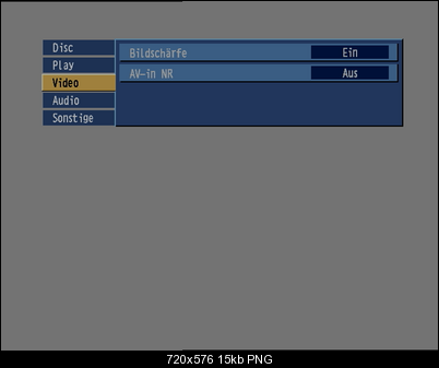

    Although I'm not 100% sure the menu structure of the E50 is the same, it usually works this way:
    When nothing is on the screen press the DISPLAY button on the remote. Scroll down to "Video" and there you go.
    Screenshot is from my DMR-EH575.
    The first setting is the comb filter for Composite input and the second one is the noise reduction.

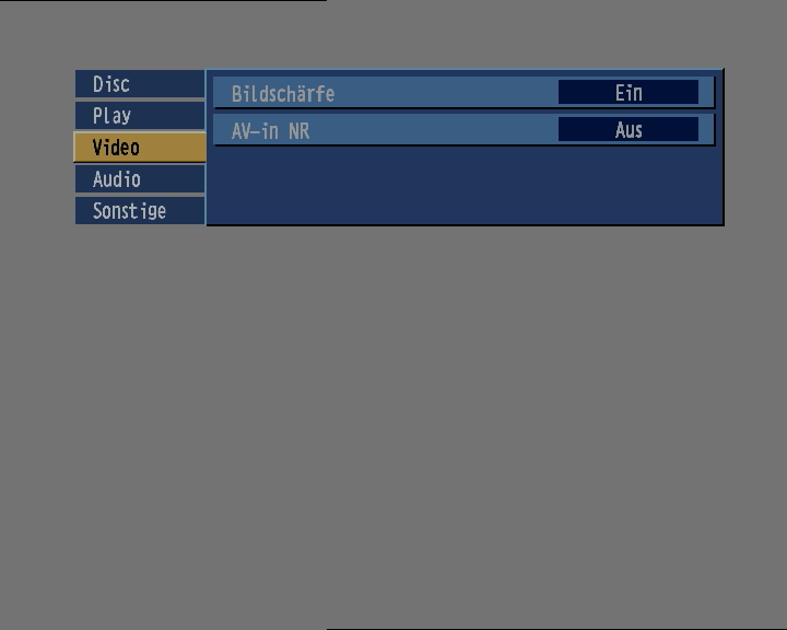

  6. Right i've found the dnr option it's for dvd playback only (kinda odd)
    I did comparisons with old caps captured with my capture card directly, this dvd recorder don't have a dnr by default (which is cool actually); for the tbc in action you can see it here
    (tbc'd image is sharper because of sharpening applied later)
