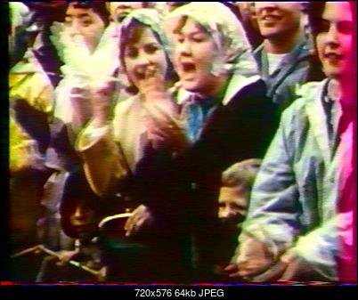

  1. Hi everybody,
    I live France (hooray to Secam stupidity!)
    I use a JVC HR-S9850 with ADVC110. Software : Virtualdub
    Main problem with Secam is the red/purple mark on the right of tape.
    Commercial vhs or tv recording, same problem.
    JFK documentary (Secam)
    How can I "delete" that ? I don't know how to use avisynth.
    There's a way to do it with a filter on Virtualdub ?
    Thank you all

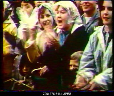

  6. Upload a color frame that has the same problem. Even better, a short video clip. If your video is DV AVI you can use VirtualDub in Direct Stream Copy mode to trim out a short sample with no reencoding.
    Using your sample image and a minor adjustment:
    ImageSource("jfk.png", start=0, end=23, fps=23.976)
    ConvertToYUY2(interlaced=true)
    U = UtoY() # separate U channel
    V = VtoY() # seprate V channel
    V = Crop(V,0,0,-24,-0) #remove discolore portion and black border
    extra=FlipHorizontal(V).Crop(0,0,16,-0) # the last 20 pixels of the V channel reflected
    V=StackHorizontal(V,extra).AddBorders(0,0,8,0,$808080) # add the extra, pad to 720 with grey
    YtoUV(U, V, last) # mix the separate U and V with the original Y

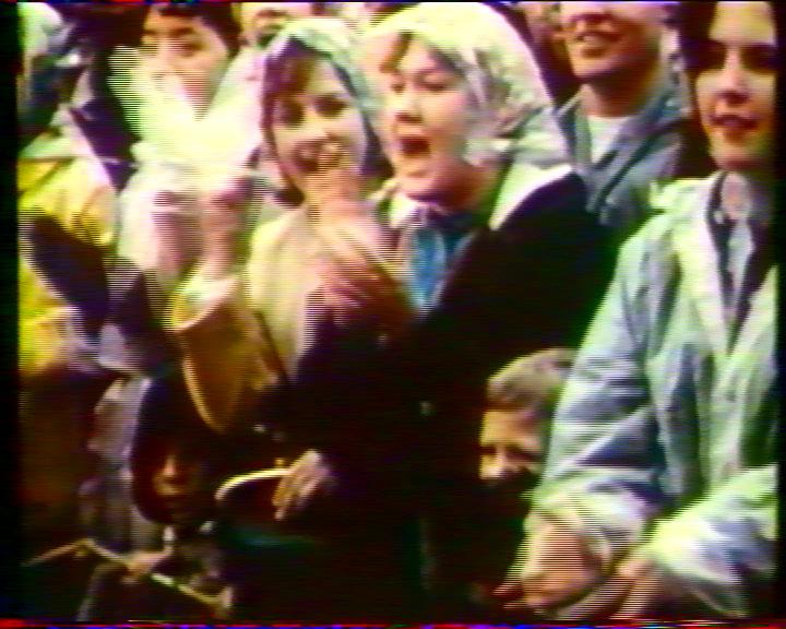

  8. I tried, like a blind guy to change two things : V=Crop and extra
    AVISource("jfk05.avi")
    extra=FlipHorizontal(V).Crop(0,0,20,-0) # the last 12 pixels of the V channel reflected
    V=StackHorizontal(V,extra).AddBorders(0,0,4,0,$808080) # add the extra, pad to 720 with grey
    With your code :
    Before
    Mine :
    After
    First problem of the filter, how can you deal when there's a red element on the right ?
    See, the grey area is visible. Can we reduce it or make it invisible ?

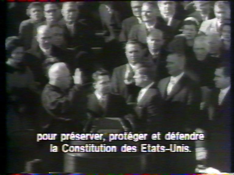

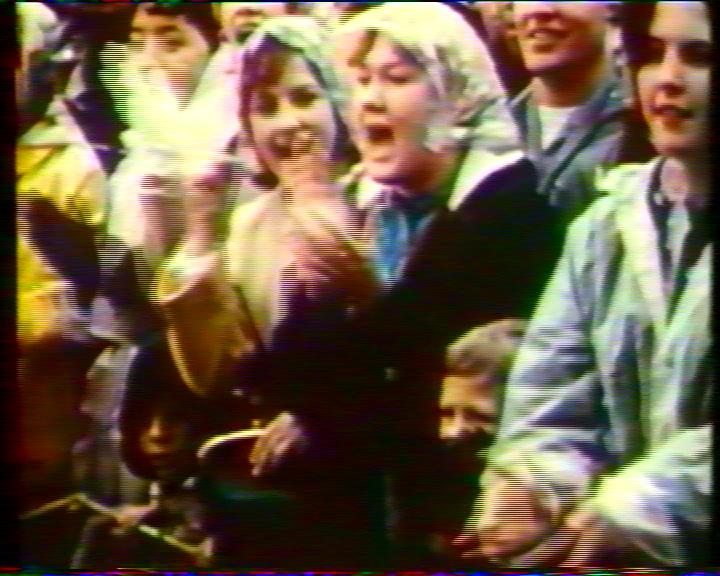

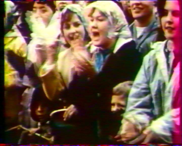

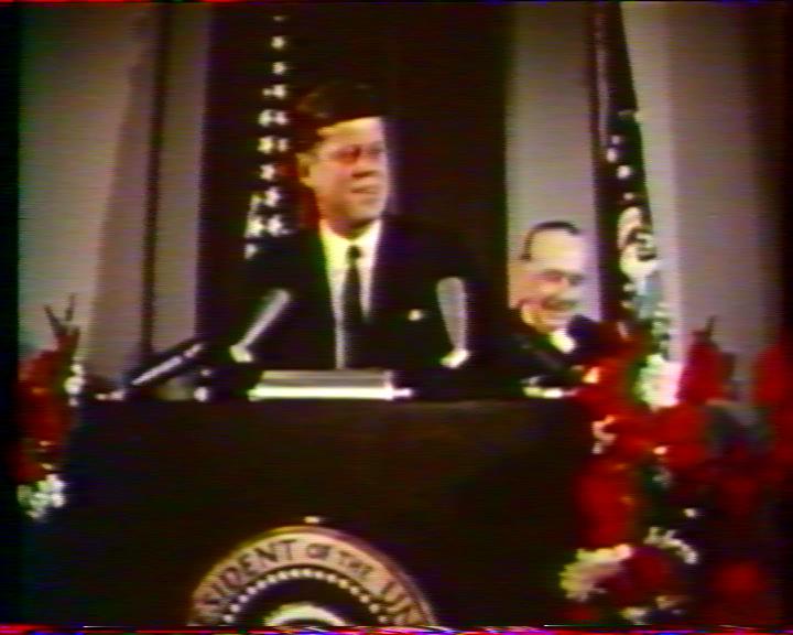

  9. One thing you should know about AviSynth: when you don't specify a clip by name the name "last" is used instead. So "AviSource("filename.avi")" is equivalent to "last = AviSource("filename.avi")". And many functions take an input clip and produce and output clip: "ColorYUV(cont_y=400)" is the same as "last = ColorYUV(last, cont_y=400)". And for our purposes here, the input video can be piped the the filter like "last = cropped.FlipHorizontal()" or specified within the filter with "last = FlipHorizontal(cropped)".
    There's not a lot of color in that clip so I'm going to crank up the saturation to make it more visible.
    Frame 1935:

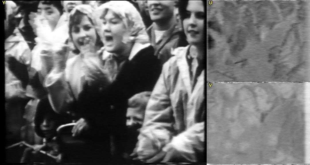

    Looking at the Y, U, and V channels separately (all as greyscale):
    PAL DVD use 4:2:0 chroma subsampling so the U and V channels are half the width and height of the Y channel. You can see that the Y channel doesn't have a problem at the right edge, the U channel has a minor rise, and the V channel has a major rise. To make this simpler we'll fix both U and V.
    The AviSynth script:
    # the width of the discolored right edge -- in Y pixels
    EDGE_SIZE = 48
    AviSource("jfk05.avi")
    ColorYUV(cont_u=400, cont_v=400) # bump up saturation, about 2.5x
    cropped = Crop(0,0,-EDGE_SIZE,-0)
    extra = cropped.FlipHorizontal().Crop(0,0,EDGE_SIZE,-0)
    chroma = StackHorizontal(cropped, extra)
    MergeChroma(last, chroma)
    First we define a constant called EDGE_SIZE that's the width of the discolored portion of the frmae -- 48 pixels of the 720 pixel wide image. Then we load the video with AVISource(). We cut EDGE_SIZE pixels off the right edge of the frame. We now have a video called "cropped" that has the discolored portion removed. We flip that video horizontally (mirror image) and then crop an EDGE_SIZE strip from the left edge, callled "extra" -- this is a mirror image of the right edge of "cropped". We add "extra" to the right edge of "cropped", restoring the original 720 pixels, and call it chroma. We only want to take the colors from this new video, so we merge the colors of the new video with the luma of the original video.
    This works well for this particular shot but will have problems with other shots. For example in this shot:
    It looks like there are more red flowers at the right edge of the frame.
