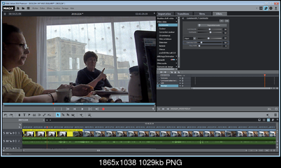

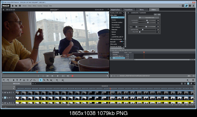

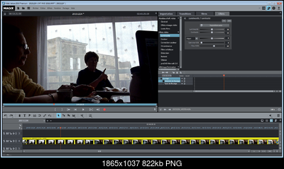

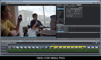

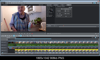

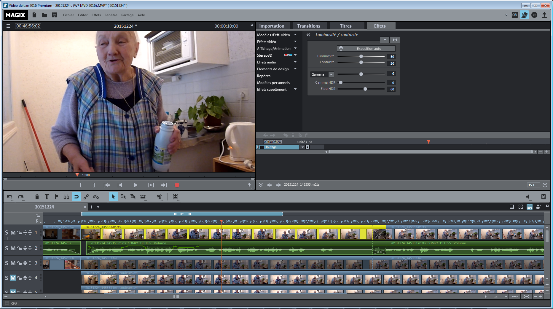

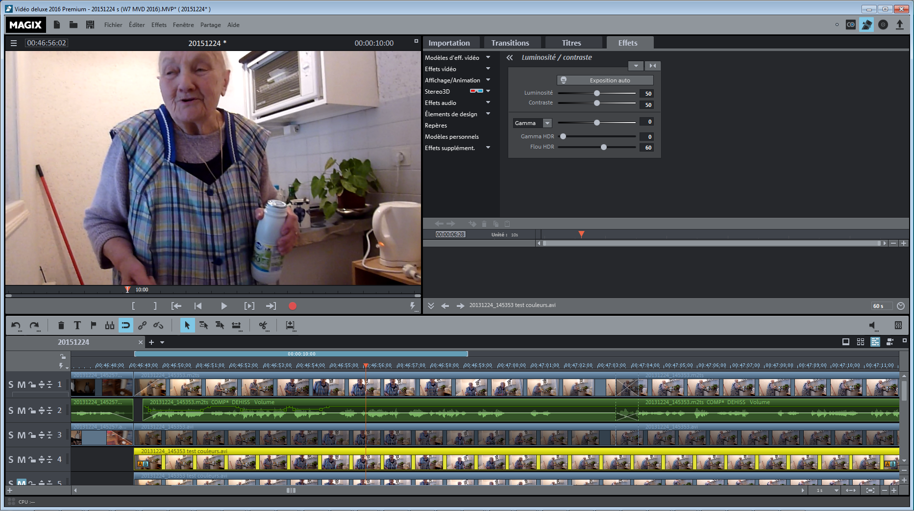

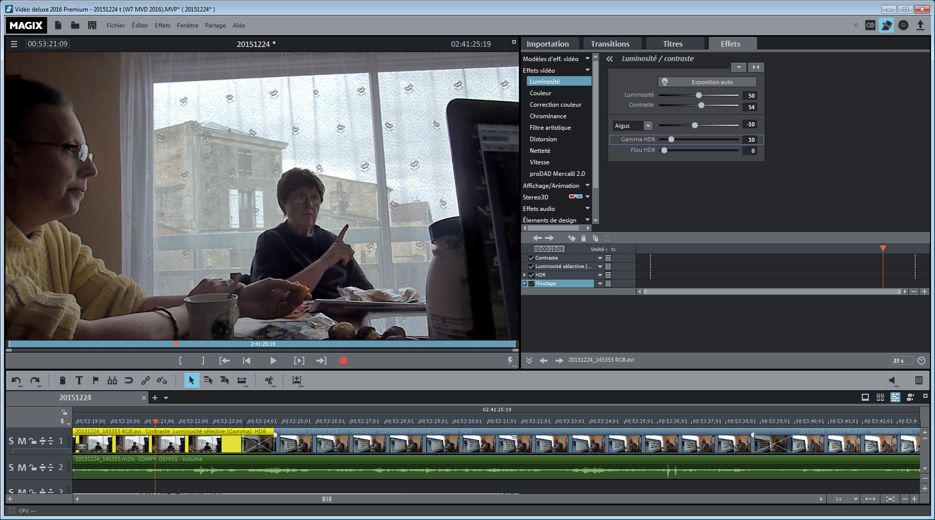

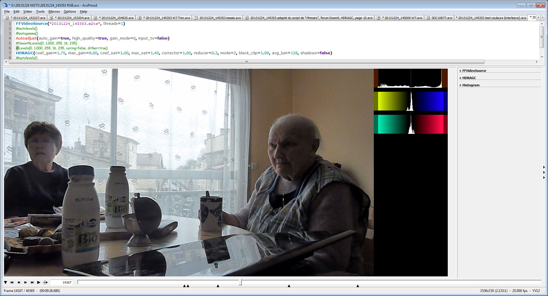

  1. This is driving me nuts... I made a movie from M2TS source videos in Magix Video Deluxe 2016 (I've already spent way too much time fiddling with every detail and countless unexpected issues and I want to finish this ASAP). I had to pre-filter some sections with Avisynth, but when I imported them into the editor, the colors were slightly off, no matter what I tried it didn't come out right. It would seem that something is wrong with the colorspace conversion matrix at some point, if I get this correctly.
    I made a bunch of tests using a basic AVS script with no treatment :
    – importing the files as virtual files with Avisynth Virtual File System
    – importing AVI files created with VirtualDub in "fast recompress" mode, using MagicYUV, Lagarith, UT Video, with various parameters for each, or uncompressed YUV...
    ...to no avail.
    What am I missing ?
    Wait... it seems to produce a visually indistinguishable preview if I add a "CompressToRGB(matrix="Rec709")" line to the Avisynth script, then export it with Lagarith in RGB. How come the editor doesn't use the same conversion method, even though the M2TS and AVI files are supposed to have the exact same content ? Or is it something else ? Is this the only way I can make this right ?
    I've read this thread, where it's said that Sony Vegas treats different types of source files differently – could it be the same issue here ?

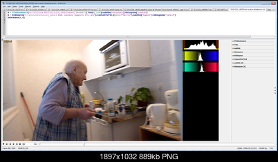

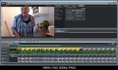

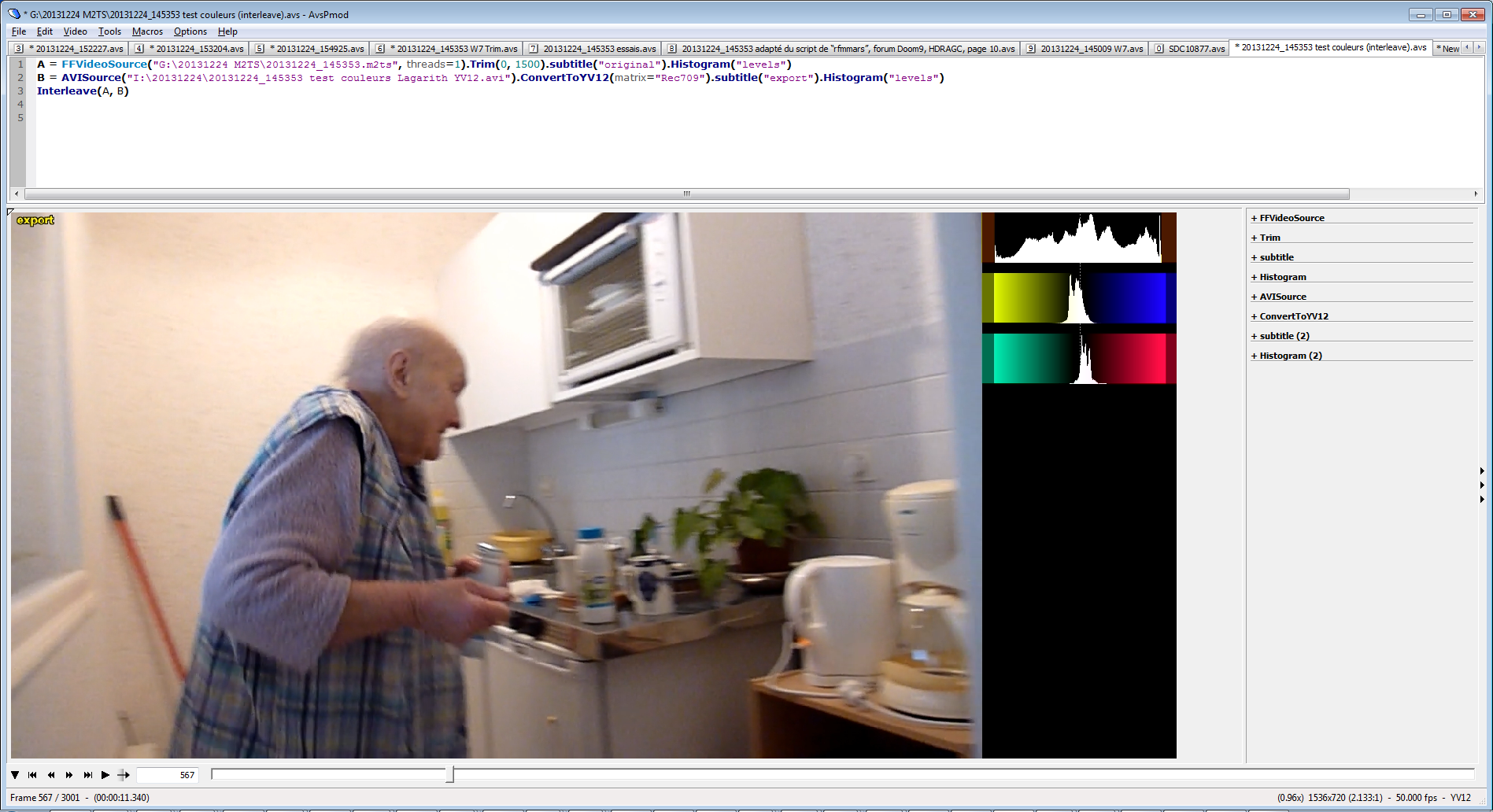

    Another thing that's bugging me : if I import a M2TS file in MVD, and export it right away as lossless AVI with no treatment whatsoever, then if I compare the source and the output with this script :
    A = FFVideoSource("source", threads=1).subtitle("original").Histogram("levels" )
    B = AVISource("output").ConvertToYV12(matrix="Rec709") .subtitle("export").Histogram("levels")
    Interleave(A, B)
    ... I can see that it looks the same, but the histogram gets clamped to 16-235 with the AVI file, even though the levels from the source file extend below 16 and beyond 235. Shouldn't it keep the levels as they are, unless instructed otherwise ? Again, refering to the thread mentioned above, it's said that in Vegas, "native camera files get studio RGB treatment", but, if I get this correctly, this is not the case here, right ? Or am I completely confused about these notions ?
Name:	histogramme AVI (Lagarith YV12).png

  2. Yes it' s the same issue
    Your editor is converting the YUV intermediate to RGB with Rec601 . That's also the reason for clipping - it doesn't treat those AVI codecs as YUV , it treats them as RGB and uses a standard range Rec601 conversion
    If you "undo" the conversion in the AVI screenshot by going back to YUV with 601, then back to RGB with 709, you get the same colors as the native camera files. Combined with the observation that if you convert to RGB using 709 and use a RGB intermediate, that it looks correct confirms that is what is going on.
    One format that usually gets pass through as YUV in Windows editors is UYVY (a specific uncompressed 8bit 422 configuration) . But the filesizes are huge because it's uncompressed.
    For the export clamping - Did you try another format - for example does it occur on say a h264/AVC MP4 export ? Maybe there are other conversions behind the scenes going on
    This is not as bad as "clipping" which would mean the data is lost. The "clamping" is just squishing the data into legal range. Not as bad because you could expand the range if you wanted to afterwards. But it would be nice if they gave the user control over that
    Forget about "studio RGB". That only applies to vegas . No other program uses it
  3. Your editor is converting the YUV intermediate to RGB with Rec601 . That's also the reason for clipping - it doesn't treat those AVI codecs as YUV , it treats them as RGB and uses a standard range Rec601 conversion

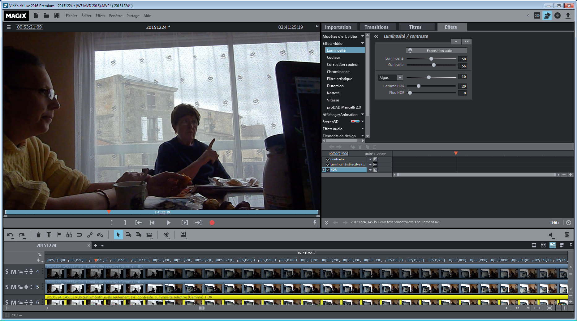

  4. Also : how can I export to UYVY with VirtualDub ? (Or anything that can read an Avisynth script and export to lossless AVI, not much else as far as I know, but maybe ffmpeg can do that right off the bat.)
    Another issue : at first I tried to import Avisynth scripts directly into MVD, through Avisynth Virtual File System, but (apart from the color shift) I got weird issues, like non reproductible sudden variations of luminosity, as if some frames were not treated and served as-is, then if I closed and re-opened MVD those particular frames could be fine but others were affected in the same way. The exported AVI files seem fine in that regard (I haven't checked thoroughly yet, though).
    The Avisynth script contains :
    FFVideoSource("20131224_145353.m2ts", threads=1)
    Autoadjust(auto_gain=true, high_quality=true, gain_mode=0, input_tv=false)
    HDRAGC(coef_gain=1.75, max_gain=6.00, coef_sat=1.00, max_sat=1.40, corrector=1.00, reducer=0.3, mode=2, black_clip=1.00, avg_lum=128, shadows=false)
    SMDegrain(thSAD=200)
    Even with my new machine based on an i7 6700K with 16GB or RAM, this proves to be too much for a fluid real-time playback (as a matter of fact the framerate for exporting those scripts to AVI files with VirtualDub is about 15fps), mainly I guess because of the denoising filter. Is it enough to explain that kind of issue ? Or is it a known problem that AVFS can't be trusted to provide a perfectly reliable replacement for lossless intermediate files ? Or could it be related to FFVideoSource having trouble with random frame access, as opposed to processing a video stream from start to finish ? Or is it the fact that some of those script calculate the effect on a given frame by averaging statistics from surrounding frames ?
    Can the fact that I don't have a dedicated graphic card – and thus rely on the CPU's integrated graphic chip – have any bearing on this ? And even if it does not, would there be a significant advantage in purchasing an entry-level discrete video card for video editing tasks ? (I don't play video games, don't do any 3D-related task, so I thought that I could get away with not having one, since even video editing is supposed to rely mainly on the CPU rather than the GPU.)
    Not sure, but it's probably related to "auto" adjust . Auto anything for color work is prone to those fluctuations. I suspect the AVI would have the same problems, look more closely. I doubt it's related to AVFS
    I doubt the variations are from the GPU.
    But discrete card will make difference on various tasks. It depends on which tasks , which software . Many operations in video editors are GPU accelerated these days, especially resizing, filtering. It can speed up workflow

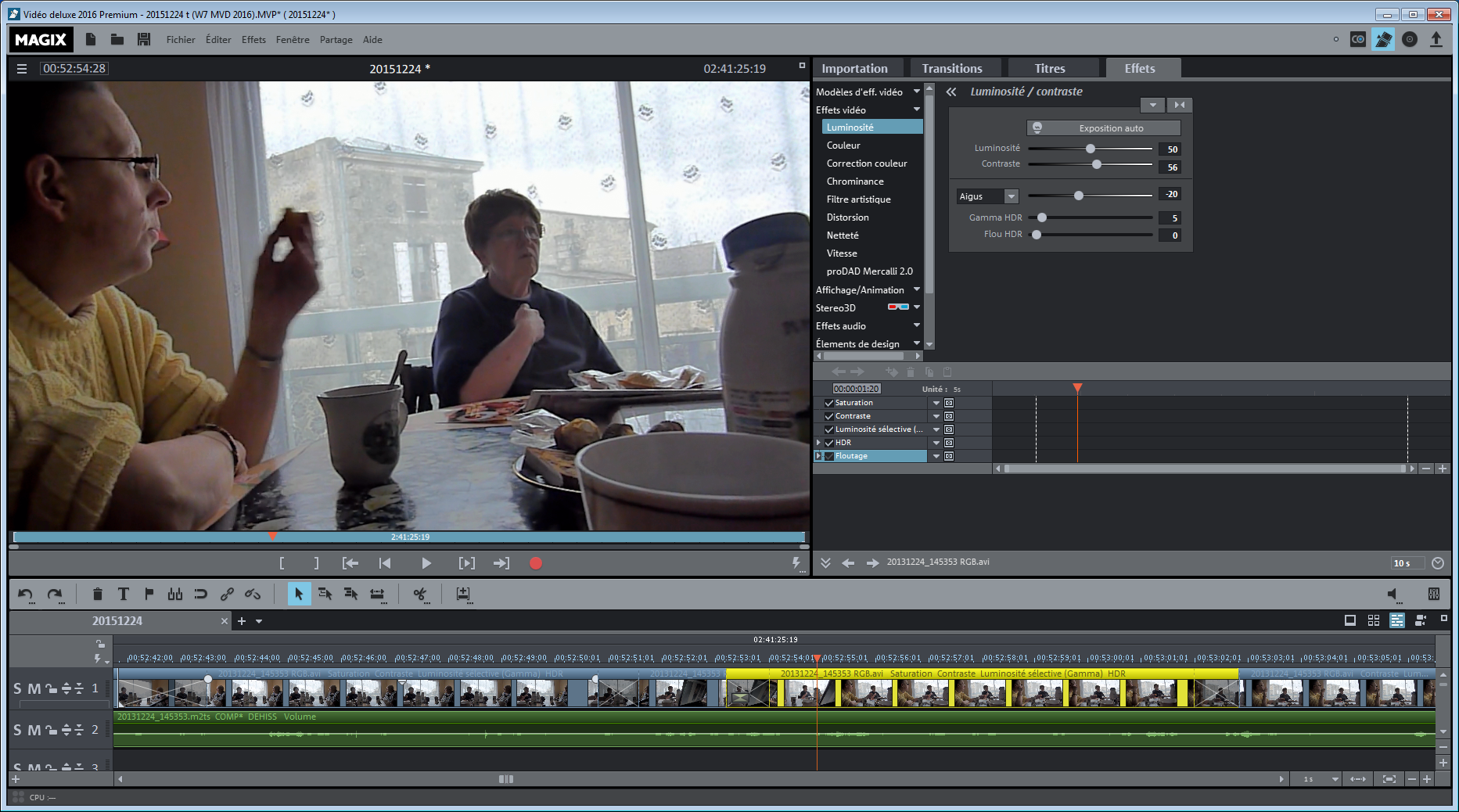

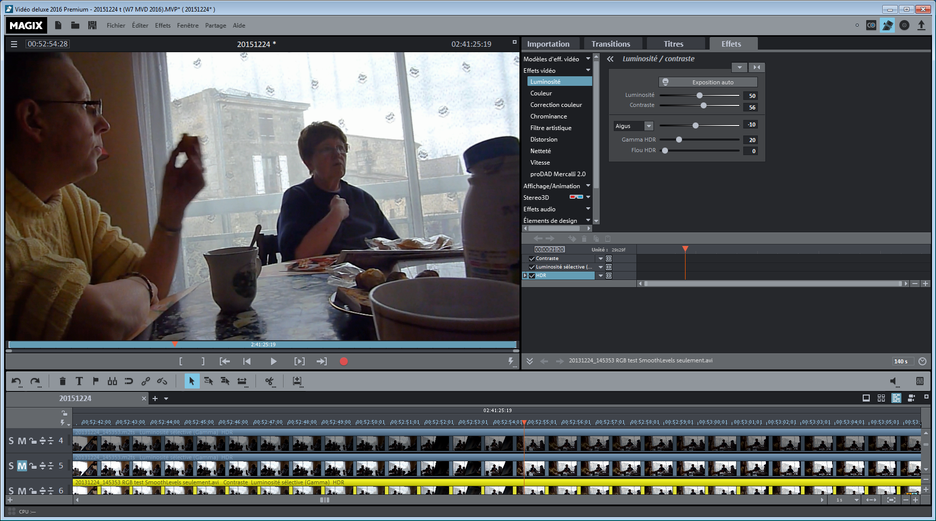

Name:	52.54.58 traitement Avisynth Autoadjust + HDRAGC, puis dans MVD contraste + réduction gamma tons.png
    AVS Autoadjust + HDRAGC, then MVD treatment including Gamma HDR (5)
Name:	52.54.58 traitement Avisynth Smoothlevels, puis dans MVD réduction gamma tons clairs, Gamma HDR .png
    AVS Smoothlevels “pc2tv”, then MVD treatment including Gamma HDR (20)
    => Here Magix's Gamma HDR used alone seems to better preserve the colors and overall “crispness” of the picture than in conjunction with HDRAGC.
Name:	53.21.09 [AVS] Autoadjust + HDRAGC + [MVD] C, G tons clairs, Gamma HDR.png
    AVS Autoadjust + HDRAGC, then MVD treatment including Gamma HDR (10)
Name:	53.21.09 [AVS] Smoothlevels [MVD] C, G tons clairs, Gamma HDR (pour les zones très sombres la fo.png
    => But here Gamma HDR is not able to recover the shadows satisfyingly without generating an unnatural look.

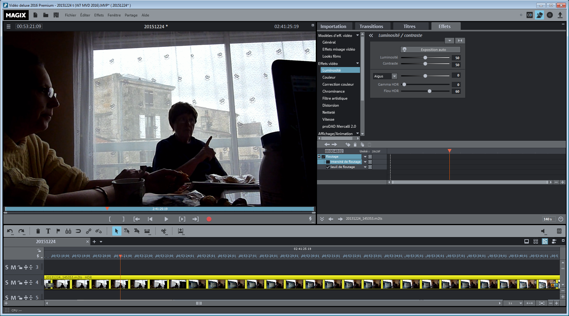

    The native footage looks like this, just for laughs (there are segments which are even worse than that) :
Name:	53.21.09 natif.png

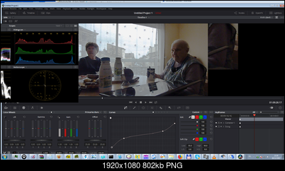

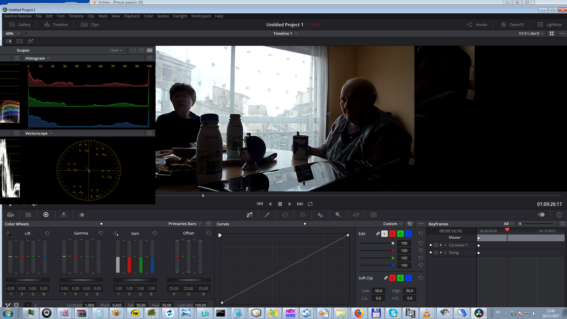

    So, I installed DaVinci Resolve, and I've been playing around yet again... that thing is impressive : even if the free version lacks some components, it seems already extremely capable as it is. But the interface isn't particularly intuitive, and feels kinda buggy (sometimes the video preview stops being updated for no reason, or it's the histogram, or the timecode gets scrambled, stuff like that).
    I tried to fiddle with the luma curve mainly : it's relatively easy to get a dramatic improvement very quickly, with the help of the histogram (that part at least is way more intuitive and practical than adjusting contrast or gamma values, without knowing exactly what it does and how those adjustments interact with eachother). Beyond that, indeed, it would require a lot of time just to get acquainted with the notions you mentioned, I've spent way too much on this already. And there are some frustrating aspects : export formats are limited in AVI (only Cineform and uncompressed are available, can't use the lossless encoders installed on the system – otherwise there's a tremendously rich choice of uncompressed formats in 10bits+, of no use here), exporting to MP4 / H.264 gives an error with no explanation (“Recording failed with error : failed to encode video frame”), and apparently the only available framerates are 23.976, 24, and “30 (3:2)”, while my footage is 25fps and the finished movie will be 29.970 (because the first half was shot at that rate – I was advised to export in 59.94 for a smoother playback of the 25fps part, but I don't have this option in MVD). I still tried to export the longest of those videos (26m54s) to uncompressed 8bit, after a quick-and-dirty treatment based on a single frame which I thought would be representative of the worst-looking parts, I got a 70GB file (MediaInfo recognizes it as “HDYC”), with muted audio (don't know why, the audio is silent within the timeline too), but a correct 25fps framerate (when choosing “Individual clips” rather than “Single clip” the framerate option disappears so it probably keeps the native value). I also tried exporting in MOV / MPEG4 Video, with “Best” quality setting : it works, but the output has a constant bitrate around 5000kbps, less than the native files (~8000kbps), it's probably not enough to produce a visually transparent output. Then, checking the whole video, some parts are better looking than their HDRAGC counterparts, better colors, more natural contrast it would seem, others are worse – but it's possibly because I let the “Data levels” option to “Auto”, and apparently the export was made in full range (for the MOV export I chose “Video” and it looks better). I think that I'm going to export those roughly treated files, and mix them with the Avisynth-treated ones, by checking them both section by section and keeping what looks best.
    But that YUV 4:2:2 format is not recognized by MVD, oh well, one more SNAFU... How can I export a clip treated by Resolve into a format recognized by MVD ? Or do I have to convert it yet again to RGB ? In this particular case, is the YUV 4:2:0 to YUV 4:2:2 conversion a lossless one, or does it add yet another lossy layer ? Also, there's quite conspicuous banding on the exported footage, is it normal after such a treatment, and can it be corrected / mitigated somehow ? (Levels and Smoothlevels in Avisynth have “dithering” to counteract the banding.)
Name:	09.26.17 natif.png
    native frame
Name:	09.26.17 Resolve.png
    Resolve luma curve treatment

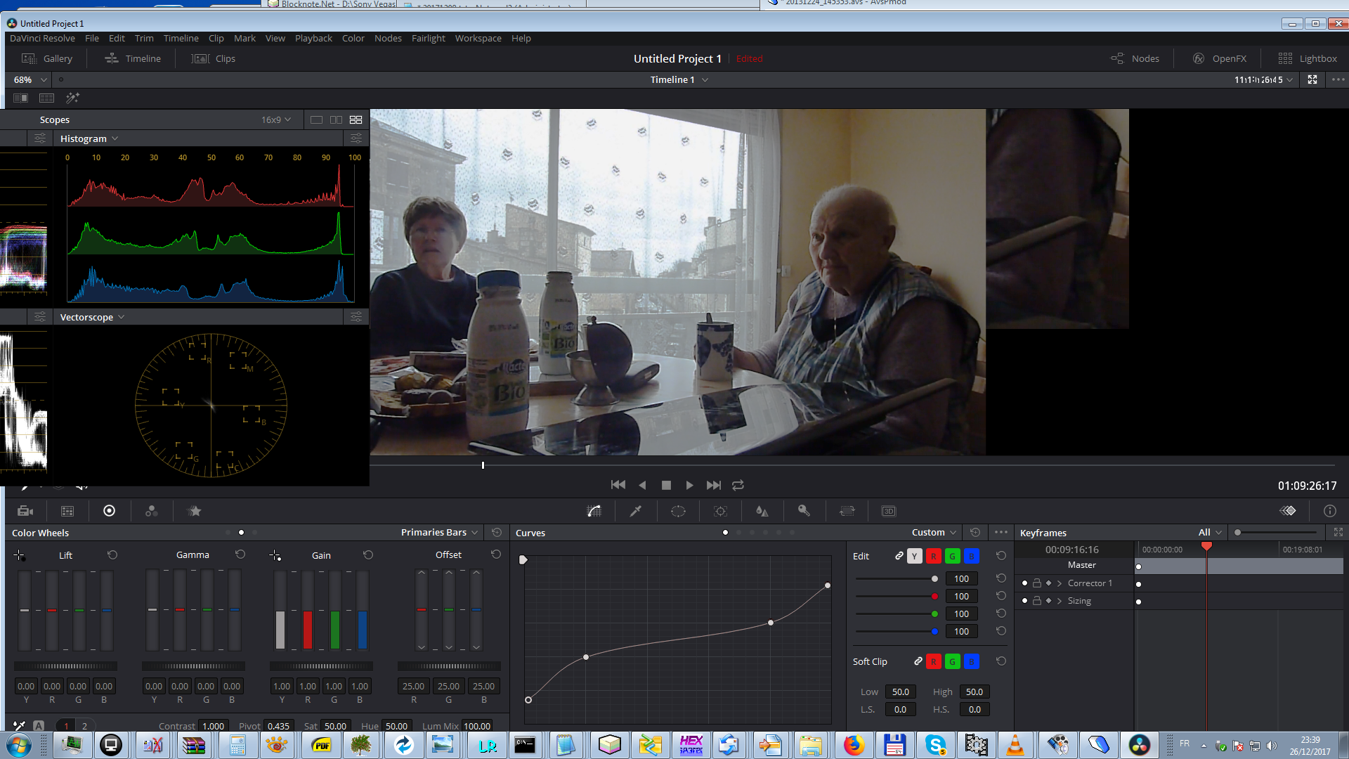

Name:	09.26.680 AutoAdjust + HDRAGC.png
    Avisynth treatment (Autoadjust + HDRAGC)
Name:	09.26.17 Resolve - cut.png
    Resolve treatment, just the preview panel
Name:	09.26.680 AutoAdjust + HDRAGC - cut, resize bi-linear 876x492.png
    Avisynth treatment, preview panel cut and resized to the same size as the Resolve one (couldn't get the full size fully displayed within the software)
    The treatment is very different, the Resolve one has more vivid colors, but otherwise feels dull and unnatural, faces are kinda waxy, reflections lack vibrancy, the walls lack shadows, I can't quite put my finger on what goes wrong technically, maybe the curve correction was too heavy-handed ; the Avisynth one has more contrast, more highlights in the window area but also more details, the colors are less vivid but probably more realistic. In fact it may not be worth the trouble to use the Resolve treatment as it is...

    Thank you again for the time and patience it takes to provide such thorough replies.

    For resolve - There are a gazillion tutorials for resolve on youtube. There are some for different experience levels and some complete series for beginners.
    There are different variations on workflow, some use physical files like prores, others use linking through xml/aaf/edl. I doubt your editor will be able to use any of the latter methods.

    Keep in mind "looks best" can be subjective - Bringing out the details in a backlit window is great, but keep in mind it can also detract from the main subject (I'm guessing it's the people in the shot)
    Certain things people will agree on 100% , such as don't clip overbrights etc.., but other things you can ask 10 people and get 10 differentanswers

    So, what is the prefered way of properly setting the levels to the valid range, in Avisynth or whatever else ?
    After the HDRAGC treatment some values are outside the 16-235 range on some frames, should I correct levels a second time after that filter ? (I tried and it looked worse, but I used the full range : I thought that black had to be 0 to look truly black.)
    There is no "preferred" way. There are many ways to "bake a cake" .
    For HDRAGC, use the shift parameter or level beforehand
