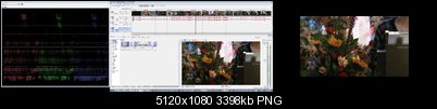

    I'll try to upload a screenshot of what I'm working on.
    Jan 2007
    Canada
    I hope this helps
    It shows the wide range of colors as well as how it looks on a secondary monitor. I think I looks pretty good.

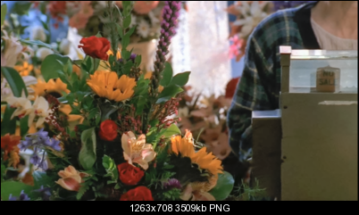

    My end result looks like the last image; both on my computer and on TV using x264 in an mkv.
  23. Originally Posted by ziggy1971 View Post
    It's a bit more complicated than that. You posted an RGB screenshot. The method of taking the screenshot matters, because there is a YUV=>RGB conversion .
    So the actual levels , colors, might not be what you think they are, because of different matrix, renderer, decoder
    eg. Chances are it's not, but.....It's possible that both your computer/gfx card and TV are calibrated in the same incorrect way . This actually occurs quite frequently . What you "see" might be different than what other people are seeing

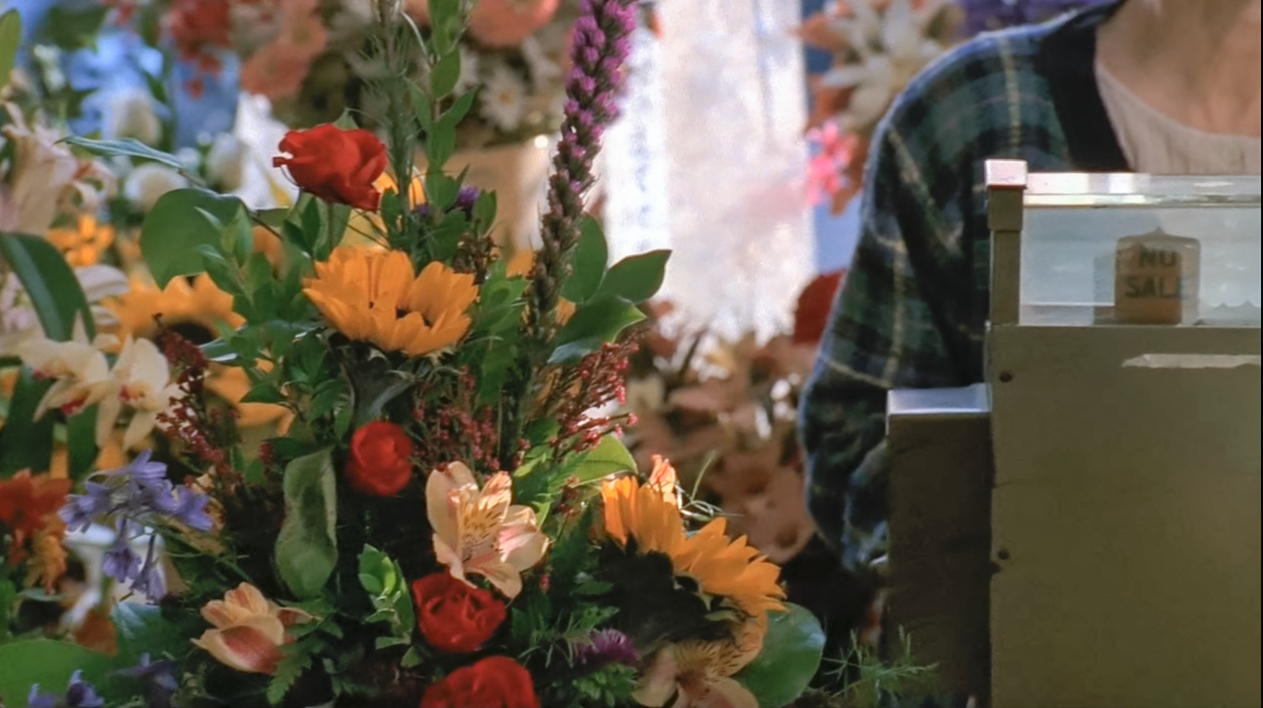

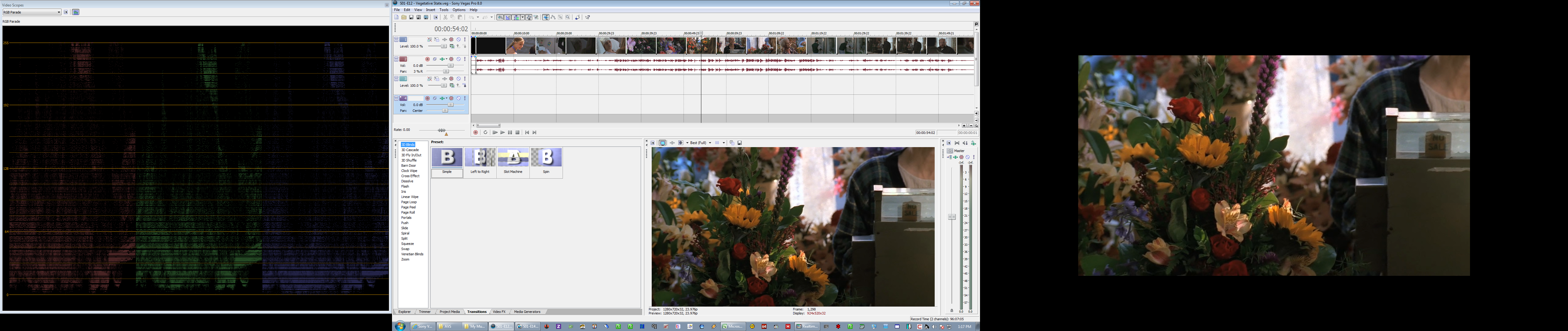

  25. Banned
    Oct 2014
    Northern California
    [Attachment 29006 - Click to enlarge]
    I hope this helps
    It seems to me your are throwing a lot of shadow away:

    Load them into avisynth , one way is avspmod, which has tabs that you can swap back & forth with the number keys
    AVISource("input.avi")
    Histogram()
    ConvertToRGB(matrix="rec709")
    FFVideoSource("output.mkv")
    Histogram()
    This way you control more variables and take things like the matrix used, renderer out of the equation. If you take screenshot with some video player, it might be using a different renderer for example
    If they match, and they "look" ok both to your eyes and the waveform, no clipping, then your current workflow is fine in terms of levels / colorspace issues
  28. Member
    Jan 2007
    Canada
    OK, I confess, I can see a problem there. Thanx for the script and explanation on what to look for.
    Now, this is the bad part.
    How do I fix this? Do I have to change it in Vegas and re-render? Or can this be fixed via Avisynth?
  29. Originally Posted by ziggy1971 View Post
    It depends on what the difference is or what the actual problem is
    There are still some "gotchas" and things "not controlled" in that mini test - for example the AVISource() should be using the cineform VFW decoder. But depending on how you have you system setup and the cineform settings setup it might be returning something else, not YUV 422
    At this point it might be appropriate to upload a sample of the input and corresponding sample of the output
