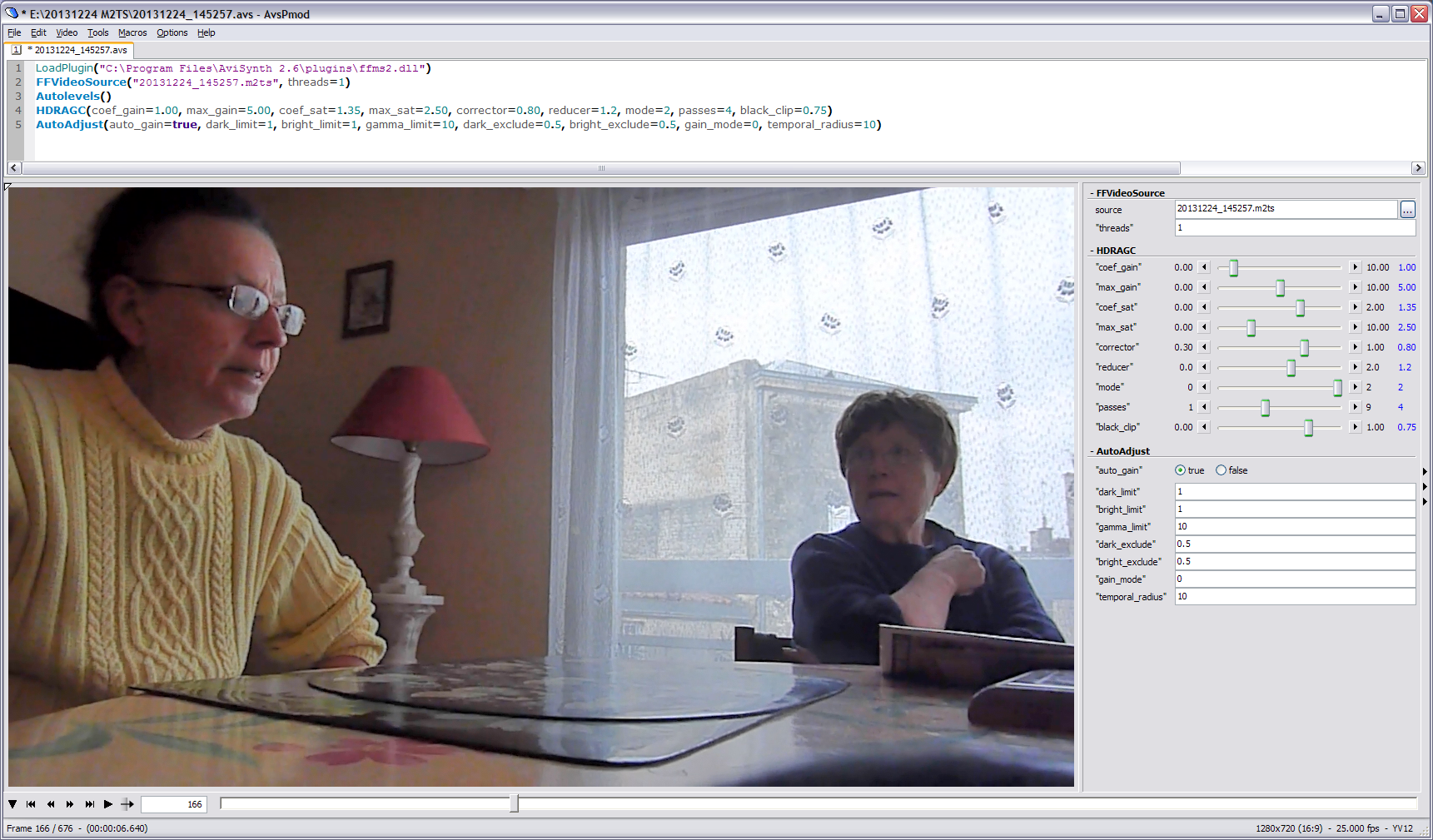

    I filmed most of this being sitted in front of a large window, with a compact camera which struggled to maintain a good and stable exposure. So it's mostly very dark (the interior, the people talking) because of the daylight coming from that window (almost burned highlights). And so I want to pre-filter those sequences to recover as much detail and color in the shadows as possible, without affecting the highlights (or even recover some detail in highlights too). So far I used variations of this script :
    LoadPlugin("C:\Program Files (x86)\AviSynth\plugins\ffms2.dll")
    FFVideoSource("20131224_145257.m2ts", threads=1)
    Autolevels()
    HDRAGC(coef_gain=2.25, max_gain=5.00, coef_sat=1.25, max_sat=1.75, corrector=0.80, reducer=1.2, mode=2, passes=4, black_clip=0.50)
    AutoAdjust(auto_gain=true, dark_limit=1, bright_limit=1, gamma_limit=10, dark_exclude=0.5, bright_exclude=0.5, gain_mode=0, temporal_radius=10)

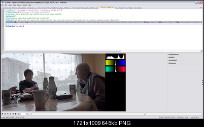

    ...to this (I tweaked the parameters since I made those screencaps, even though I'm not sure it fared better overall) :
Name:	201312241453 HDRAGC puis Autoadjust (meilleur contraste).png
    (HDRAGC then AutoAdjust)

    So, questions :
    - Can I do better than that ?
    - Are my parameters about correct with these plugins, and is their order logical, practical ? (For instance it seems like putting AutoAdjust after HDRAGC results in less enhancement in the shadows but a more natural contrast, see above.)
    - Are there other plugins worth testing in such a case ?
    - Is it unavoidable to lose picture quality / fine detail / sharpness when applying filters like HDRAGC / AutoAdjust ?
    In fact I later removed AutoAdust altogether (and increased the "coef_gain" value in HDRAGC to compensate), deciding that it would be good enough, that I would then tweak some more within the NLE software, with gamma/contrast applied with varying values to different zones (as it's very painstaking and frustrating to fiddle with this in AvsPMod -- one frame will be seemingly improved by some change but another segment will be way worse), and be done with it (before I had those other issues which prevented me from getting it over with) : in combination with the other two, AutoAdjust further lightens the dark areas, but at the expense of overall contrast and (it would seem) more fine details (clothes and skin textures for instance), while it also affects the highlights, making the whole picture lose crispness.
    Would you agree ? Would it be better with other parameters ?

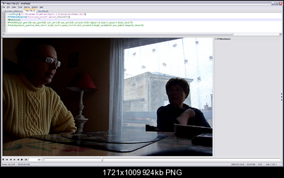

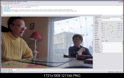

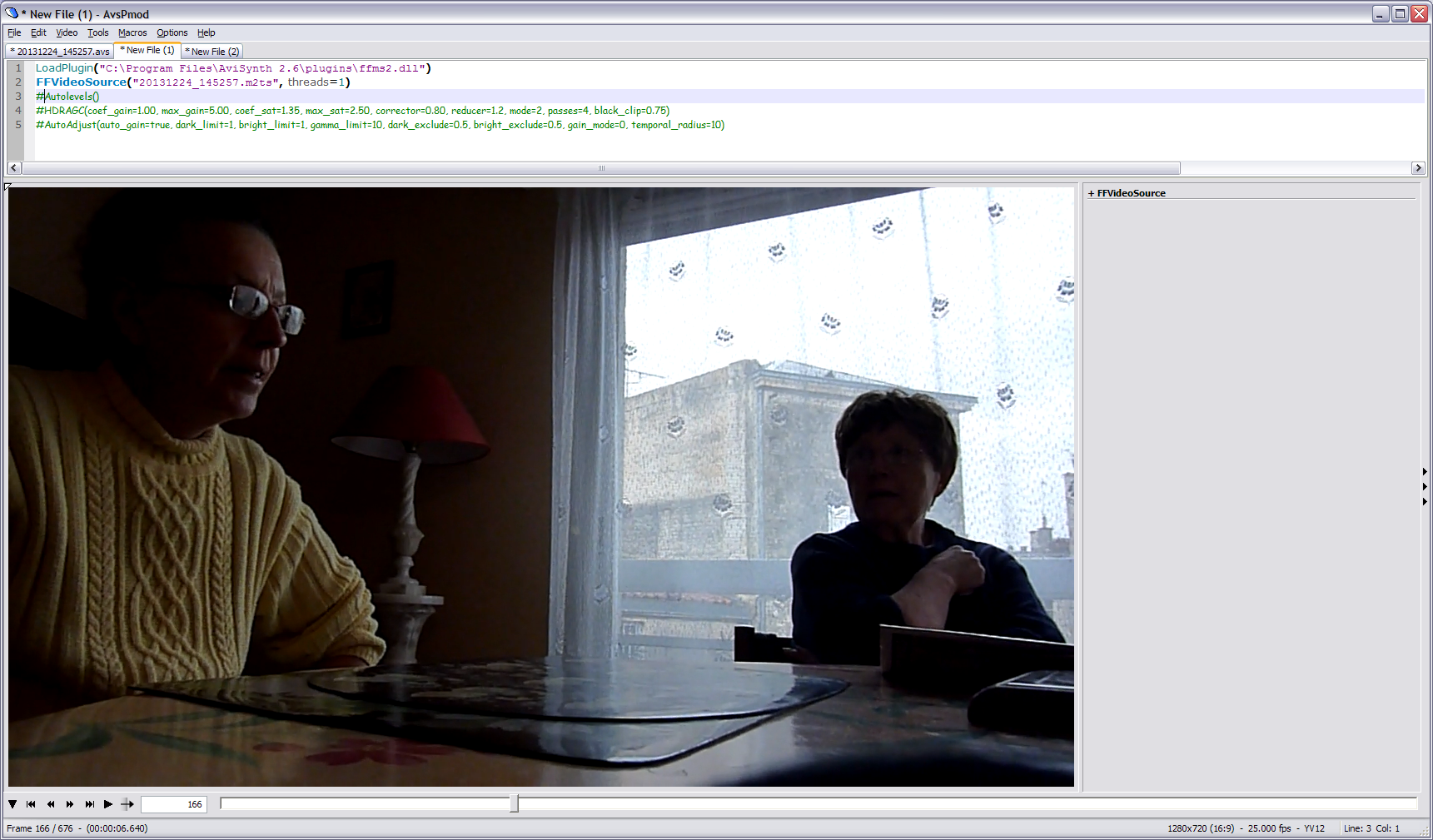

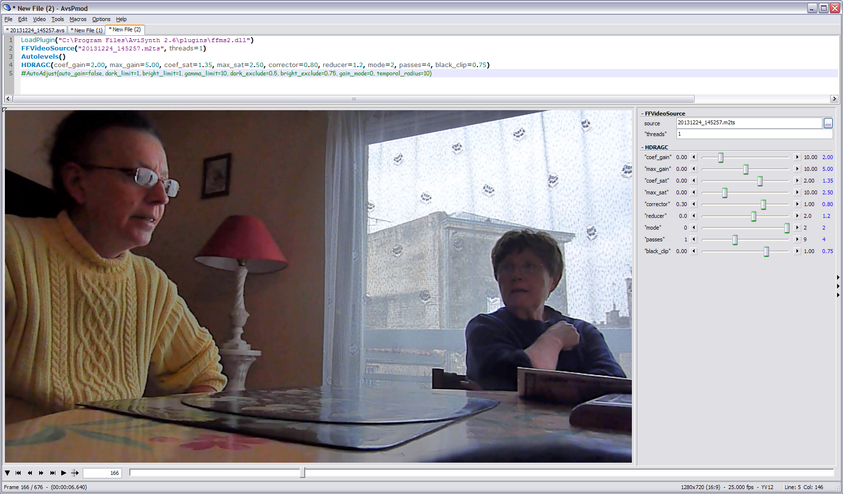

Name:	AvsPMod 20131224145257 1.png
    (Autolevels + HDRAGC + AutoAdjust)

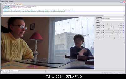

Name:	AvsPMod 20131224145257 2 (un peu plus sombre mais plus naturel).png
    (AutoLevels + HDRAGC)
Name:	AvsPMod 20131224145257 natif.png
    (unfiltered)

  4. First, it looks like you did a nice job -- so it's hard to know what else you expect.
    Second, speaking for myself, I would never try to do this in Avisynth. I would pull it into Resolve where there is more control and you can see what you are doing.

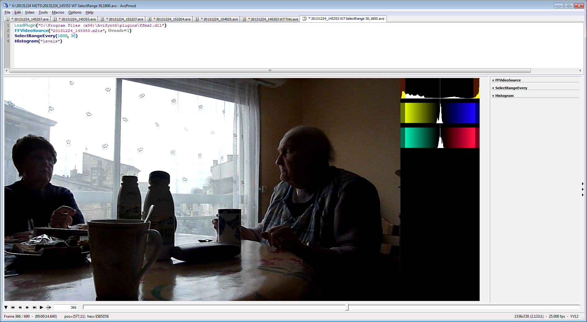

    In your sample video everything is clamped between Y=16 and 235 -- ie, superblack and superwhites have been crushed. I suspect that was caused by in your processing and your source has values outside that range that could be recovered.

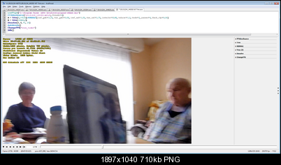

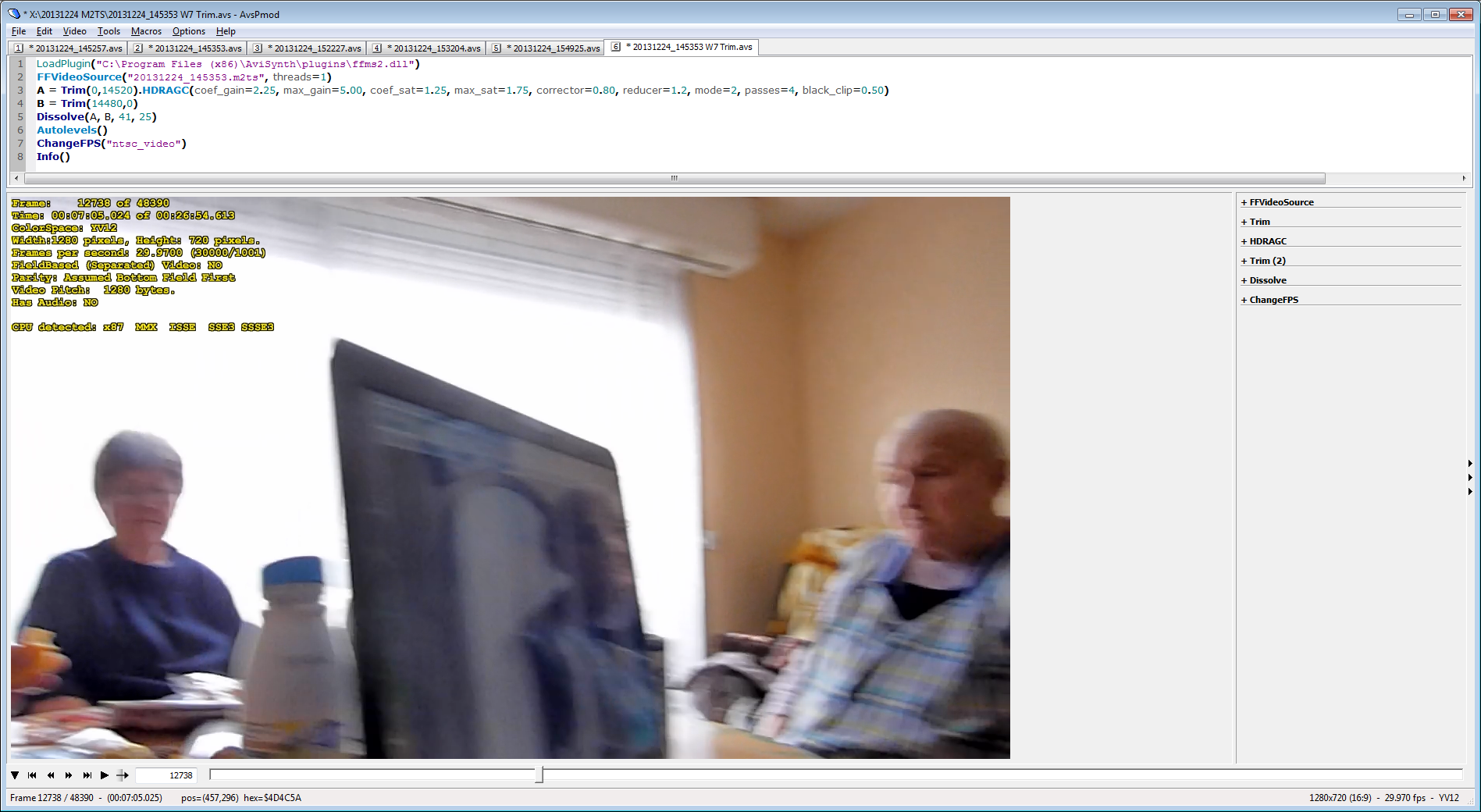

    ConvertFPS does that kind of things :
Name:	20131224_145353 ConvertFPS ntsc_video.png
    Maybe it's normal ? Maybe it's less ugly in motion ? I guess the framerate conversion methods you gave me (in this thread) were sorted from the most simple and least computer intensive to the most complex and most computer intensive (frame duplication > frame blending > frame interpolating).

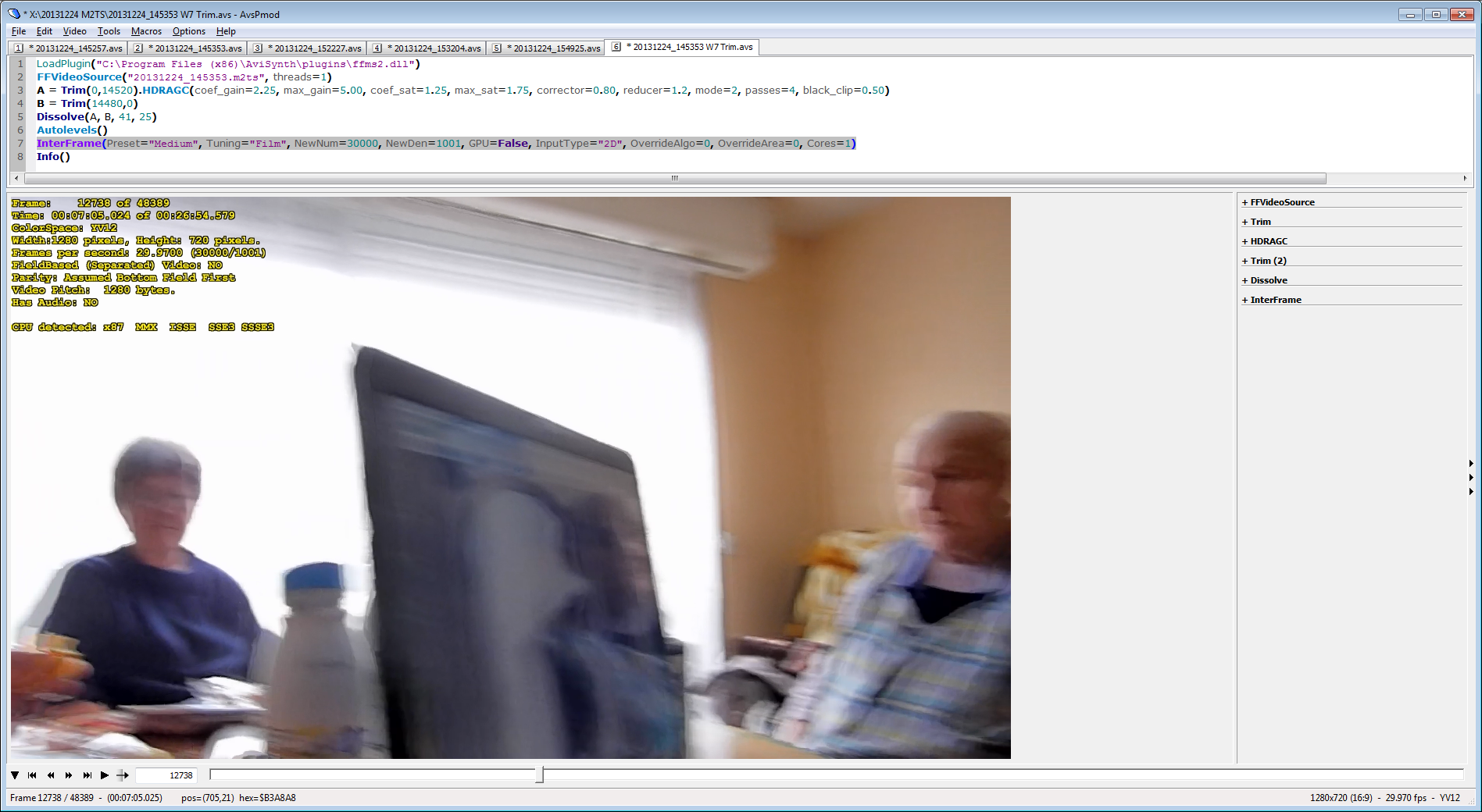

    In this thread (in french but with many comparison screencaps) Interframe is said to be significantly better than MFlowFPS which is « technically outdated » :
    http://letransfert.soforums.com/t618-L-interpolation-avec-Interframe-SVPFLOW-VS-MVTOOLS2.htm
    Interframe produces this :
Name:	20131224_145353 Interframe 30000,1001.png
    And ChangeFPS :
Name:	20131224_145353 ChangeFPS ntsc_video.png
    I didn't apply any processing for that sample. I just compressed it with VirtualDub. (By the way, I had to load it through AVFS : I can no longer load an AVS script into VirtualDub. Maybe that's because I installed ffdshow 64 bit ? VirtualDubMod tells me there are two missing DLLs, but works anyway, and it does load the AVS correctly. One more puzzling thing when I don't need any more...)
    FFVideoSource("20131224_145353.m2ts", threads=1)
    SelectRangeEvery(1800, 30)

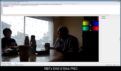

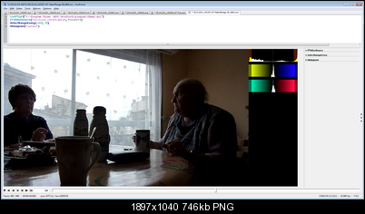

    And yet, as the screencaps in the first post show, I was able to recover details in the seemingly crushed blacks and seemingly burnt whites.
    ...but apparently you're right, I don't get it :
Name:	20131224_145353 FFVideoSource.png
Name:	20131224_145353 FFVideoSource + VirtualDub Xvid + AVISource.png
    The first one is the source loadad with FFVideoSource, the levels look normal (they extend toward both ends), the second one is that compressed sample loaded with AVISource, the levels appear to be crushed like you said, but the frame looks just the same... If I load the virtual AVI file the levels look like the first one (normal), so something happened at the compression stage. Maybe I should have selected Xvid HD 720, instead of the default Xvid Home ? -- No, doesn't change a thing. Same result with VirtualDubMod. Lagarith, same.
    Avidemux conversion of the virtual AVI file seems fine (except the first frame appears completely green in AVSPMod) :
    20131224_145353 W7 SelectRangeEvery 1800,30 Avidemux Xvid q4.avi
    So what was wrong in VirtualDub ? Maybe something in “Color depth” ? (“Decompression format” is set to “Autoselect” and “Output format to compressor/display” is set to 24 bit RGB.)
    Interframe is better with some video. It will usually produce blending rather than weird distortions in areas where it can't detect motion properly. But all motion interpolation techniques produce distortions to some extent. The professional versions allow you to control the process manually -- marking moving objects, etc.
    Because the program is displaying the YUV video as RGB with the same rec.601 matrix, crushing superblacks and superbrights, the same as VirtualDub.
