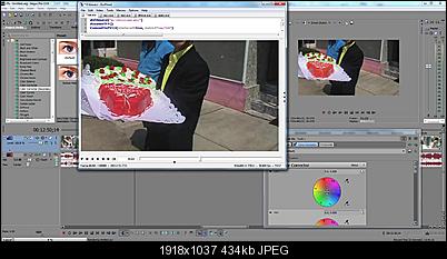

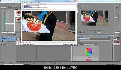

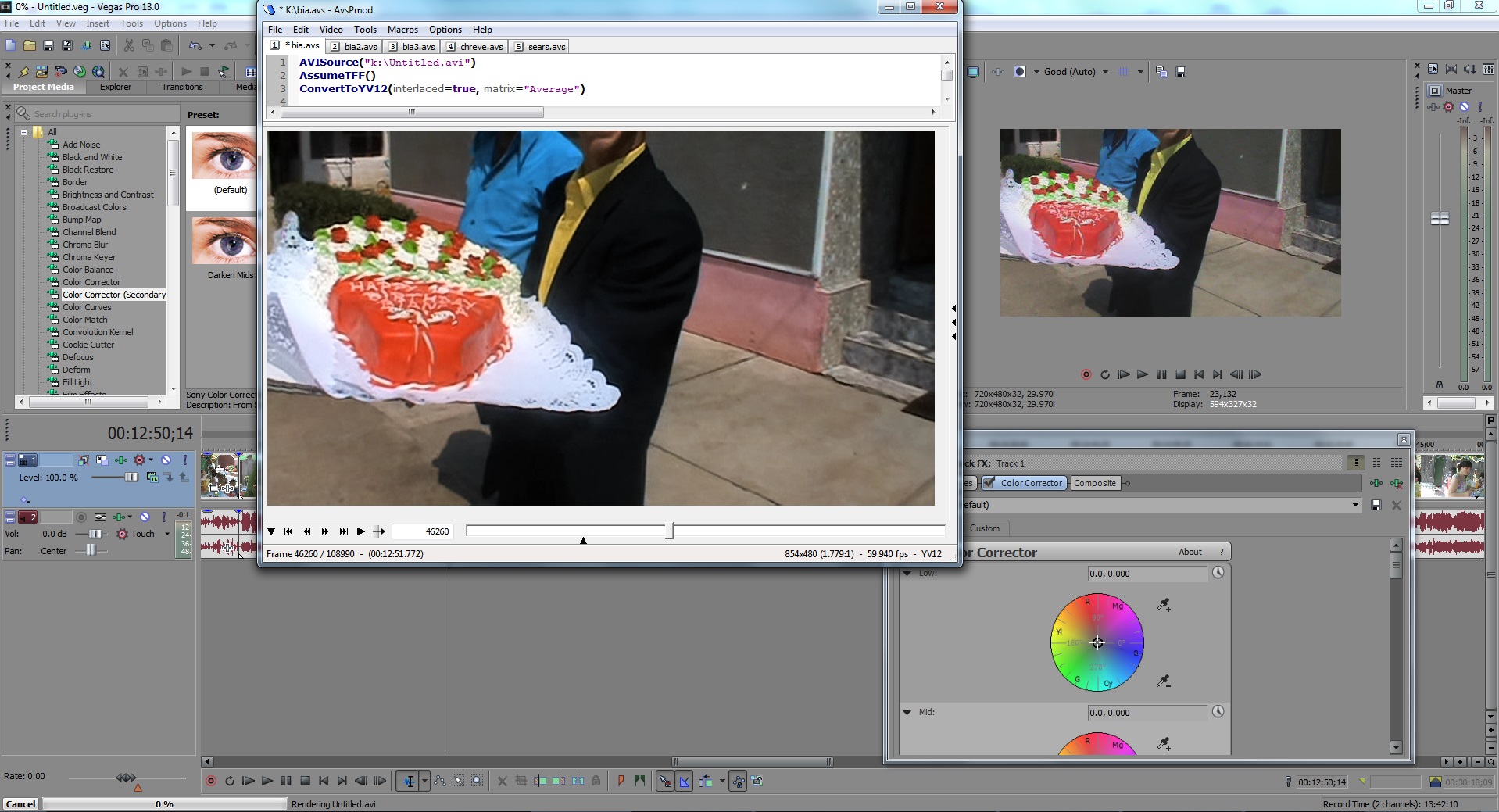

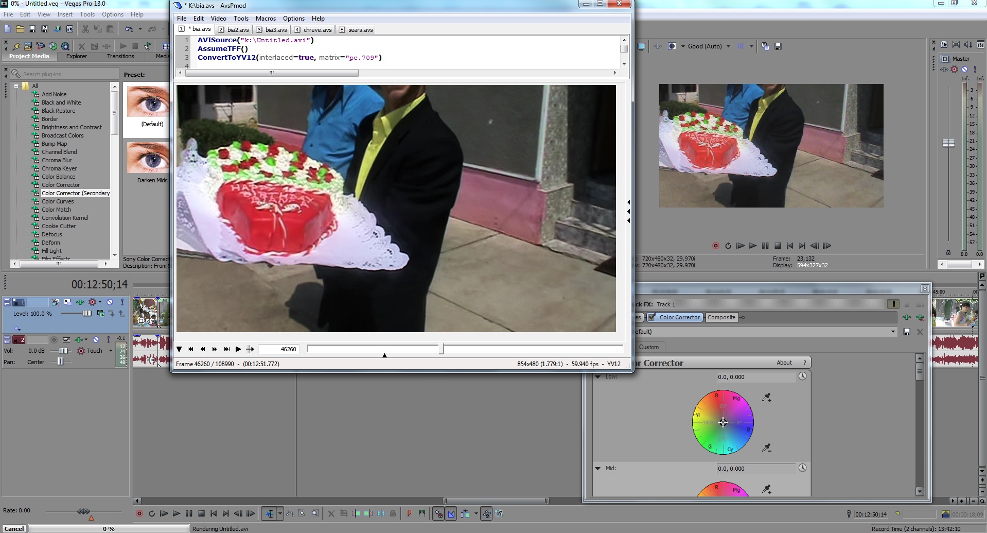

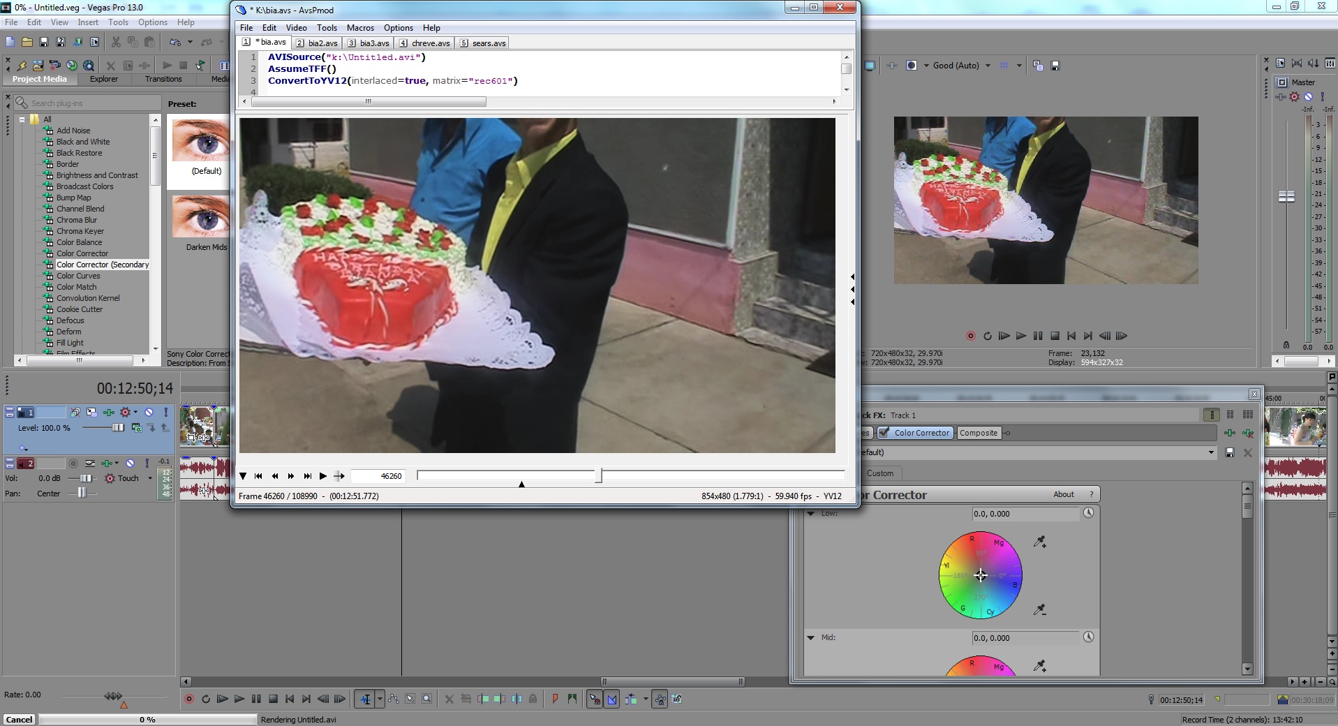

  1. I'm in my last step before I start exporting and I ran into a tricky problem, these options. I find that Rec709 and PC.709 look the best, but I need other opinions and the real answer. Here they are compared to what I'm frameserving out of Vegas:
    Rec601:
    Rec709:
    PC.601:
    PC.709:
    Average:
    What is the best choice here and what does it all mean? From what I learned, Rec is about what is displayed on TVs (or just older tube TVs?), PC is a wider full range for the modern day since our devices evolved. These videos will be played on phones, computers *and* TVs via USB drive or HDMI cord connecting a laptop to a TV. So taking all that into consideration, what do I do? Does Rec601/709 still matter if we're displaying these on a TV somehow, or did the color range get expanded on all modern widescreen TVs making that selection obsolete? And are the 709 picks slightly better than the 601 picks due to its bigger number, more bang for your buck type of thing?
  2. Something discouraging first. You will never get it like original if frame serving out of Vegas and using RGB, not even YUY2, there is either color going to be a bit off or whites get into illegal values a bit. And you chose correct color in your example, red, that color should be checked.
    Closest to the original seems to be: convertToYV12(interlaced=true, matrix="PC.709") , where I get the same color because video is HD, but whites go closer to superwhites (that is why is important to not overblow them while shooting in the first place), but still it seems to be the closest to the original you can get frame serving. You want to get it 100% correct, like original, export lossless intermediate to be perfect (and even then I'm not sure, because I did it only couple of times and did not check levels and color pretty much).
    Vegas could interpret your clip a bit different, it has habits to do that for lossless clips. Sony level effect comes in handy then (Computer RGB to Studio RGB or Studio RGB to Computer RGB). For example Think of that Studio RGB to Computer RGB effect as using matrix="PC.709" in Avisynth.
    Another advice is using Avisynth script to compare original clip and frame serving clip. Something like:
    a=avisource("Vegas_frame_server.avi").convertToYV12(interlaced=true, matrix="PC.709").subtitle("vegas").histogram()
