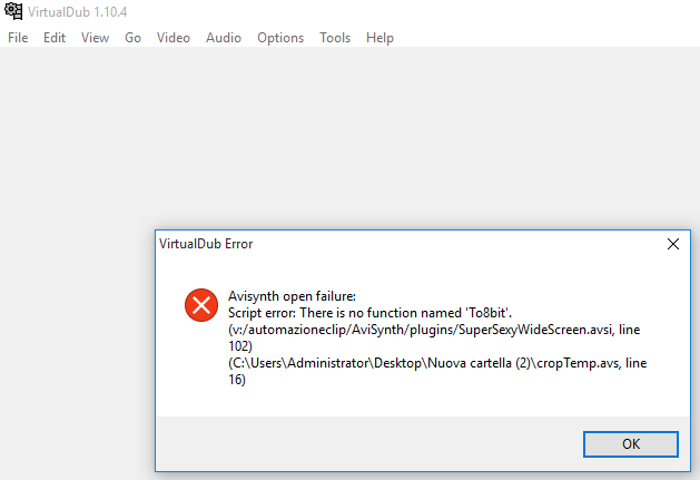

    Referring to your last script I get an error during load:
    [Attachment 43458 - Click to enlarge]
    what can it be to8bit?
  5. "no function named To8bit" - please get the latest version of the script, To8bit is not needed.
    (I removed AviSynth+ code for simplicity)

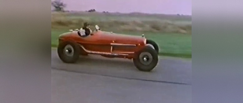

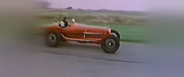

  15. Originally Posted by johnmeyer View Post
    While I'm not a fan of filling in the black pillar bars, some of these, especially raffriff's filling in with the average luma/chroma blur from the main video, look better than what I see on TV.
    However, the one thing that I still think makes it obtrusive is the hard line between the program material and the border. It seems to me that what is needed is some sort of transition ...
    I played around with a soft transition, and while it may look OK as a still frame, watching a video like this is a claustrophobic experience. Without the edge cues you feel like the blurred area is closing in on you. It's like those old movies where the detective wakes up in a fog after being "slipped a mickie." It might be OK for a special effect, but that can be done exactly to order in an editor like Vegas, as you say.
    [Attachment 43476 - Click to enlarge]
    [Attachment 43477 - Click to enlarge]
    [Attachment 43478 - Click to enlarge]
    [Attachment 43479 - Click to enlarge]

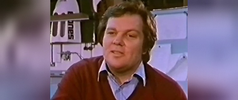

  16. Originally Posted by raffriff42 View Post
    I agree. The edges blending too much becomes distracting. There needs to be a definite line, but hopefully with a border similar enough in colour to not stand out too much as a border much of the time.
    I found disabling the temporal softening on scene changes works well for me, and I removed the slight delay as well (I think your original script used a single frame delay on one side). Something like TemporalSoften(5, 255, 255, 40, 2) seems to do the job.
    For me, having the borders slowly change colour to match a new scene was a little distracting. When they change instantly with a scene change, I find it's far less noticeable, but they're still free to slowly change during a scene if need be and fade in/out when that's what scenes do.
    For me at least, that probably works better than the idea I had a while back of changing the borders on a scene change and keeping them static until the next scene change. That might get tedious too, whereas instant changes at the beginning of a scene and temporal softening in between scene changes is a good compromise.
    It's all personal taste, I guess.

  17. Originally Posted by hello_hello View Post
    And it has a name.... FrostyBorders
    Haha I like the name, and it looks good too. It it more stable (less movement) than my SuperSexyWidescreen, which some might prefer (not me tho lol). People should try them both!
    And black borders are okay too! They're classy and timeless!

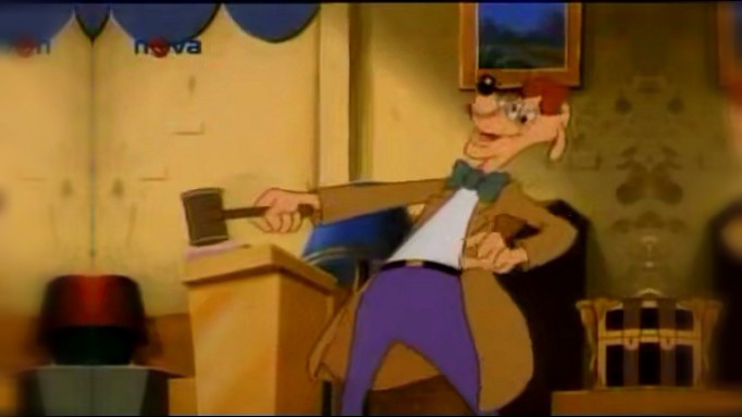

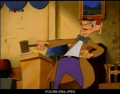

    sorry I am unable to do script in avisynth. Because I am dumb. I did this picture. 4:3 ->16:9 borders. But probably it is not possible do in avisynth real time script. The idea is not to affect original picture by blur effect and take advantage of smoothly increase the blur effect to screen edge. It is reversed and blur is stronger to edge of the picture. But in motion it could do caleidoscope effect, i cant imagine it in motion (not perfectly). Here is the result. Please do not cast stones... I just try.
    And I know it is not perfectly 16:9 but almost.
    Bernix

  23. Originally Posted by Bernix View Post
    Nice, although as I say up the page, you probably want this as a special effect and not for long term viewing.

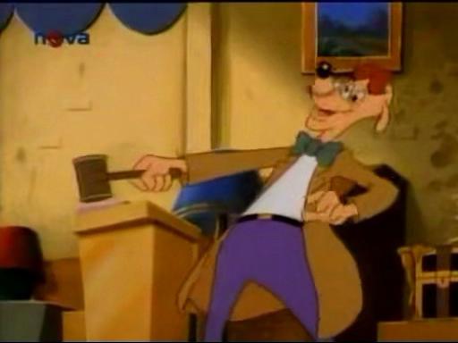

  25. Originally Posted by Bernix View Post
    It's pretty simple.
    ImageSource("TEST43169.jpg")
    left = Crop(0, 0, width/6, height).FlipHorizontal()
    right = Crop(width-width/6, 0, width/6, height).FlipHorizontal()
    StackHorizontal(left, last, right)
    Of course, with horizontal chroma subsampling you have to make sure the parts are mod 2. You can do that by dividing by 12 then multiplying by 2 instead of dividing by 6.
    Starting with this image gives the same result as your sample.
