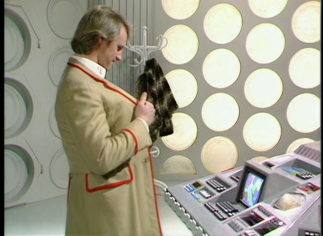

    The original image is first, resized to square pixels (656x480).

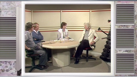

    For the second image I disabled auto-cropping so I could crop manually, and set a picture display aspect ratio of 1.6.

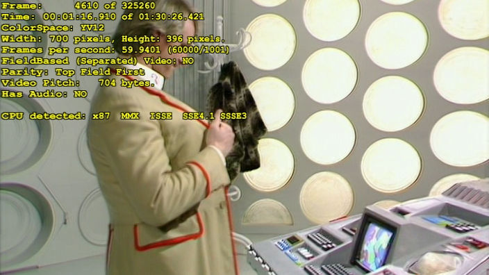

    CropResizeBorder is temporarily followed by Info() so I could see the height after cropping, then that's followed by WarpResized2, which stretches to 16:9.
    Yadif(mode=1)
    CropResizeBorder(0, 0, 12, 0, 8, 24, InDAR=15.0/11.0, PicDAR=1.6, Cthresh=0, Cmode="NR")
    Info()
    WarpedResize2(704,396, 0.9, 1)
    You don't lose a much picture as you would if you cropped to 16:9, and WarpResized2 stretches the image more at the edges than in the middle, so the stretching isn't as painful (you can see the circles are stretched at the edges).
    Personally I think it's still fairly horrible (I'm not adverse to copping, but I don't like stretching), but it's another way of doing it. As I said though, I've no idea if there's a 64 bit version of SimpleResize. I haven't looked.

  28. Originally Posted by marcorocchini View Post
    it does not happen often, almost never: but when you mix videos 16:9 with (old) 4:3 for news it's aesthetically very ugly to see the black or fuzzycat side bars.
    Clearly the dominant format is always 16:9, if for example some archive 4:3 images should take in a journalistic service of 1 minute it's not a good idea to see the fuzzy borders for few seconds sometimes: I know quality is horrible but the journalistic'eye prefers the drop in quality to the side bars in these cases.
    I've have old BBC TV shows and the "DVD Extras" are often 16:9 even though the episodes themselves are 4:3. When they insert segments of old footage (or footage from an episode) it's sometimes cropped to 16:9, sometimes cropped to around 1.5:1 with black bars, sometimes it's 4:3 with black bars and sometimes it's 4:3 with pretty borders around it. It probably depends what works in context and who's authoring the DVD, but I don't find any one method any more annoying than another (although even though I often crop 4:3 to 16:9 for viewing myself, in that context I prefer the cropping method the least). It's a fact of life 4:3 isn't the same shape as 16:9.
    This is from a Doctor Who DVD. The borders might seem silly at first, but they're actually taken from an episode of the show where the actors were watching something on a monitor that was surrounded by those same borders, so they used them for the DVD extras, and to keep the original effect they made the 4:3 image smaller than it otherwise would be. Whatever works....
