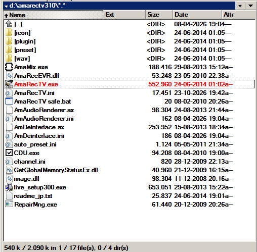

There is nothing to clear out/uninstall with AmarecTV, it is just a portable zipped package.
Are you sure you used the correct archive/program?
[Attachment 94124 - Click to enlarge]

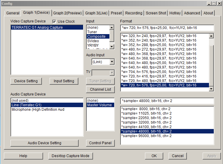

For PAL Composite you should have AmarecTV configured similar like this:
[Attachment 94123 - Click to enlarge]
