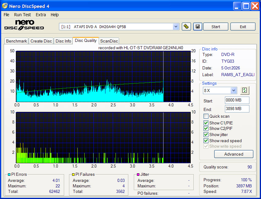

    First - here is a scan of a video disc using my dwindling supply of Legend Pros that I just made Monday. Something representative of most every disc I burn of those, a great quality score of a disc that plays fine (after years of dealing with bad or failing discs I now scan every single video disc I burn b4 filing it away in my collection in case of a bad burn for whatever reason, and for any rare problems I burn them again; I collect a lot of Sports games and am an addict for the teams that I follow; probably sounds crazy but is a fun hobby and even trade/share stuff with the few friends who even still have DVD or blu-ray drives instead of streaming things).
    This shows a GOOD scan (Legend Pro media) of a DVD video disc:
    [Attachment 93981 - Click to enlarge]

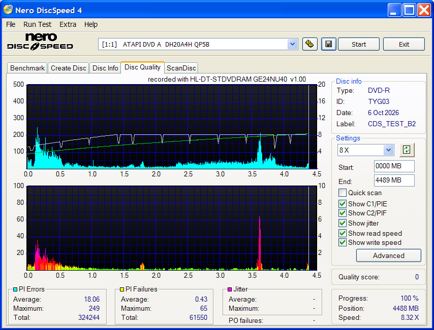

    Next here are some shockingly bad test results of the CMC Pros I just got. Again I suspect that the seller of these is selling very old media, probably not even stored under proper conditions, thus no matter the state of my equipment the discs are damaged and are absolute crap, don't play right and test representatively of how bad they are.
    This is a scan of a CMC Pro video DVD - absolutely horrendous quality:
    [Attachment 93982 - Click to enlarge]
    I even tried using Nero DiscSpeed on the XP laptop to make what it calls "test" discs at various speeds then scanned those in the desktop PC with Nero DiscSpeed and sheesh, those results are beyond belief, some of the worst results I have ever seen. Tested at different write speeds and all pretty much the same result. Here is one of them.
    Again just putrid and shows how unusable this media is (TOTAL waste of $40!!!!! Sigh):
    [Attachment 93983 - Click to enlarge]
