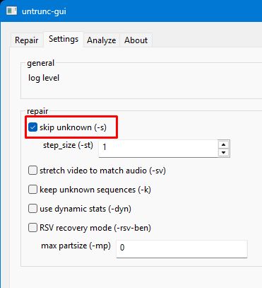

Try with this one:
https://www.videohelp.com/software/MP4-Repair-untrunc-GUI
Create a new video with the same camera and the same settings (resolution, fps aso) as reference file.
In the app settings set skip unknown
[Attachment 93822 - Click to enlarge]
Then click repair.
