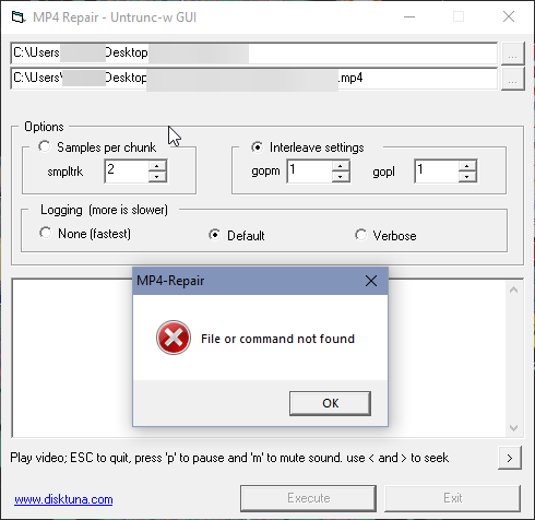

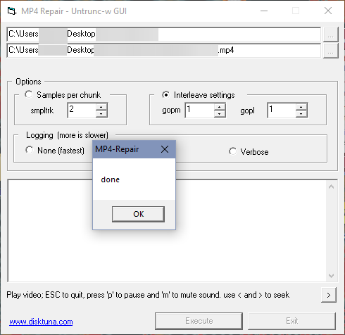

    I've read the comments that someone said, "you can only select files to repair from C: drive". For reference file, I put a destination (Desktop). So my file was already on C: as you can see down, after the process, display "file or commant not found". After clicking ok, displays "done". I cant get it. I can only save my mp4 to C: drive letter, or on program files, or anywhere else but of course onto my pc ? Let me know guys.

    Nope. Still cant get it working. This app, whoever deshigned it, is so broken. Why I cant select a single file and repair it ? It gives me the
    error again and again "file or command not found".. c'mon, make a free app for people just want to get a truncated file back. -_-

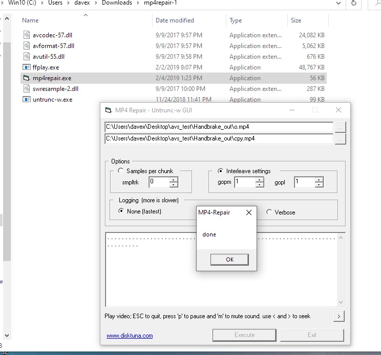

    It works for me. I downloaded the latest version at your link above. I expanded the archive into a subfolder in my downloads folder.

  7. Originally Posted by davexnet View Post
    Still doesnt work. Man.. it says is done at least, but the truncated video is still the same.. another solution??
    Mar 2008
    Possibly the file contains enough bad data the repair is not complete.
    Try dropping the repaired file into MKVTOOLNIX GUI to see if the resulting MKV file plays, or whether you get
    any further error messages

  11. Originally Posted by DVDLover00 View Post
    Because MP4 files typically have all the information about the video (frame size, codecs, etc.) at the end of the video. Without that information it's very difficult to figure out what needs to be done.
    I've never used the program but it probably doesn't change the original file. Look for an output folder option to find your new fixed file.
  12. Originally Posted by DVDLover00 View Post
    Why I cant select a single file and repair it ?.
    Because the truncated file is missing essential information.
    To get this missing information the program needs a good reference video.
    For this you have to load BOTH videos, the truncated and the reference video.
    The last must be another video as the truncated one.
