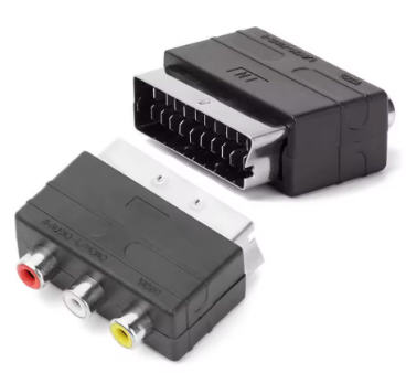

    Did you use this type of adapter to connect to rear of Panasonic?
    [Attachment 93569 - Click to enlarge]
    Unfortunately no RCA inputs only SCART.

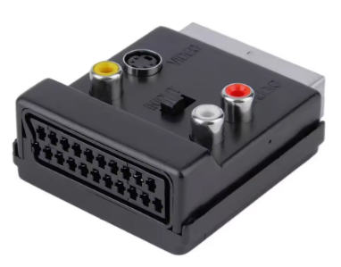

    [Attachment 93570 - Click to enlarge]
    If possible get this adapter with RCA/S-Video to SCART adapter from Aliexpress.
    Yes those are the connectors and inputs Im using. I've also tried cable with 3 RCA s on one end (camcorder) and scart on other end (DVD recorder), so not needing the adapter. Same result with both options

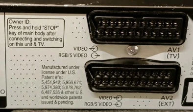

    OK, you use an adapter. Here is the respond from Google AI.
    Ah, that makes total sense—the UK/European models of the Panasonic DMR-EX773 lack the front-facing RCA jacks commonly found on the international variants.
    Since you must use the rear AV2 (EXT) SCART socket shown in your image, we need to bypass a specific European firmware restriction regarding Q-Link / EXT Link and input signals.
