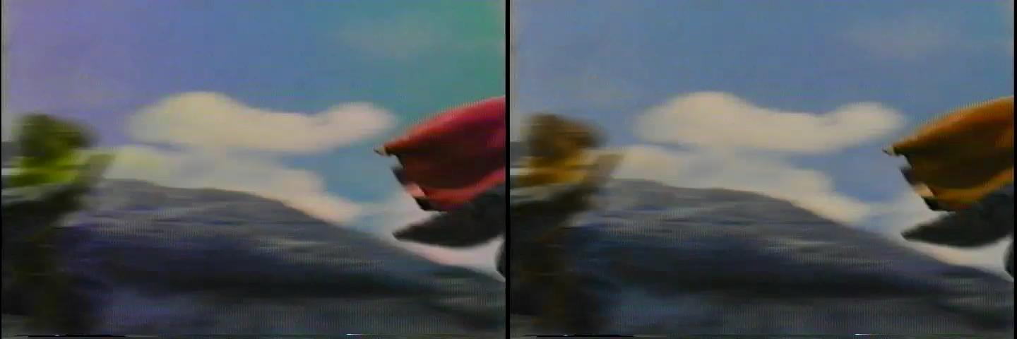

  3. I'm not sure this will work with every shot but there's an improvement:
    before and after:
    [Attachment 81400 - Click to enlarge]

  4. Astonishing result & script
  5. Thanks. It's not perfect but it worked a little better than I expected it was going to. I'm not sure if it will work with other shots without some tuning. Applying a gamma curve to the mask might help too.

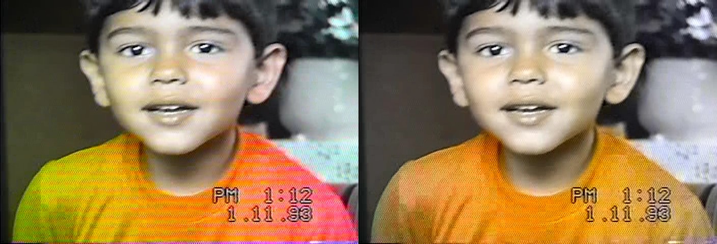

  12. That GreyRamp() is fine. The effect on the girl's face is pretty subtle. Look in the lower left of the frame. The floor turns from purple to grey.

  14. I used the top of frame 3145 to come up with this, original on the left, fixed on the right:
    [Attachment 81872 - Click to enlarge]
    LWLibavVideoSource("Sample 3.mp4", cache=false, prefer_hw=2)
    ramp = GreyRamp().BilinearResize(width,height).ConvertToYV12(matrix="pc.601").ColorYUV(gamma_y=-100)
    h030 = Tweak(Hue=30)
    h320 = Tweak(Hue=320)
    Overlay(last, h030, mask=ramp.Invert())
    Overlay(last, h320, mask=ramp)
    It may still need some further tweaking of the colors but at least they're fairly consistent across the frame now.
    BTH, the script works pretty well for the earlier clips too.
