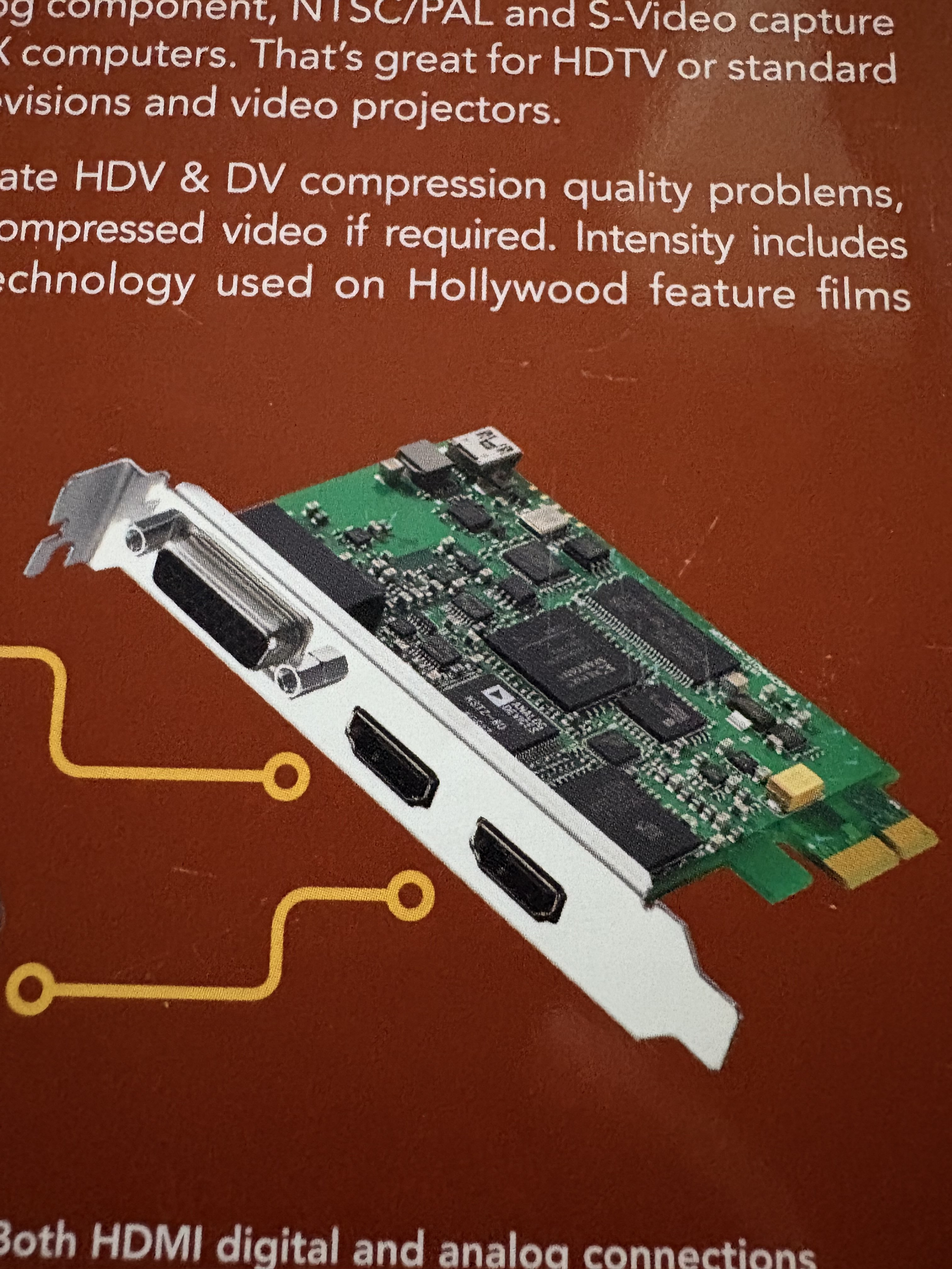

I did some searching on which PCI-e capture device would work for component and I settled on the older Blackmagic Intensity Pro as from this word that it was "OK" here (https://www.digitalfaq.com/forum/vid...t-capture.html)

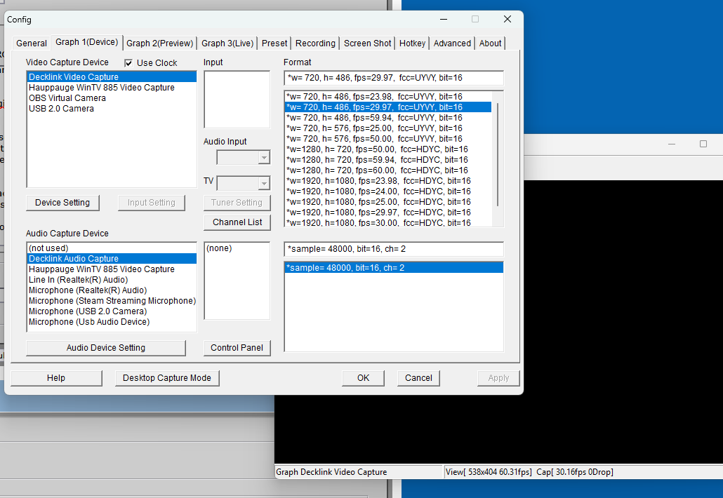

I've just received the card and have been trying to use it on my Windows 11 desktop in the same way that I use the PVR 1290 for composite and S-Video capture. But after installing the drivers for the card from both the included DVD and from one other ISO on archive org for the device I still only get a black screen and no audio.
Nothing on Virtualdub, Amarec and even Blackmagic Media Express from the DVD it came with.

Hi! What Betacam deck do you use? Do you connect the intensity shuttle directly to the deck, or do you use a TBC?
The blackmagic cards require a stable and strong signal, depending on what deck you use that could be a possible issue.
You can also try to download the latest Desktop Video 16.1 directly from Blackmagic support, if you havenīt tried that, instead of Archive.org or the DVD. -
Probably you need to activate component input as it seems HDMI input is active (BM in HDMI capture mode require to set particular HDMI video mode in advance then this video mode is negotiated with HDMI source).
In component mode you should have more freedom than in HDMI mode.
