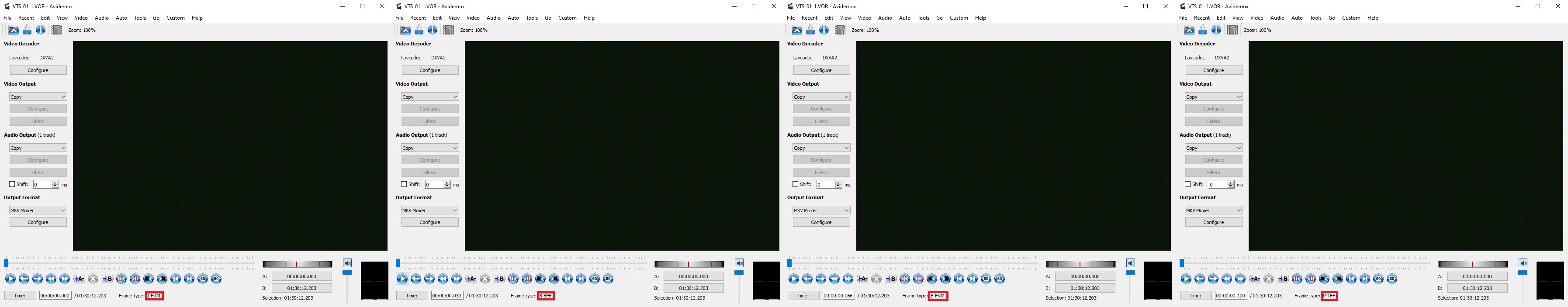

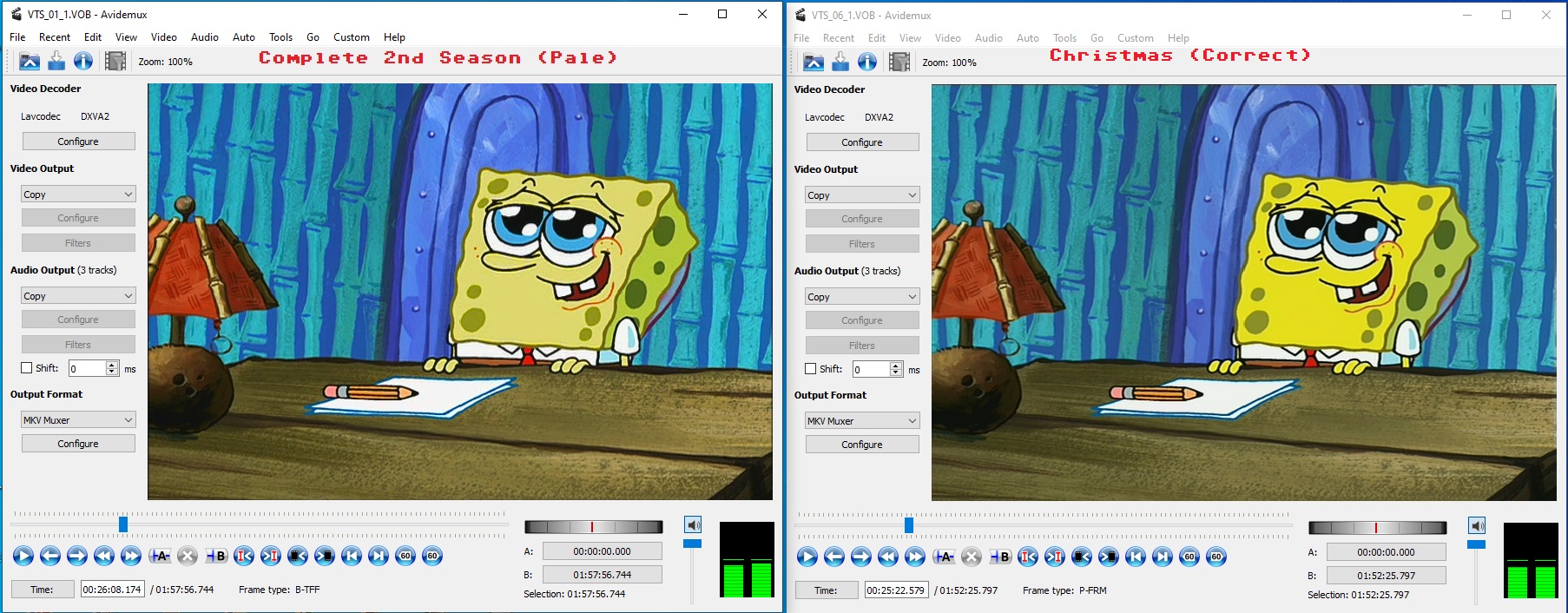

    One issue with the "Season 2" DVD is that most of the episodes have incorrect color composition. For Example, in the episode "Procrastination", on the "Christmas" DVD, SpongeBob looks normal. On the "Season 2" DVD, SpongeBob looks rather pale and doesn't accurately depict how it was originally aired, unlike the "Christmas" DVD.
    Another issue here, which I would like to talk about, is the encoding.
    I am going to use "Avidemux" and the raw VOB files from the discs to demonstrate this scenario.
    All of the frames on the "Season 2" DVD are marked as "TFF" or "Top Field First", which is to be expected from a DVD source.
    However, on "Christmas" DVD, some frames are "TFF", most frames are "FRM" which is just a progressive frame, which doesn't seem normal to me.
    Not only that, but the playback on the "Christmas" DVD is choppy compared to the "Season 2" DVD, whereas it is rather consistent.
    I would rather preserve copies with the correct color composition so I could deinterlace them myself, but I can't work with such wonky scenarios. I will leave some images below so you guys can take a look at this phenomenon. If you can, please let me know what is going on, why is this happening, what can I do to counteract this, etc.? If you guys need me to upload anything else helpful, please let me know. Thanks!
    [Attachment 92684 - Click to enlarge]
    [Attachment 92685 - Click to enlarge]

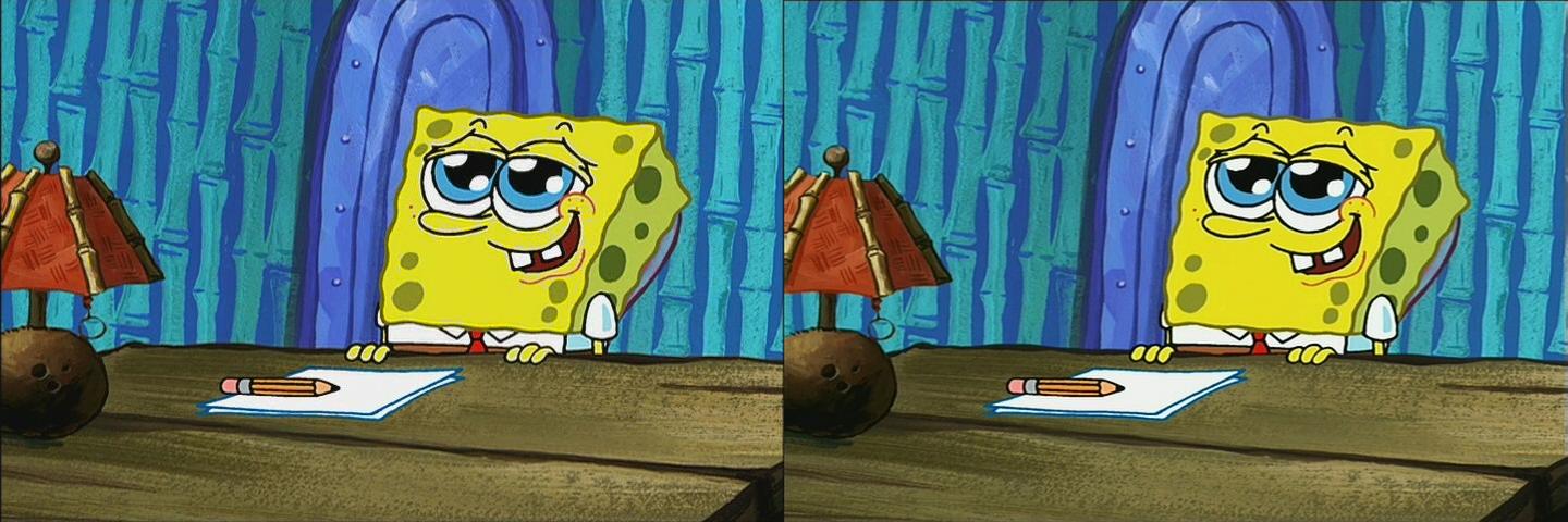

    The colors are a bit tricky. There is a slight brightness difference between the left and right images. The left image is more saturated overall -- except for the yellows. The right image has really pumped up yellows. I suspect the left image is closer to correct. But here's the left and right images after adjusting the left image to more closely match the right:

    As noted earlier VTS_01_2 is generally more saturated. Except for yellows, which are much more saturated.
