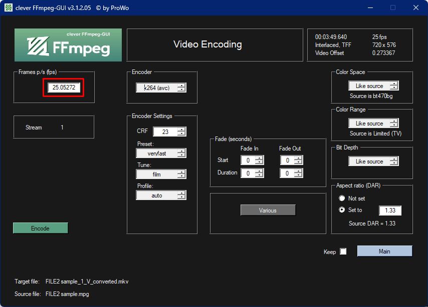

  12. Assume the following:
    File1 is original ntsc 29.97 fps, converted to pal 25fps at same duration.
    This results in a framerate reduction with a factor of 1.1988011988011988.
    Further assume that file 2 was converted from ntsc 23.976 fps to pal 25 fps at the same duration.
    Now to get file 2 to the same speed as file 1, you have to convert it with a framerate of 21.745 fps at the same duration.
    Try this.

  15. Originally Posted by ProWo View Post
    Try this.

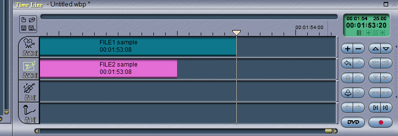

    Guys, I still can't get it to work. I am not sure I am understanding all you're telling me to do, but I have followed the steps in clever FFmpeg-GUI as explained by ProWo in reply #2, and tried the various fps settings you've mentioned throughout the thread, both with and without the "Change length" box checked, but the resulted file either plays too slow or too fast.
    When converted to 21.745 fps, 'Change length' checked, the resulting file plays too slow
    When converted to 21.745 fps, 'Change length' not checked, it plays too fast
    When converted to 23.976 fps, 'Change length' checked, it plays too slow
    When converted to 23.976 fps, 'Change length' not checked, it plays too fast
    I have uploaded two sample files here: https://file.io/DSId6SxUefk0
    They're just under 2 minutes long and both contain the exact same scenes. Maybe you could download them and take a look what needs to be done to get file 2 to play at the same speed as file 1? I would really appreciate it. And if you are able to figure out a way, I'd be even more grateful if you could give me some easy steps on how I achieve the speed change for the complete file 2. This simply goes beyond my limited skills.

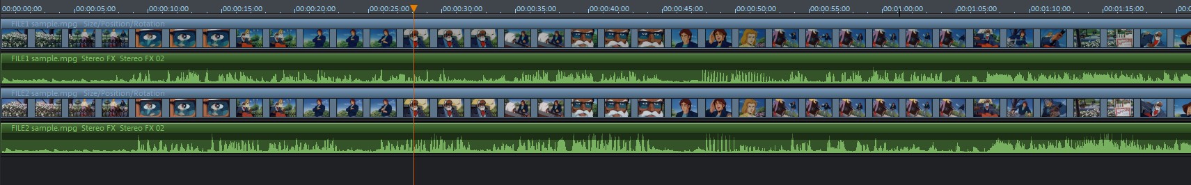

    They are both playing at the same speed. Here, the left video is playing the left channel and the right video is playing the right channel. The pic is a section of the timeline; it looks like they are synced. Each video is in a different language, I think. This is Magix Movie Studio, which is payware, but I post to illustrate that there is no speed issue that I can tell.
    [Attachment 72635 - Click to enlarge]
  18. Originally Posted by Alwyn View Post

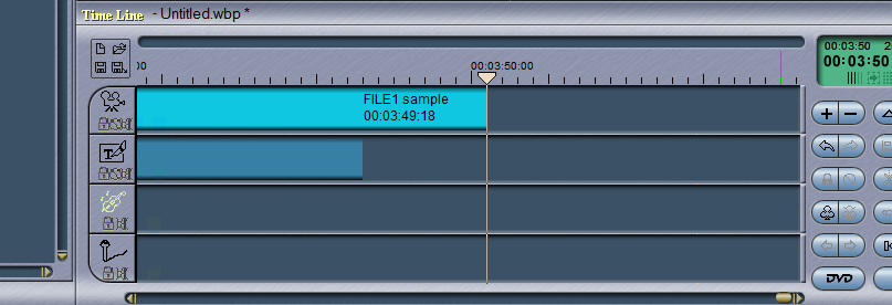

    But no, they are slightly different in length. File 1 is a tiny bit little longer, 5 frames to be exact. See here: Image
    [Attachment 72659 - Click to enlarge]
    This becomes much more apparent after 10-15 minutes, where the videos will be totally out of sync with each other. But even that short sequence is not entirely in sync at the end of the 2 minutes and 53 seconds.
    Your file link results in: "The transfer you requested has been deleted."
    I'm sorry, the file hosting site must've deleted them. They were supposed to stay online for 30 days. I have reuploaded them to a different place, and this time I made the samples about twice as long as the last ones, so that the speed difference will be a little more obvious, about 8 frames at this length: Image
    [Attachment 72660 - Click to enlarge]
    The longer the video plays, the more out of sync it becomes.

    Fair enough, I was looking mainly at the audio. I stretched file 2 5 frames to match File1.
  20. Set FPS to 25.05272 (Change length not checked) on FILE2 sample.mpg to match it with FILE1 sample.mpg.
    [Attachment 72662 - Click to enlarge]
    (Corrected video length only, no other improvements, audio also needs to be fixed).

  23. Originally Posted by ProWo View Post
    Thank you so much for your help!
