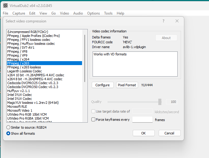

  5. Maybe use H.265 4:4:4 lossless encoding,... (newer gpus should support hardware decoding this)
    Aug 2023
    Goiânia
    My version of VirtualDub only has the H.264 codec. Is there a version with H.265 ?
  7. Originally Posted by Isac.martins View Post
    https://www.videohelp.com/software/VirtualDub2
    or here, including a 32bit version
    https://github.com/v0lt/VirtualDub2/releases/tag/2.5.1
    [Attachment 92562 - Click to enlarge]
