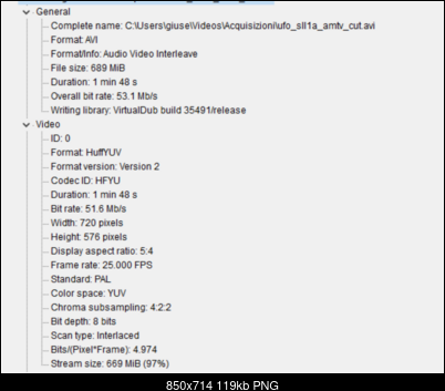

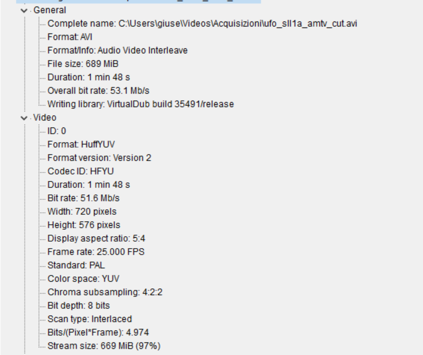

  3. Captures & Restoration lollo's Avatar
    Jul 2018
    Italy
    Color space (YUV) and Chroma subsampling (4:2:2) are properly reported.
    Maybe you refer to BT 601/Rec.601 Color matrix? I ignore how.

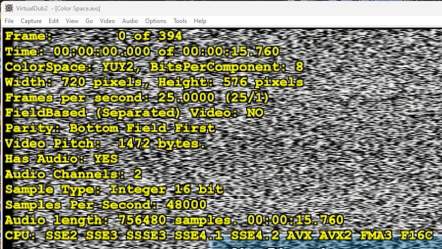

    Arr, found an old Doom9 thread that said use ".info". It gave this report:
    [Attachment 76887 - Click to enlarge]
    I am now confused . is YUY2 the same as YUV?

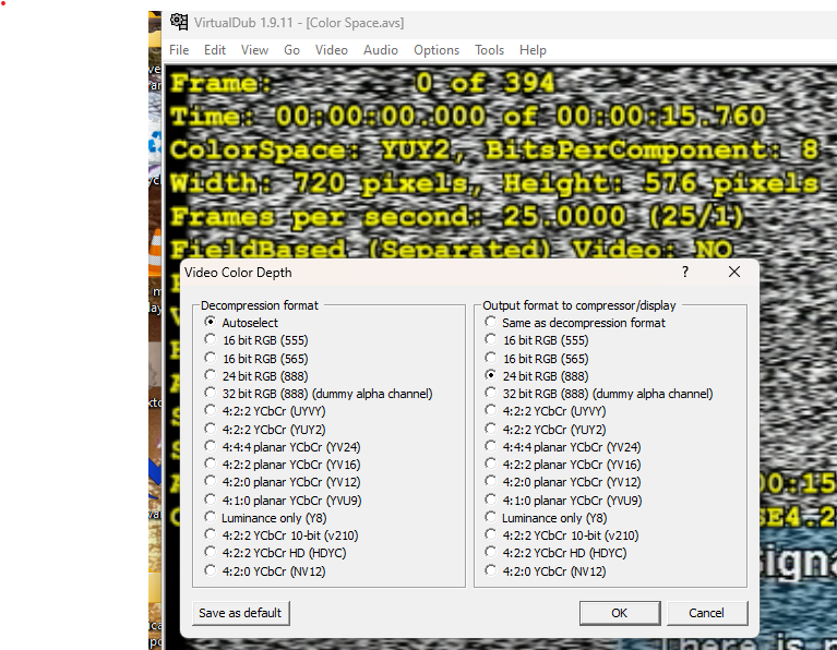

    If you're using VDub, you can check the color space by going to Video -> Color Depth.
    May 2005
    Australia-PAL Land
    I'm not sure Color Depth shows the current color space:
    [Attachment 76888 - Click to enlarge]

  10. Originally Posted by Alwyn View Post
    YUY2 is 8-bit 4:2:2 YUV yes
    https://www.loc.gov/preservation/digital/formats/fdd/fdd000364.shtml
    It doesn't strictly say what variant of YUV it is though, if it's SD video it's most likely the Rec. 601 color matrix (of whatever standard (525 or 625 line) the clip is. I don't think the .avi container or lagarith codec have any way of encoding that metadata however so you would have to determine that by looking at the footage and/or judging by the source.

  14. Captures & Restoration lollo's Avatar
    Jul 2018
    Italy
    I'm deflated that you think I don't know what I'm doing.
    I did not think that, just providing an example of one of my HuffYUV AmarecTV capture
