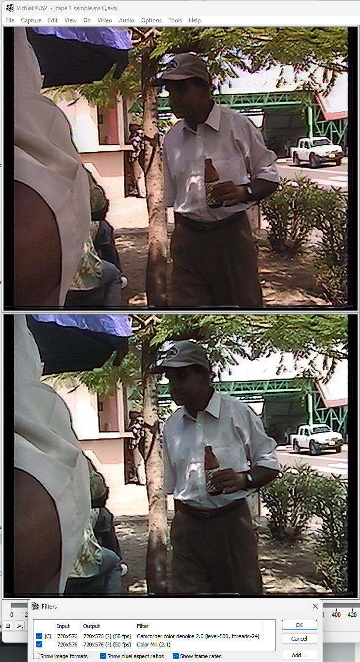

    I reckon it's a bit on the reddish side. I open my AVSs in VDub2 and apply Camcorder Colour Denoise at full strength, then use Colormill to adjust the colours. In this case, I dropped the red to give it a more neutral look - note the white shirts. I also adjusted the levels a tad in Colormill to give it more contrast.
    CCD 32bit & 64bit (my website, it's safe)
    Colormill 32bit & 64bit
