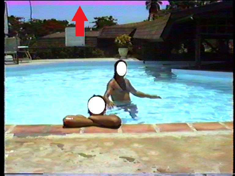

All in all, the S9000E currently produces a overall picture that I would not be satisfied with and that is hardly on-par with a much more cheaper and less sophisticated D8 camcorder... Sometimes, the player would also produce a purple band across the upper part of the picture, but not consistently, only in some "scenes". It would come and go changing with scenes after hard cuts:
[Attachment 77489 - Click to enlarge]
