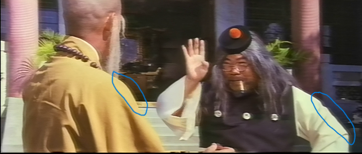

  15. Is there a filter which can help remove the issue in blue circled areas :
    [Attachment 90588 - Click to enlarge]

    Difficult; try dehalo with large x depth or LGhost/GhostBuster

  20. Originally Posted by lollo View Post
    Thanks i give it a try.

    Thanks Johnmeyer, I use the 64bit avisynth, so im stuck on : "cannot load a 32 bit Dll in 64 bit avisynth - RemovegrainSSE2.dll issue. Is there anyway round this on 64bit ?

  26. Footnote: As an alternative it may be easier to substitute the glitchy frames or fields (even a few in a row) by motion interpolated frames of adjacent good frames. Using a good interpolator like RIFE the interpolated frames are hardly discernible from genuine frames and are unnoticed by casual viewers. Well, it's a possible workaround rather than a clean fix of the root cause.
  27. Captures & Restoration lollo's Avatar
    Jul 2018
    Italy
    The motion interpolation still needs the shifted fields to be identified to be applied, that's were the difficulty stands. (BTW I prefere the un-shift of the fields, because it does not alter the original content).
    The root cause is the line base correction of the VCR (or the DVD Recorder in the case of OP) related to the condition of the tapes, so little can be done about that in my experience. I remember in some comparisons that a specific Pioneer DVD-Recorder was showing less occasional field vertical jitter than a VCR or a Panasonic DVD-R, but had less overall quality.
  28. Would it make a difference to field shifts issue if I try recapture the VHS, but this time using a Panasonic DMR ES15 included in the process ?
  29. How about:
    a. separate the fields
    b. apply Stab on even and odd fields
    c. reinterlace
    d. deinterlace
    that seems to work fine here for the field shifting,...
  30. Thanks Selur, my avisynth knowledge is weak, are you able to put that as a script for me to try on my source please.
