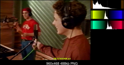

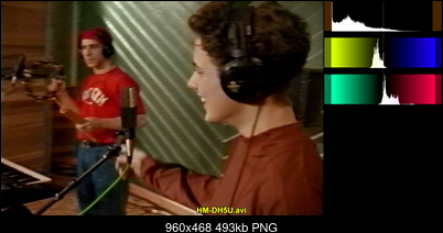

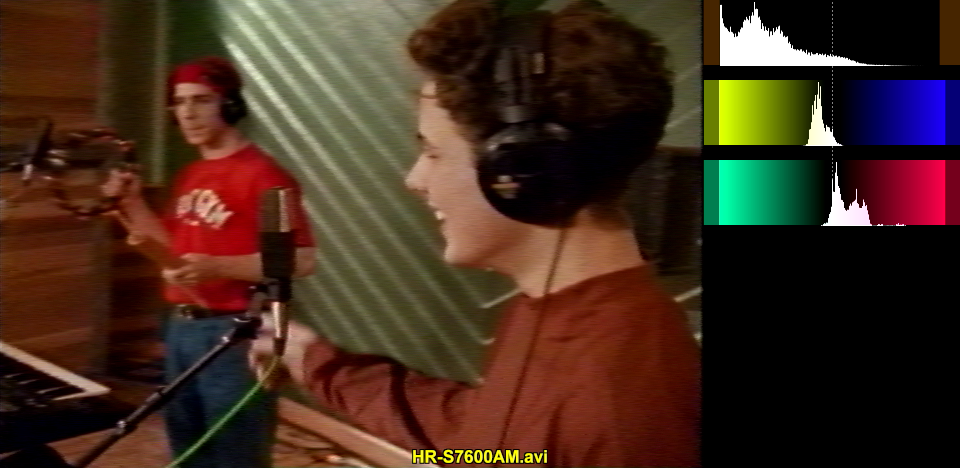

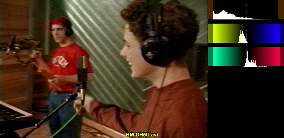

    Quick view on my side, no deinterlace, just a preliminary impression.
    I prefer HM-DH5U, even if it crops more on the top and has more head switching noise and has more crushed blacks.
    Less soften video, more noise, maybe more details, better overall look.
    https://imgsli.com/MTk5OTQz
    https://imgsli.com/MTk5OTQ0
    https://imgsli.com/MTk5OTQ2

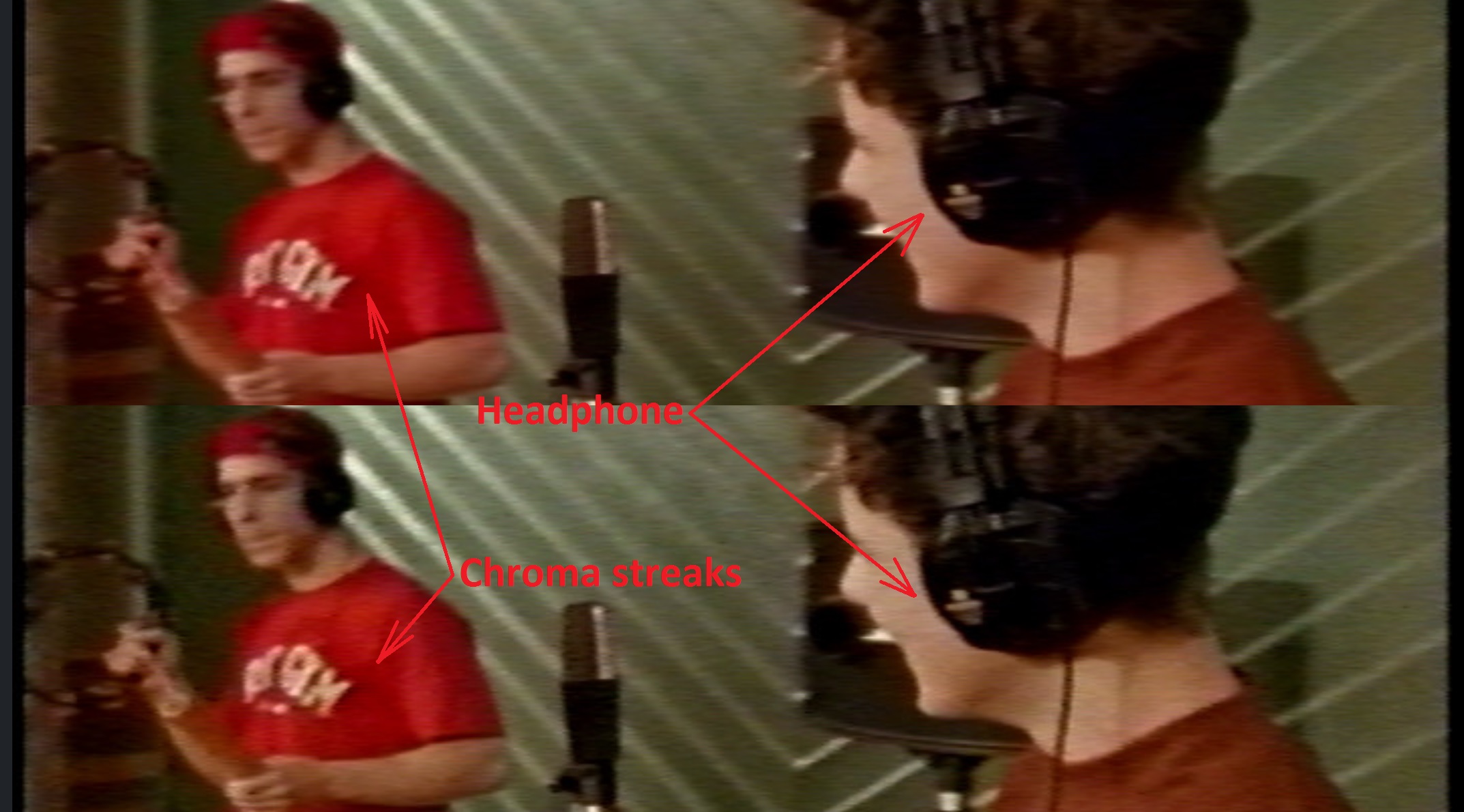

    The DH5U is noisy without adding more detail. On contrary, look at the headphone on the guy on the right: on the 7600 you can see the letter "S" (at least I think it is an "S"), on the DH5U there are just two blobs. Look at the T-shirt on the guy on the left: the horizontal chroma streaks are ugly, especially the ones to the right of the white print. Or look at his chin, you can see shade that looks like checkerboard on the DH5U. I don't know is it different interlaced chroma processing, or is it "just" noise reduction, but 7600 looks much better. I would like you see you processing the DH5U image to get rid of these streaks while preserving overall detail.
    The 7600 is cleaner, better color, and in some cases even has more detail!
    7600 all the way.
    You must be joking.
    No way. On the other hand, look at the shirt of the guy in the right of the picture I posted. More details, the "lines" almost disappeared in the 7600.
    I stop here, you'll be able to argue and continue your non sense forever

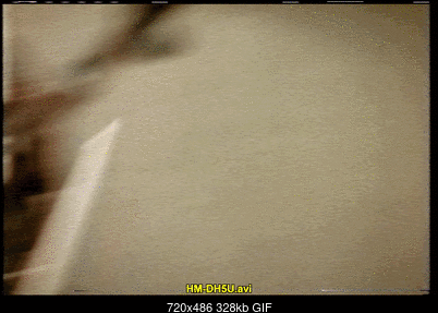

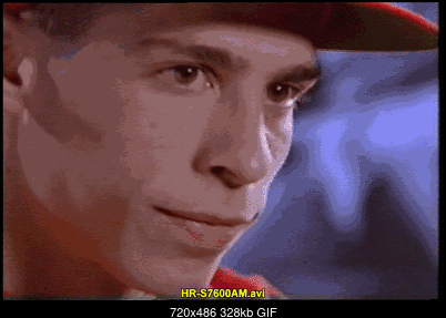

    The potential drawback in HM-DH5U is that the common JVC TBC/N.R. defect of the temporal chroma denoise affecting the frames at scene changes
    https://forum.videohelp.com/threads/401232-JVC-S-VHS-settings-for-capture-%28again%29
    https://forum.videohelp.com/threads/395451-Chroma-mess

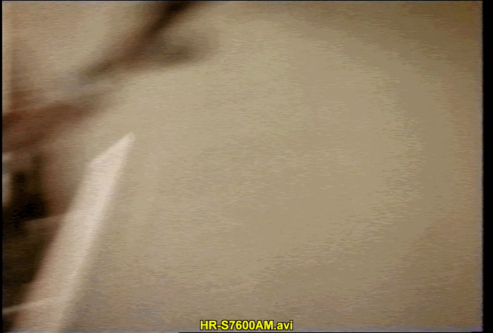

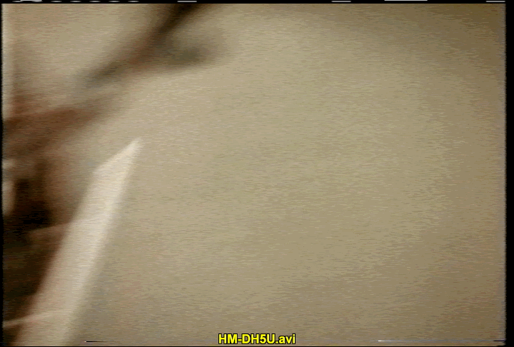

    seems more evident compared to HR-S7600AM, especially in case 2.
    In this sample the defect stays for 1/2 frames only so is not that important anyhow.
    case 1 hat visor on the right contamination
    case 2 overall beige color contamination

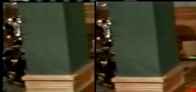

    There you go. Chroma noise gone. Very, very mild filtering on the Luma as well. Looks quite good for VHS – in my opinion.
    The first frame of some scene changes is somewhat messy, but it was like that in the source as pointed out by lollo and is likely because of some noise reduction/processing inside the DH5U (which is apparently not very effective).

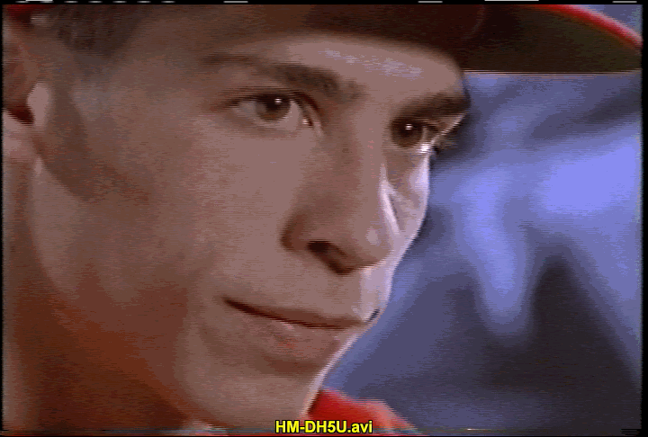

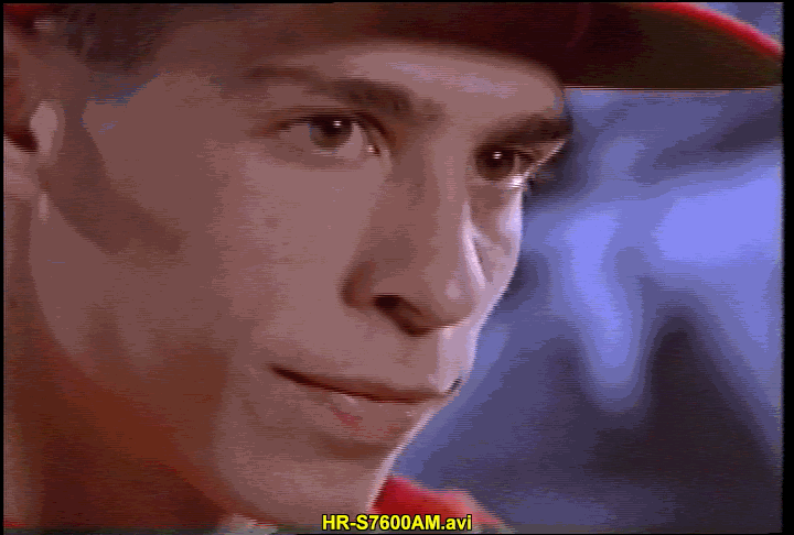

    https://imgsli.com/MjAwNDk2
    https://imgsli.com/MjAwNDk3
    (Doesn't show well in still images though.)
  24. Capturing Memories dellsam34's Avatar
    Jan 2016
    I still prefer the primitive DNR of the S7600AM on the right.
    https://imgsli.com/MjAwNTg5

    Doesn't the chroma bleeding exist between all frames? It's just most obvious at sceen changes, no?
    Yes and no. The JVC N.R. on chroma is a temporal filtering (my guess), so it suffers more at scene change because there is contamination from previous frame. IMO there is no "intrinsic" bleeding between frames, just the radius is higher than 1. Just speculating.

    I quickly did something similar, and obtained this. I did not compare against yours, just versus originals; no competition, just experimenting
    JVC-HM-DH5U 5 versus HM-DH5U 5 restored:
    https://imgsli.com/MjAwNjY0
    https://imgsli.com/MjAwNjY1
    JVC-HR-S7600AM versus HM-DH5U restored (sorry, I forgot to shift one of the 2 images and align for a better comparison):
    https://imgsli.com/MjAwNjY2
    https://imgsli.com/MjAwNjY3
    The output file: HM-DH5U_restored.avi
    What is missing for a complete picture is a restoration on JVC-HR-S7600AM (which can use for example a temporal radius = 1 or 2 for denoising, because its capture ic "cleaner").
    I did not adress specifically addressed the chroma aspects, if not included in the filters I used.
    Edit: the restored clip has been kept interlaced, or better "lossless deinterlaced / filtered / interlaced back" for better comparison. Working on a deinterlaced clip would allow the filtering to be more effective
