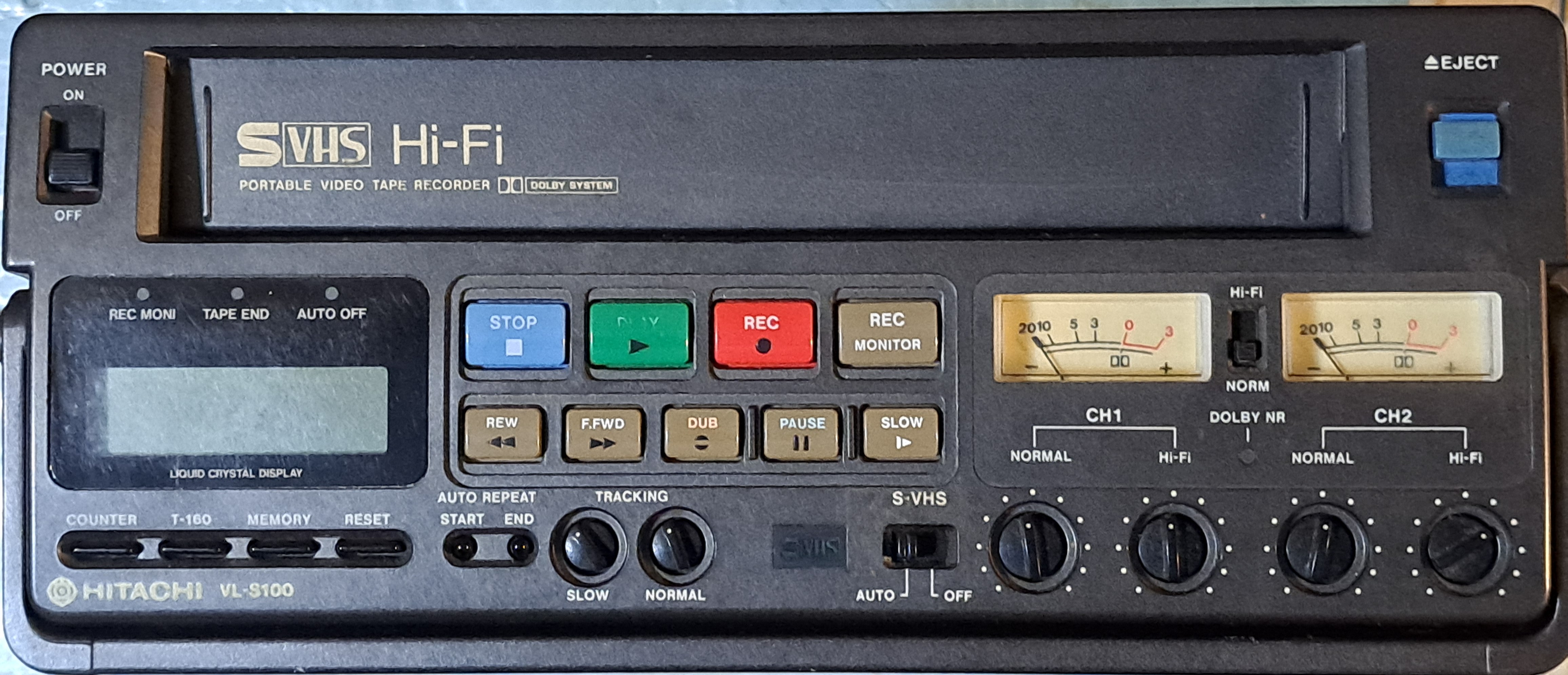

    I just purchased the S100 and was excited it had TBC and preamp on the drum only to find it functions in SP only.
    So I can't play my EP SVHS tapes thru it.
    But is there any way its TBC could be used?
    I ask these questions as an infant noob, I have gear, I know about RF capture, but I don't know how the gear is strung together and the process (I had a better idea 1-2 years ago but at 72 my memory is garbage).
    I am probably not interested in methods that take massive time to rip tapes. I have 18 pro grade SVHS tapes that are "time capsules" of bits, snippets and pieces of stuff from OTA TV that were amazing - predating the internet for the most part.
    If the S100 has no value, I'm going to return it.

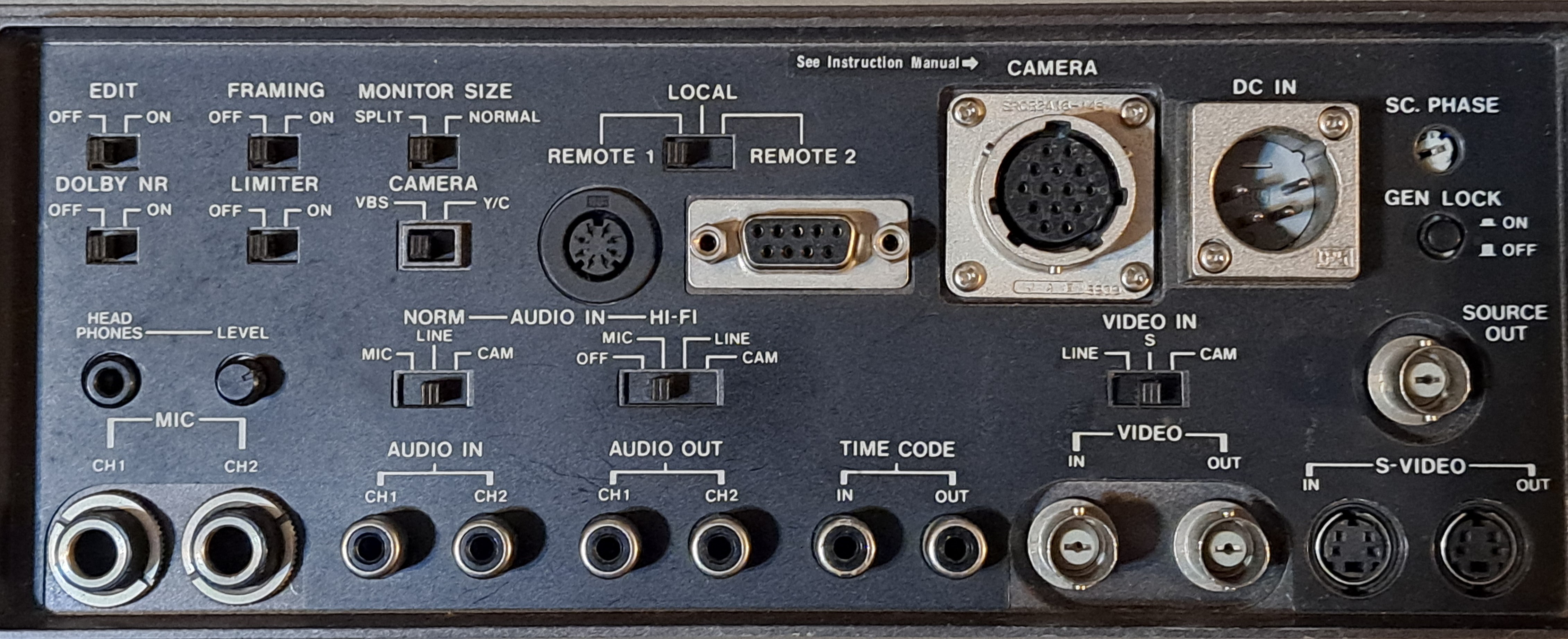

    NOTE: I took crappy cell phone pics of the User Manual which may be the only one in existence on net - Chat could not find any.

    Having a pre-amp on the drum is a great idea but watch out for the contact brushes, they tend to wear out or get dirty and create static noise, Manual tracking is nice for problematic tapes but automatic tracking is much better. If your tapes are SP keep it.
  3. Member MrCreosote's Avatar
    Jan 2005
    Unfortunately all my tapes are EP.
    So the TBC is of no use for digitizing?
  4. if you need a good EP s-vhs deck i have one. No tbc but great in this specialty. Although you're in the u.s, might make things not easy.
