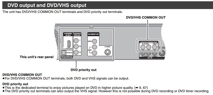

    EZ-48V PAL back panel:
    [Attachment 77992 - Click to enlarge]

    An update. I've been testing out the GV-USB2 via the 'DVD priority S-Video out' on the EZ47V using (I believe I read somewhere it's actually your guide?) https://www.aaproductions.net/amarectv.htm
    I followed everything including selecting 'PAL-B' under the video decoder settings (which I hope is accurate). The only thing I left default were the 'Video Proc Amp' values. I've compared a recording to the unit's straight to DVD burn vs the capture with the GV-USB2. The video on the straight to DVD burn is much more stable, whereas the capture with the GV-USB2 is unstable (picture jumps around) and is fuzzy. I imagine the 'TBC-ish' features have been applied to the straight to DVD burn which makes for a 'cleaner' image -- the same image correction does not seem to have been applied to the GV-USB2 capture.
    I've tried connecting the S-video of the GV-USB2 to the 'DVD/VHS common out' instead, but cannot receive a signal. The only other variable I can think of is the S-video cable connecting the GV-USB2 to the VCR is quite long at 3m (and should be a good quality cable), but I'm not sure this would affect anything.
    Have I done something wrong?

    Yes, that is my guide.
    To clarify, are you playing your tape in the EZ-47 or passing through it?
    I haven't tried passing through it because I figure it's easier to just play the tape in the 47 in the first place. You'll get full stabilising then without the extra cabling from the VCR to the 47.
    I don't have a lot of experience with long cables but others have said they should be kept as short as possible.

    Playing tape through EZ47 -- S-Video (and audio cables) from 'DVD Priority out' to the GV-USB2, then straight into my PC.

    Note: On the EZ-48, the DVD/VHS "Common Out" doesn't include the S-Video port in the corner; that port is for AV1 In (hard to spot! )
