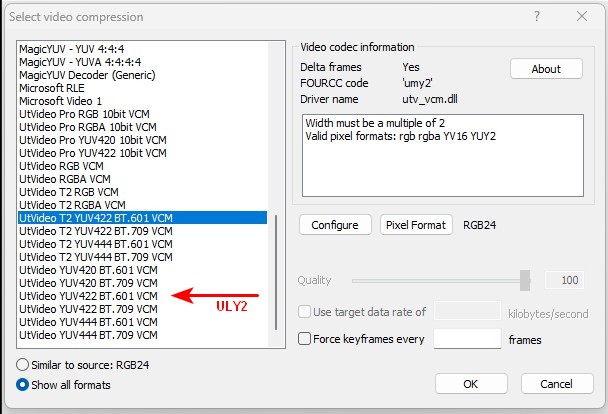

    Thanks @oln, UT has two YUV422 codecs, ULY2 and UMY2. Do you have any thoughts on which of those to use for analogue captures?
    [Attachment 78559 - Click to enlarge]
  8. ULY2 for YUV.
    See the package's readme.
  9. Yeah ULY2 variant, 422 BT. 601 is the one you want. You can also set it to encode as interlaced in the options, not sure if it helps compression any though it does at least signal to the application reading it that it's interlaced. (Though, as with huffyuv it doesn't have any option to flag field order.)
    The T2 variant is a faster variant with less compression (I think it also has added support for compression between frames which is not very useful for this application)
