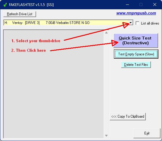

Your thumbdrive could be fake.
You can test this with FakeFlashTest
https://rmprepusb.com/wp-content/uploads/2022/09/FAKEFLASHTEST_v1.1.5_password_is_fake.zip
[Attachment 72128 - Click to enlarge]
Attention. This test will delete all data on the drive. So save all files before.
After the test you have to reformat the thumbdrive. -
