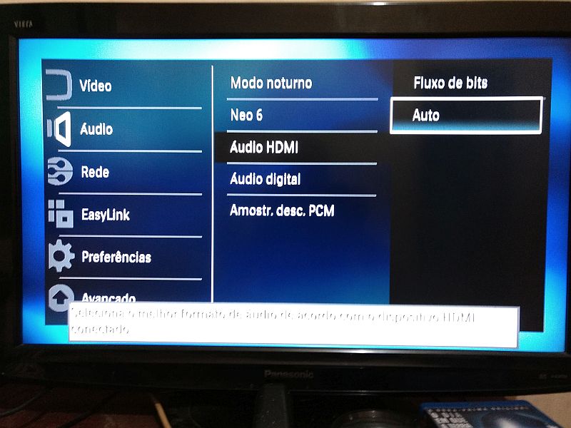

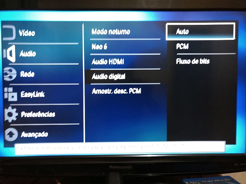

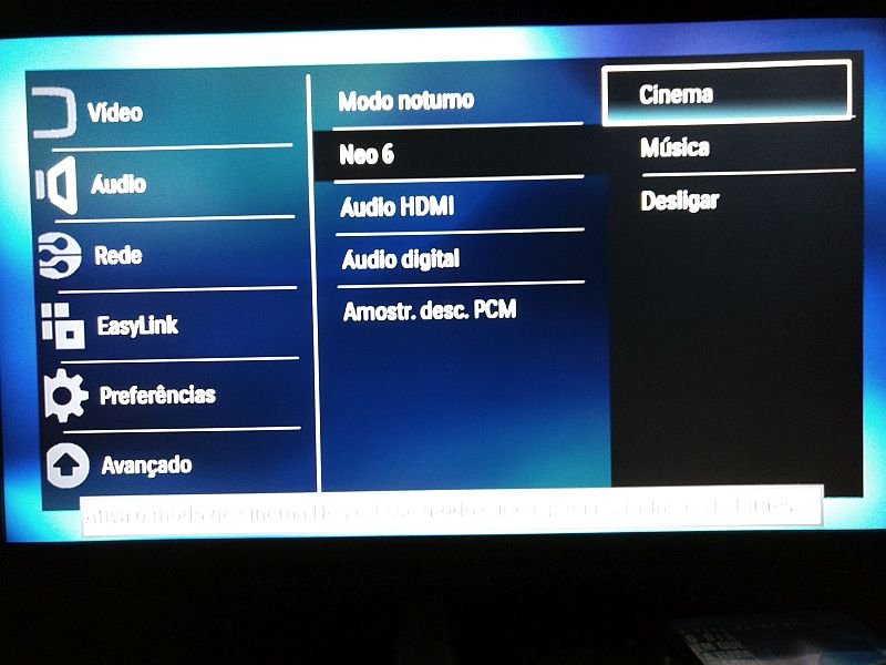

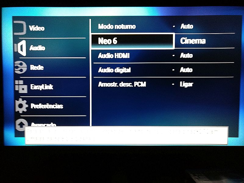

As to the audio setup in the BD player, I found some settings I know nothing about. I took some pictures to show you. Unfortunately, I couldn't find how to set the whole thing to English, so the language you see is Brazilian Portuguese. I hope you can get some ideas from certain tech terms that appear in the pics.
[Attachment 48779 - Click to enlarge]
[Attachment 48780 - Click to enlarge]
[Attachment 48781 - Click to enlarge]
[Attachment 48782 - Click to enlarge]
The first item on the list is Night mode. And there is this PCM and bitstream thing on the Neo 6 list. That blank ribbon in the lower part of the images shows details about each option, some referring to 7.1 and stuff. I'm lost!Last edited by Paultx; 25th Apr 2019 at 08:36.
If you don't have a multichannel environment, just your TV, then you don't need to enable NEO 6.
https://www.lifewire.com/dts-neo-6-1846892
