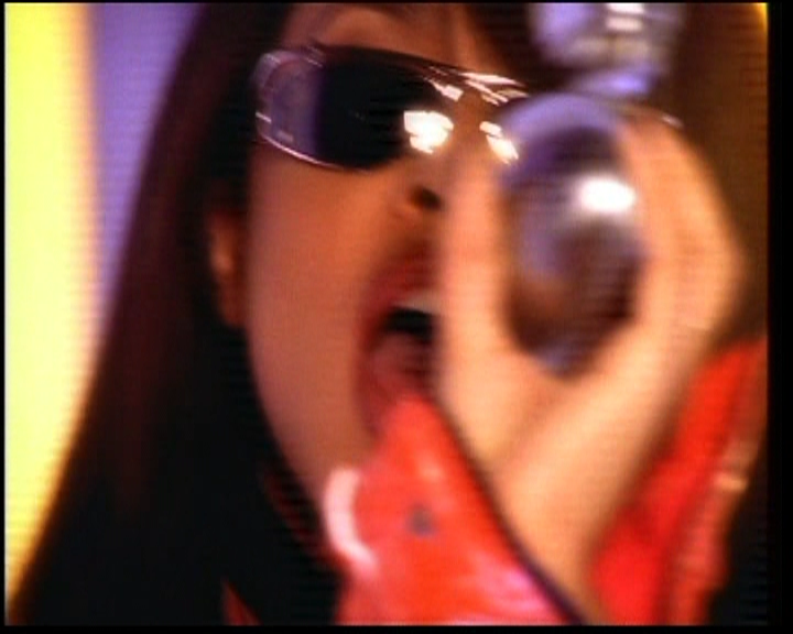

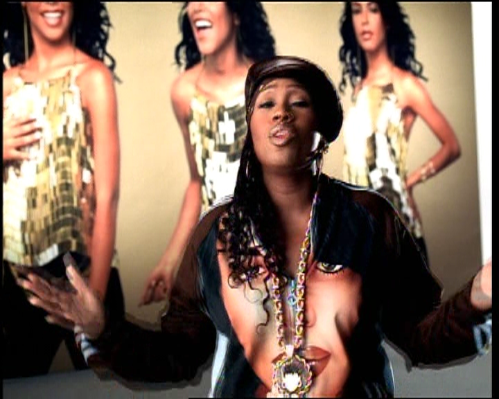

  1. After a few hours trying multiple combinations in attempt to salvage these files as a beginner, I'm turning to the pros!
    I do believe those videos were shot on film (24fps) as I do see some film scratches on the files. This is the best combination I could come up with for those files, does anyone have a better way to find those files?
    a = LWLibavAudioSource("Miss You.vob")
    v = LWLibavVideoSource("Miss You.vob")
    AudioDub(v, a)
    bob(-0.2,0.6)
    srestore(frate=23.976, omode=6)
    Vinverse()
    a = LWLibavAudioSource("Got To Give It Up (feat Slick Rick).vob")
    v = LWLibavVideoSource("Got To Give It Up (feat Slick Rick).vob")
    AudioDub(v, a)
    bob(-0.2,0.6)
    Vinverse()
    Thanks!
  2. QTGMC+sRestore seems like the right approach to tackle the blends, sadly that does not help with the frames around scene changes, you probably will have to replace those with an adjacent frames. (looking at the source when applying Retinex shows all the horror of the blends and compression artifacts)
    MCTemporalDenoise also helps with some of the artifacts.

  3. Originally Posted by Selur View Post
    Thanks! I'll try it out.
