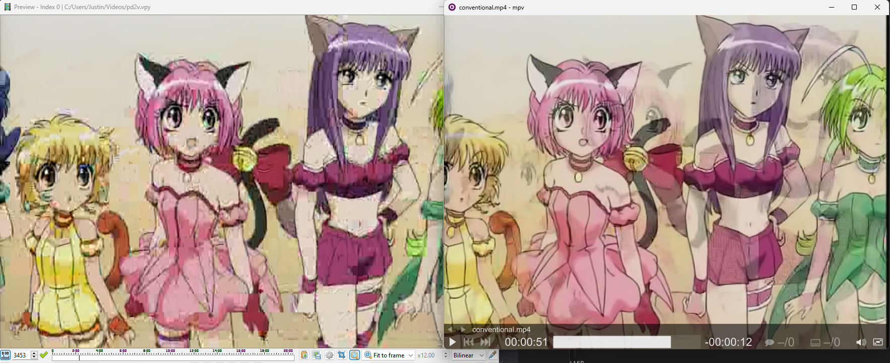

    This source has frame blending from NTSC to PAL conversion in an inconsistent pattern (from what I can tell), as well as some kind of outline overshoot on some fields. It also seems to have the field order incorrectly set to BFF when it's TFF.
    Incorrect Field Order
    If you Bob deinterlace (to look at each individual field) you will see it's sort of Jerky. Where it kind of goes back and forward a field (now "frame").
    Jerky Showcase (at 1fps): https://mega.nz/file/VpgiSTJZ#dDqLpsDibPElEZv7EYn46Y9pGebzsYPiyVvFxxW17FI
    When deinterlaced by MPV using real-time deinterlacing, it does not happen, even when seeking frame-by-frame.
    When deinterlaced in VapourSynth by Bob/QTGMC/YADIF, it happens.
    I've already found a fix for it, swap each field and then weave them back together (BFF to TFF by swapping the fields):

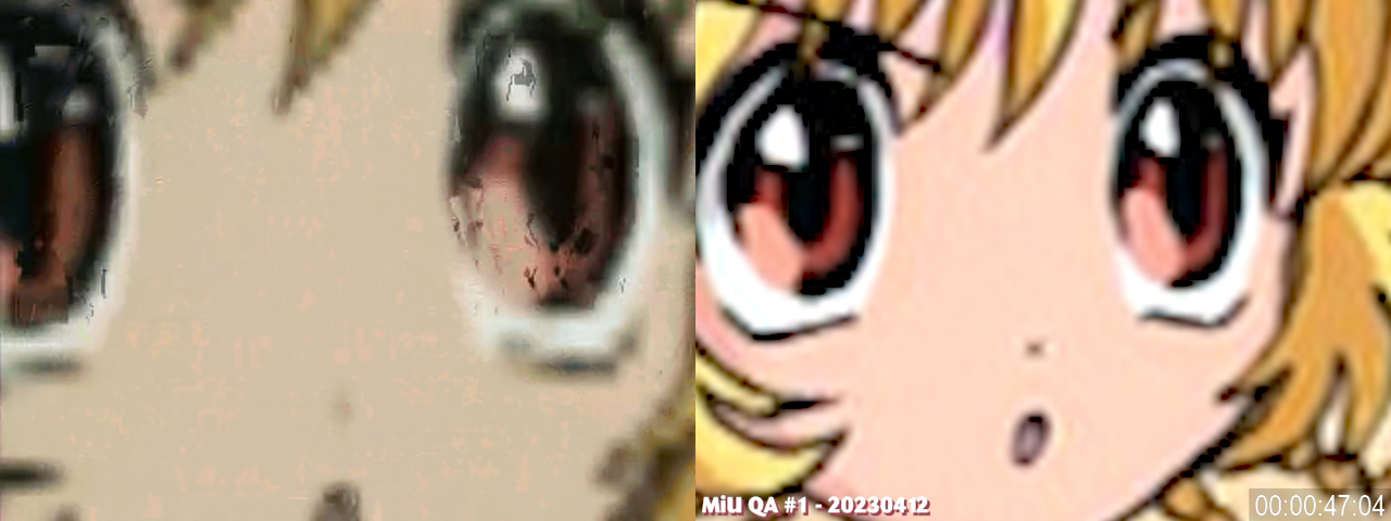

    clip = core.std.SelectEvery(clip, cycle=2, offsets=[1, 0])
    clip = Weave(clip, tff=True)

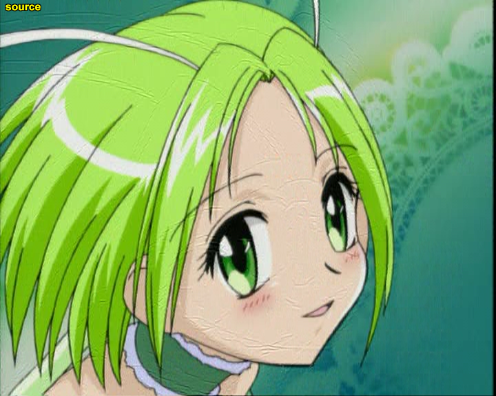

    Also any ideas on fixing the frame blending or the weird spouts of outlines (where no color and only bits of the outline are ghosting)?

  2. Originally Posted by PRAGMA View Post
    Could this be a DGIndex error?
    Yes. The jerkiness when double rate deinterlacing looks like a DGIndex/MPEG2Source/D2V source filter issue . DGSource, LSMash work ok
  3. Originally Posted by PRAGMA View Post
    Some of them are tricky, without any nearby "clean frames" (not even to clone from or paint manually). It's a very crappy source. I'd take a serious look for another source
    I don't see an "easy automatic" way for many of the contaminated frames, and some of them are "unique" frames with unique motion (basically critical that you fix it; unless you are willing to accept some duplicate and bad motion)
    You can make use of some filters to speed up the work, such as high dpir filtering strength . But you have to roto/mask/layer/composite back the details from a weaker filter layer and/or nearby frames. It will take some manual work IMO if you want to clean it up properly . If the whole DVD is like this, it's a lot of work. Find some fans/forums and divide up the work

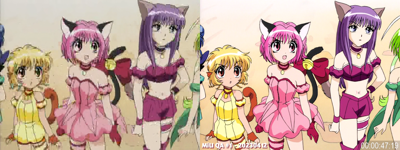

    Looking at the file the last quarter (starting the 'MewMew Power'-logo) seems to be just broken.
    For the fun of it, I threw DPIR, Despot and BasicVSR++at the first 1600 frames (script: https://pastebin.com/BuS0QG6e) while going down to 18fps and attached the output.
    Also attached a more attentional approach using McTemporalDenoise (script: https://pastebin.com/Sr1muQxH).
    => with some scene-by-scene filtering, one could probably find a balance between throwing away stuff and keeping details, but I agree with poisondeathray you should better look for a better source. Especially for the last part of the intro, I see no way to rescue anything like:
    when the frames next to it look similar.

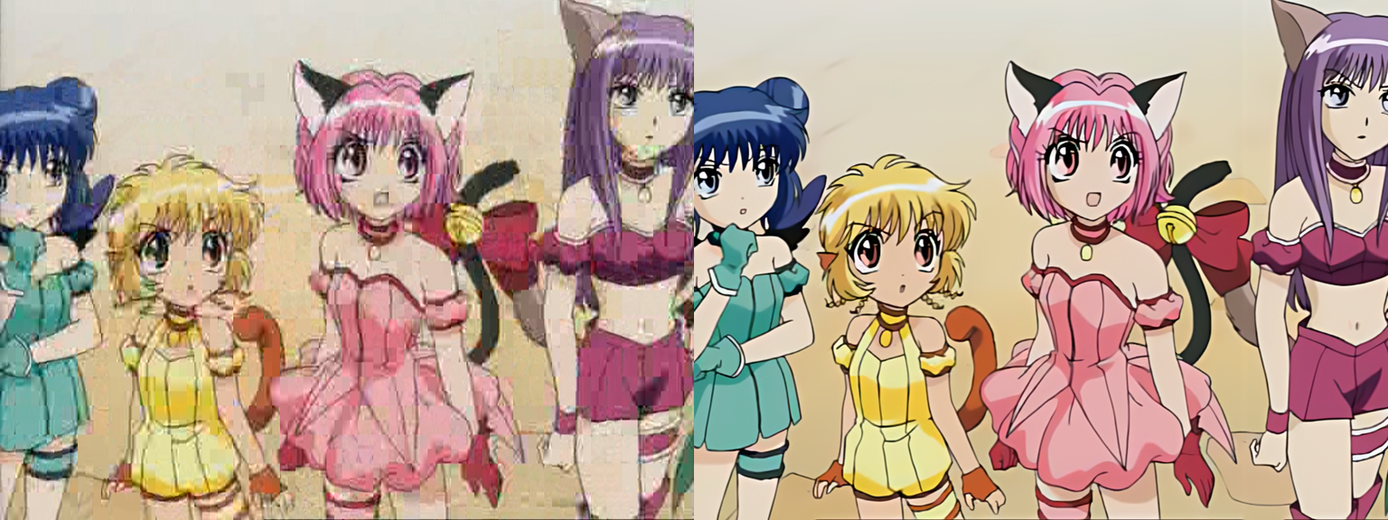

  12. Interestingly, in Selur's encode there's a scene where what should be the next frame is blended and low opacity. Yet on my Script, I have that frame (but its heavily compressed).
    See:
    [Attachment 70257 - Click to enlarge]
    The previous frame on both my script and his encode is correct, yet this frame I have it normal (but heavily compressed), he has it blended. Strange!
  13. Result might look better depending on the position of sRestore and McTemporalDenoise , moving McTemporalDenoise before sRestore might help.

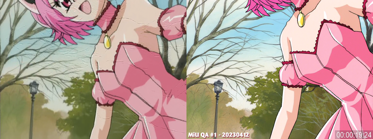

  14. Originally Posted by PRAGMA View Post
    The blending pattern seems very erratic. Sometimes there are blends separated by only 1 or 2 good frames, sometimes a good second apart. However, to me, they all seem to be duplicate frames from either the previous or the next frame. Meaning if you just discard that frame it's probably fine.
    Yeah, I knew of DPIR for a while but never gave it a shot until now. It's done quite a good job! Sadly the blocking in the intro is still quite apparent but it's somewhat better. However, what do you mean about compositing back the details from a weaker filter layer/neighboring frames?
    I was referring to fixing the "outlines" problem on some frames . They look like motion artifacts from a bad encoder and insufficient bitrate.
    eg. This frame is a "unique" frame, and the frame before and after are heavily blended
    (This is an apng, it should animate in most browsers)
    You can use high dpir filtering strength (or some other denoiser), enough to remove the "outlines", but high strength (not just dpir, any denoiser) will also damage wanted details. In this example - look at the BG latticework and 5 vertical line detail beneath the eyes (lower eyelashes)? , tongue is desaturated, face and hair shadowing, chin dimple. I don't know about you, but that detail loss bothers me.
    You can use compositing techniques to add back the details; such as combining a lower strength dpir layer for the BG. Or add details from other fields and frames - if they were clean or you cleaned them in another step - basically clone them into the current frame. Many of the motions in this style of animation are simple translations - so you can go a few frames forward or back, and often motion tracking can help assist copying textures into the current frame. Usually that compositing part would be done in something like After Effects, Nuke, Natron - ie. compositing applications which have tools to make accurate masks and accessory tools. A procedural mask in vapoursynth/avisynth usually would not be accurate enough for work like that. And of course you can add other filters afterwards - sharpen, upscale etc.. many machine learning algorithms work well on this type of content
    Not just the "outlines" either ; some of the blocky frames are "very blocky" , but a few frames away in a pan might have some clean(er) textures you can use

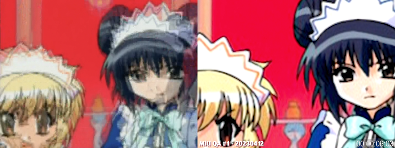

  15. Here is an example of cleaning up blocky frames using similar method of combining layers (or frames in this case, into a larger frame). No deblocking filter (not even machine learning ones) will clean up bad frames like that cleanly.
    You spatially align 2 frames together near the beginning and end of the pan (cleaned with some filters - in this example using dpir, realesrgan) into a clean plate then animate it. If it was a larger scene, longer pans, you can patch more adjacent frames. You can make real 50p motion if that was your goal (the example below was compared to "50p QTGMC" version, and slowed for comparison purposes at 5fps) , or 24p, or time it to whatever you want. The duplicates and blends are just replaced with the animated motion frames. You can add motion blur (in modern animation productions, it would probably have motion blur @24p. But if you keep it at fake 50p, you can probably reduce the intensity of blur). Usually you want to keep the similar motion in terms of easing, acceleration, holds in the original animation. Because blends and unintended duplicates were a bit jerky, I chose to make it smoother, but keeping the strings of hold frames. You have full control because the animation for many scenes for this type of animation are just translation/zoom of static layers. The only different motion I could see is the pink girl's motion which is slightly more closed in the 2nd half
    [Attachment 70283 - Click to enlarge]

  17. Originally Posted by poisondeathray View Post
    When you talk about making a clean plate by aligning 2 frames together, what do you mean exactly? I'm interpreting it as you trying to re-create the original image that was panned left to right with, by merging the frames that are good together with each other, which would reduce the overall compression and blocking. Some blocky/compressed frames however would still be left over, right?
    The result you have here is quite nice, but if you notice the Yellow girl has a missing finger now, and the other finger outline is all mashed up. Not sure how that has happened other than denoising+deblocking effectively masking the finger, which I could totally see happening.
    Yellow girl finger - it's missing and mashed up in the QTGMC version, or a simple bob version, or a TFM version too . It looks to me like the last fingers are flexed into the palm. If you go frame by frame, check other frames, do you see any reference that has a "cleaner" finger reference? You can "fix" the finger if it was present in a source frame (it's not present that I can see); or you can photoshop it into the clean plate to make it look however you want.

    It took a while, and it's still in the final polishing stages, but alas!
    [Attachment 70317 - Click to enlarge]
    This is using the Japanese SD on BD release as source clips. Done a ton of research and contacted people to figure stuff out:
    https://gist.github.com/rlaphoenix/e2ef083a4beba29baf1731d5845199ca

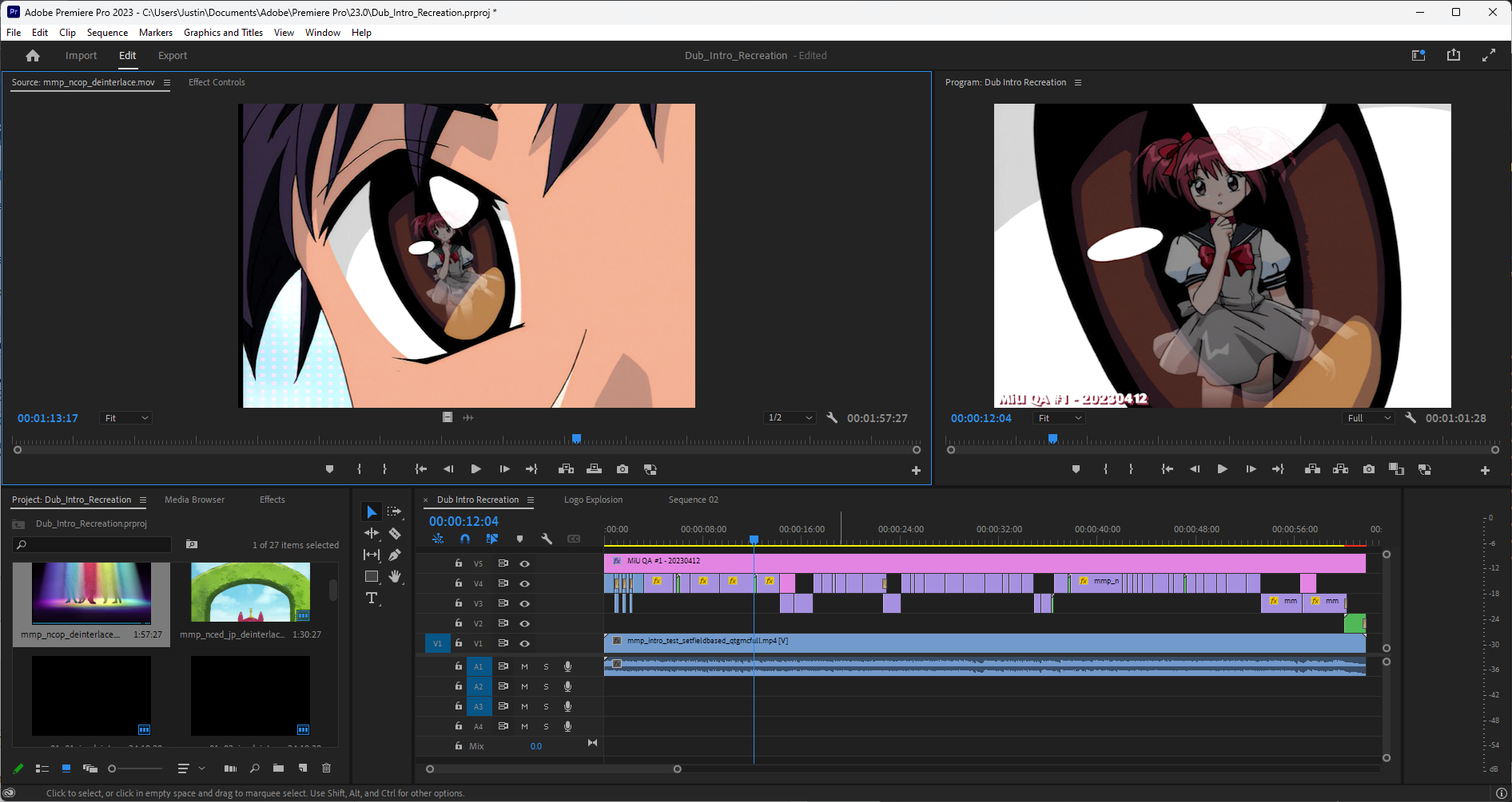

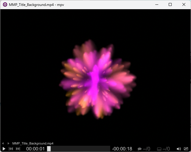

    I even managed to re-create the final scene with an explosion of colors and the Logo!
    A community for this anime already knew what was used, and from there it was simple enough.
    [Attachment 70323 - Click to enlarge]
    Preview export: https://mega.nz/file/Y4Al2DiS#rYqP_9V4GZl-fD7AxtIynVQKxu4xU9W_KtiY6d7wogQ

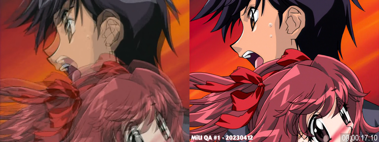

    Comparisons:
    [Attachment 70319 - Click to enlarge]
    [Attachment 70318 - Click to enlarge]
    [Attachment 70320 - Click to enlarge]
    [Attachment 70321 - Click to enlarge]
    [Attachment 70322 - Click to enlarge]
