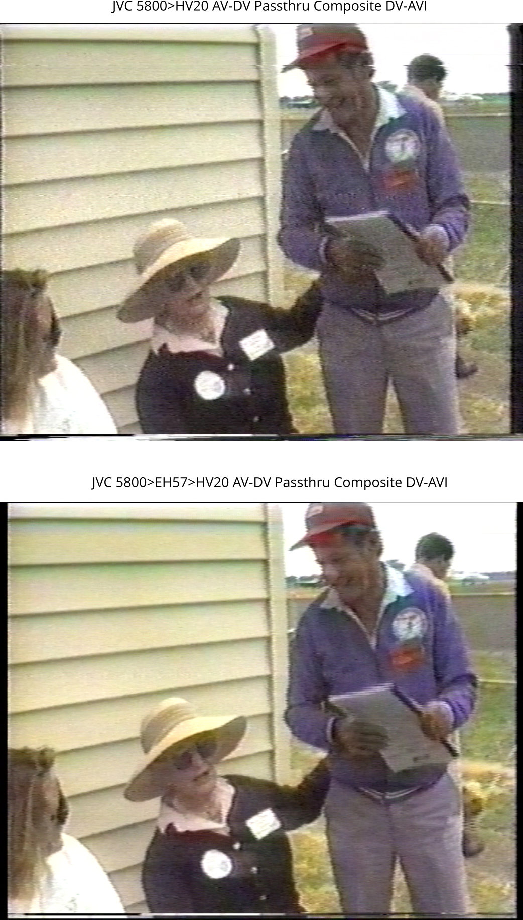

  6. Originally Posted by Alwyn View Post
    Originally Posted by VWestlife
    If you mean the Canon HV30, it can do a fine job of digitization, via its DV passthrough mode.
    On bad tapes, it doesn't, IMO.
    The HV has no stabilising properties at all; it simply passes-through all the bad details that are on the tape. It might keep the AV in sync, but it certainly doesn't improve any defects in the image. Check waves at the top of the frame.
    The stabiliser used here is a Panasonic EH-57. Both of these were captured with Scenalyzer.
    [Attachment 93213 - Click to enlarge]
    I know you want to show the flagging (waves), but it looks like the EH57 has significantly less noise (less details?) than the HV30 variant. Has any filter been involved?
    I did notice that so I turned the EH57 NR off, but it still smoothed it out.
