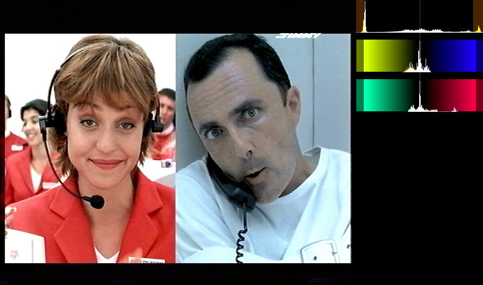

    Alwin, i do not know where you read that, but is completely false.
    AmarecTV properly captures in the YUV range. No internal conversion to RGB is performed.
    An example of a GV-USB capture with AmarecTV of a source in 0-255 YUV range:
    A conversion to RGB (emulated here in AviSynth) and back to YUV would produce this:

    @Sharc, reading the original post included by Alwin, I do not think that the OP meant the "display" environment, he mentioned the "pure YUV capture" and "video levels", so clearly he does not know what he's talking about.
    edit: I found the source, is a digitalFaq post https://www.digitalfaq.com/forum/video-capture/15658-vhs-audio-sync.html. Among the whole amount of non-sense about AmarecTV, this one is pure fantasy:
    on this forum argue that while AmarecTV seems more stable, it’s essentially masking the underlying signal issues. VirtualDub 1.9.11 is generally the gold standard because it’s brutally honest. It reports every dropped frame and timing jitter.
    It is the opposite. AmarecTV reports in detail what's happening during the capture, with all the information needed to understand where the inserted and the dropped frames are located. VirtualDub just provides a counter. Both drops/inserts frames when is needed. The amount of mis-information about capture softwares and modern cards on that site is unbelievable.

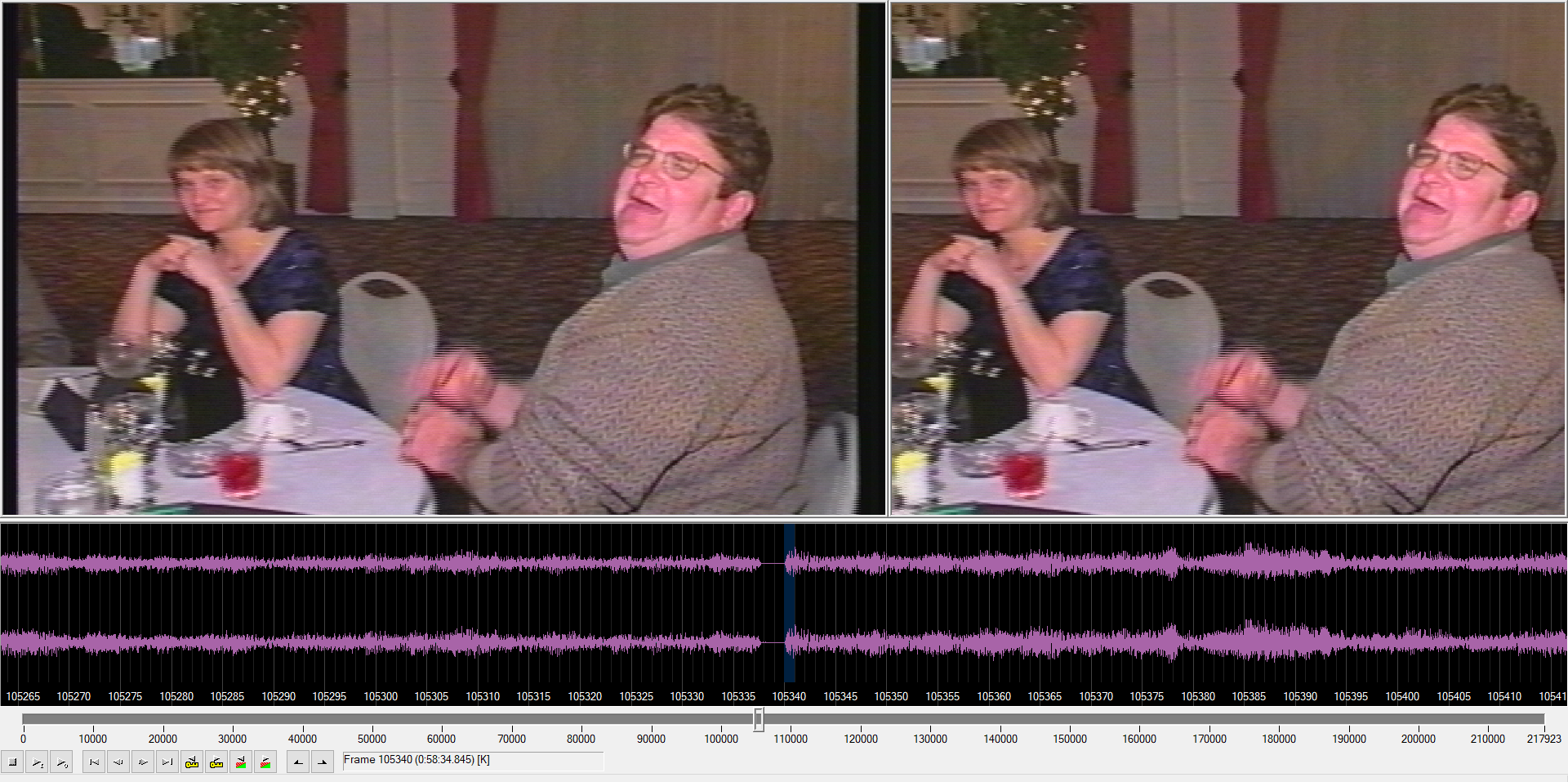

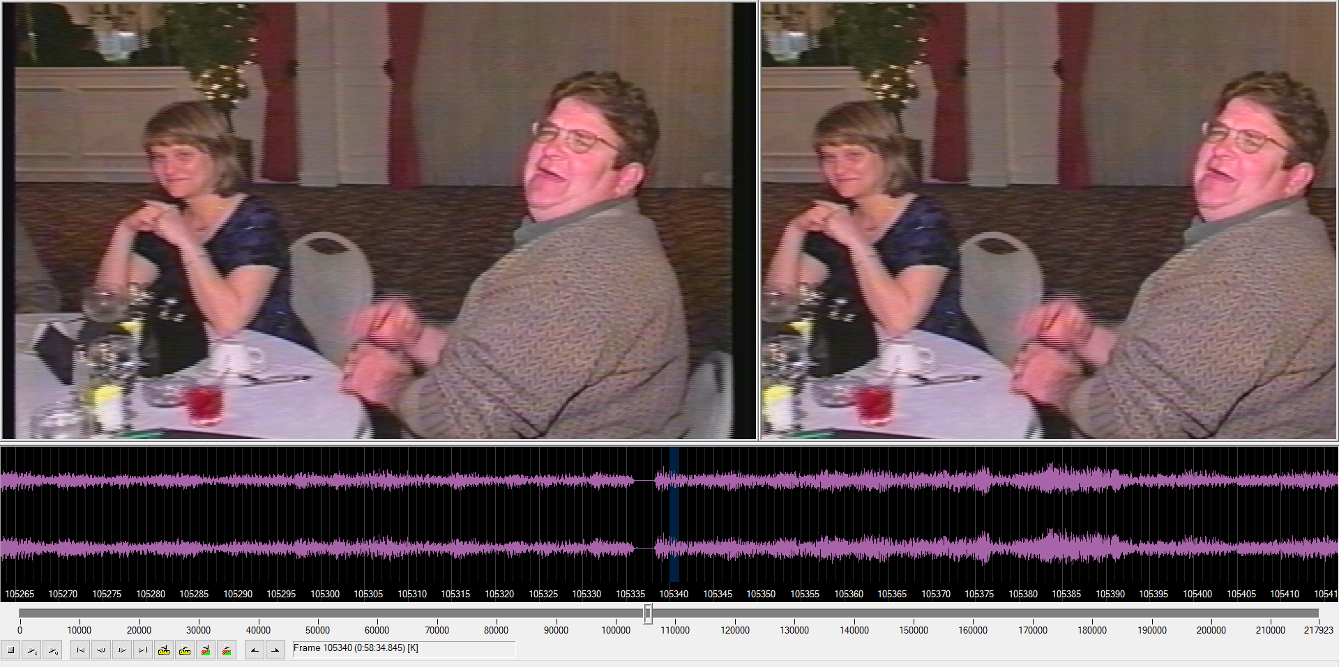

    That's the wrong take. Most audio is +/- several frames, especially in broadcasting. Analog was never 100% perfect even within the camera. Sound and light travel at different times, so it's actually impossible for "true sync" to exist anywhere.
    I understand that, audio is always going to be slightly out of sync between captures of the same VCR or different VCRs even with a TBC. It's analog, there is always going to be some small percentage of difference. But from what I've noticed, it'd only be off by less than 6 milliseconds.
    What I'm trying to get at is that the external TBC adds in a delay of one frame, but since it only processes video and not audio, the audio is not compensated for the added frame delay.
    So that means the audio in my captures is always off by one frame, but since the audio otherwise is in sync (ie it doesn't get further out of sync over time) I can easily match the audio back to it's proper timing by adjusting the audio forward by 33ms (which equals to one interlaced frame)
    Now sometimes I'd have to adjust it by two frames, so 66 milliseconds, but that's because the tape has a one frame audio delay baked in.
    In my opinion it's the same deal as those DVD recorders (ES10 / 15), they add in frame delays so the audio must be adjusted to compensate. Only difference is you can route the audio through the DVD recorders.
    Edit - To demonstrate my point here are two images, one with the audio delayed by 66 milliseconds and one where the audio is not delayed.
    The previous frame in the video is the end of a previous scene, so this frame is the start of a hard cut to a new scene. So pretty much I fixed the audio by delaying it by two frames, first to compensate for the one frame delay caused by the external TBC and the other by the one frame audio delay that's baked into the tape.

    Originally Posted by lollo View Post
    I wrote here, you can download the files and practice a bit: https://forum.videohelp.com/threads/416657-Analog-Capture-inserted-and-dropped-frames
    Well I loaded the avis you gave for frame insert demonstration and VirtualDub reported one inserted/duplicated frame in the 'with problem' avi file, frame #209 at 0:08.360.
    So how many inserted frames are in this file, just one or is that incorrect?
    Just one.
    I mentioned that old example only to reply to lordsmurf assertion about dropped frames, because in that thread there is also a sample with 1 dropped frame that, obviously, VirtualDub (or any other software) is not able to detect (you have trace of it only in AmarecTV log file).
