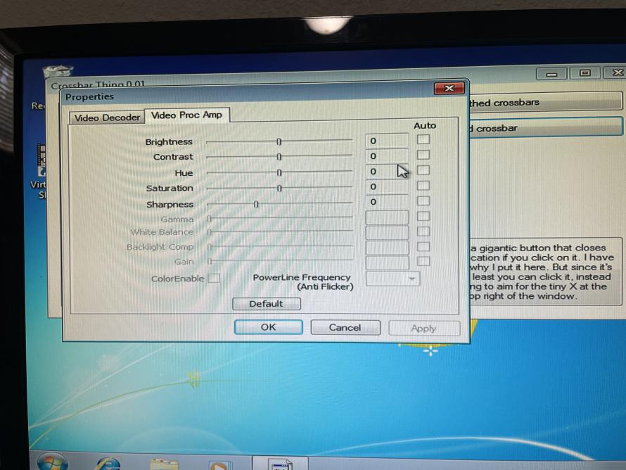

    Capture with windows 11, by using virtualdub with huffyuv codec. Pinnacle usb 710 S-video sony handycam. The audio looses sync gradually, I can only notice it after 60 minutes of capture. If I use windows 7 the whole videofile will be out of sync, the settings are the same on both computers and OS.
    Crossbar thing is set up.

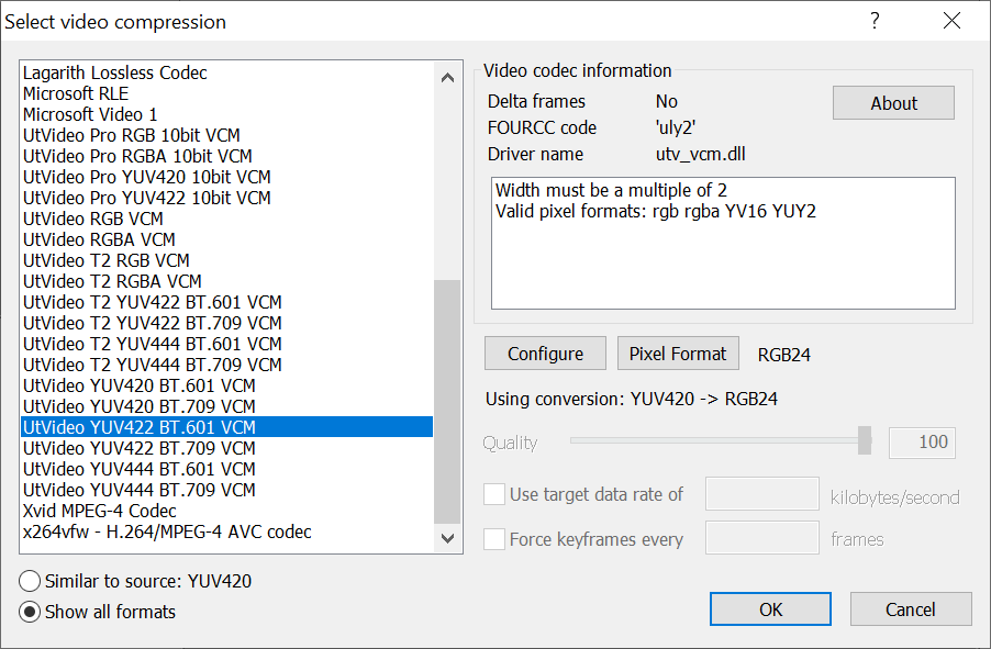

    In Virtualdub, uncheck preview and Using UT Video ULY2 codec + Audio no compression to record.
    [Attachment 84494 - Click to enlarge]
    Claudio

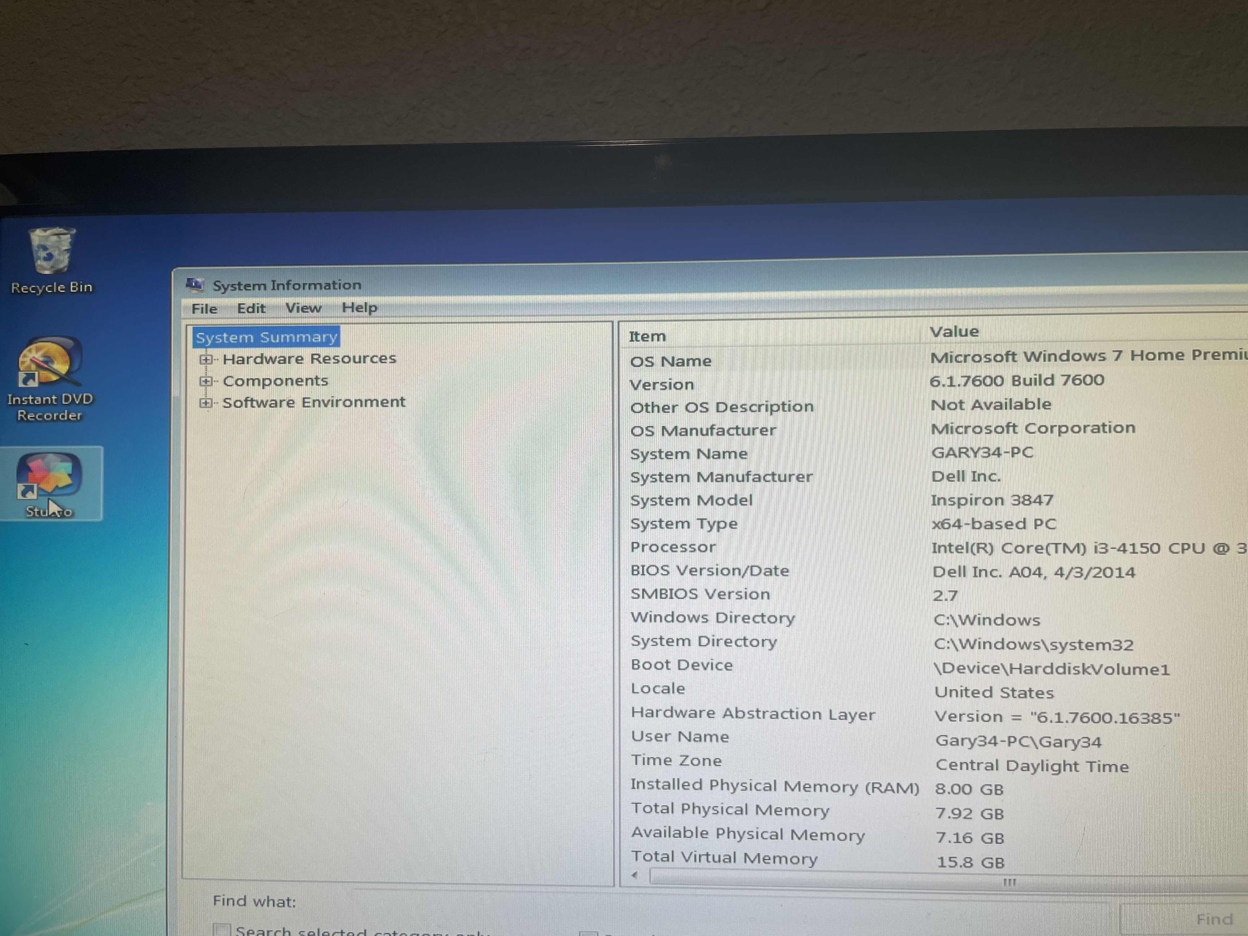

    My system is a Inspiron 3847 and it’s windows 7 64 bit. The install DVD says windows XP and Windows Vista on the front. Anyways for me with Virtualdub that fixed the issue. My 510 was from LS and my 710 I bought unopened from eBay.

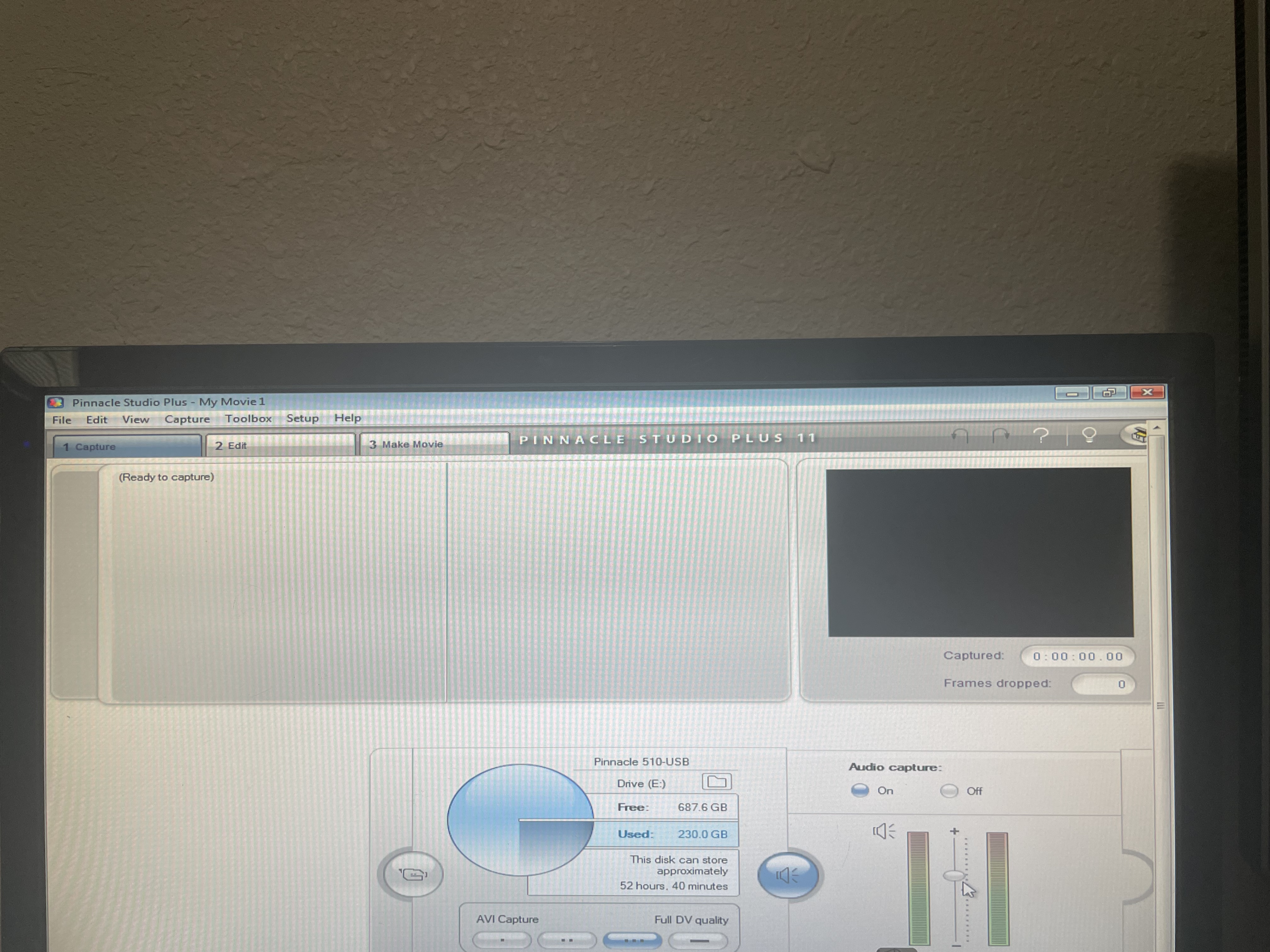

  28. Finally manage to get it work. But only in Pinnacle Studio Ultimate from dvd that came with it. It just won't work in Virtualdub I tried crossbar switch to s-video restart nothing, just black screen, put in preview video not overlay, still nothing. Tried amarectv it gave me some errors right on the start of program, and in amarectv options when I switch in video and audio to Pinnacle 710 USB it said no audio and it reads something from video some resolutions to pick, but whatever I pick it won't show anything. In Pinnacle Studio I manage to get it work I disconnect it from my USB 2.0 and connect again and it worked. I am going to use in like that because in all other programs it just won't work for some reason, even If I get it to work half way it only gives video no audio.

    When I used Pinnacle studios my crossbar thing for virtualdub went from just having video decoder and video proc amp Image
    [Attachment 86678 - Click to enlarge]
    to having all of my options. Image
    [Attachment 86679 - Click to enlarge]
    I have read LS say that some of the bad versions “marry” Pinnacle studios and they refuse to work with other software. I’m familiar with the chips you named off. I looked up all of that before and different stuff about the card. Still when you go to troubleshoot version becomes an unknown variable. No way I would buy one from eBay again. I have heard Pinnacle Studios is junk ware for capture. Maybe either getting the right Pinnacle or just using one of the cards that someone else mentioned with Amerectv would be a better idea than using Pinnacle Studios.
  30. When I enter crossbar I have both, there is pinnacle 710 usb(crossbar) and pinnacle 710 usb and I can enter both options just like yours on pictures.
