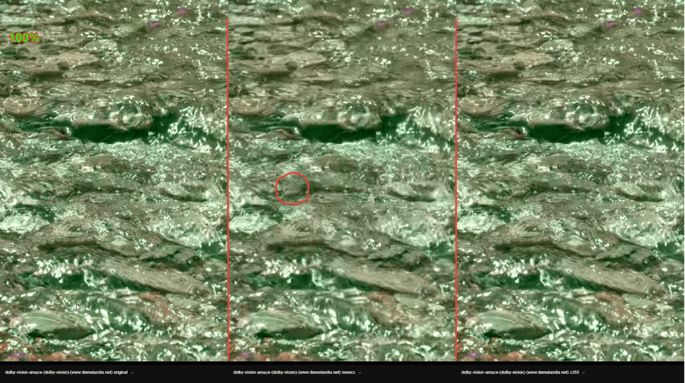

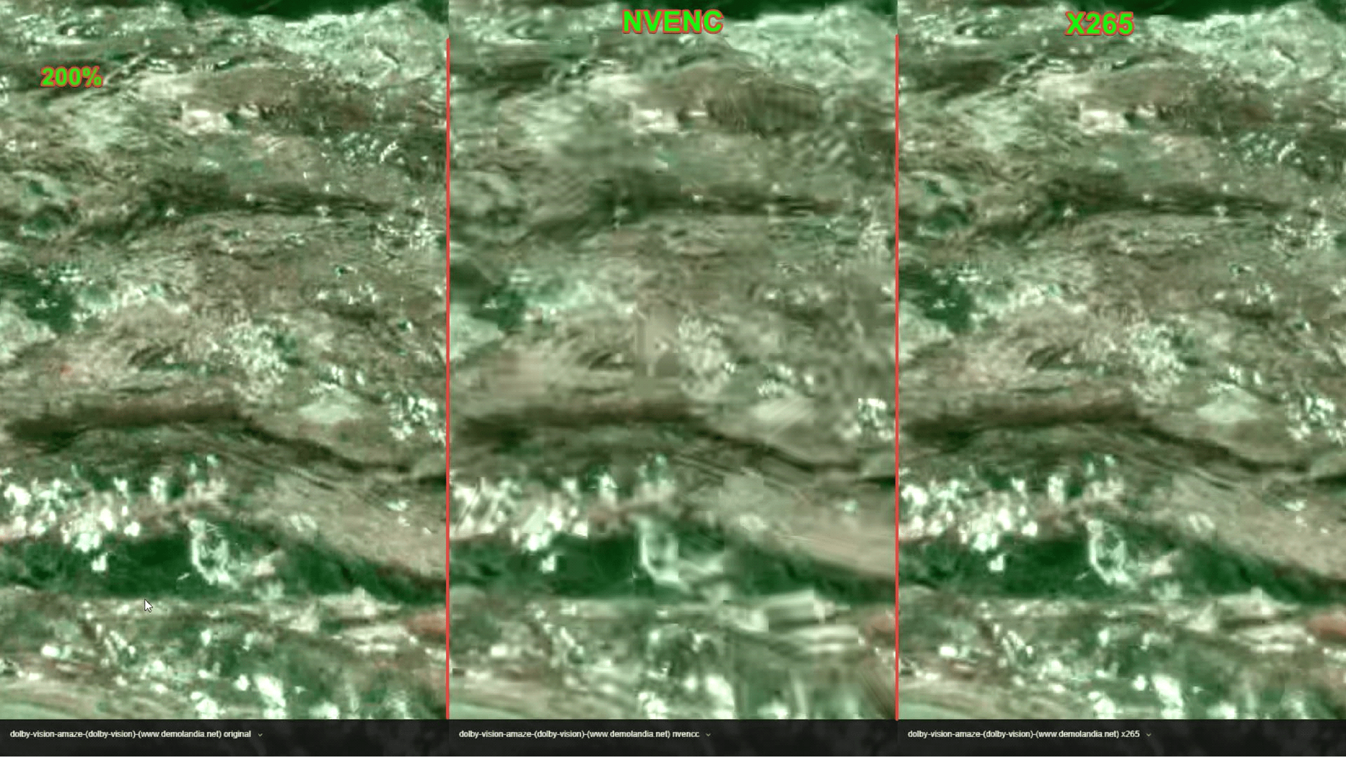

  12. I did a first test without intervening on the parameters that you recommended and on scenes with high movement where the bitrate is not evidently sufficient you can see as X265 CPU is superior of NVENC H265.
    This is evident on the still image but I want to see if a difference is noted in the movement/play.
    orig file: dolby-vision-amaze-(dolby-vision)-(www.demolandia.net).mp4 4k
    resize 2160p / UHD -> 1920 x 1080, plus:
    • nvcencC 7.50 --qvbr 28 --codec h265 --output-depth 10 --vbv-bufsize 45000 --max-bitrate 15000
      (9190.40 kbps)
    • x265 3.6+2+13-9a3dac6e5-.Mod-by-Patman.-x64-avx2-msvc1937 --crf 22 --output-depth 10 --vbv-bufsize 45000 --vbv-maxrate 15000
      (9151.27 kb/s)
    Let me know if the file generated by ICAT works: index.zip
    [Attachment 78952 - Click to enlarge]
    [Attachment 78953 - Click to enlarge]
    nvenc in still image is horrible.
    EDIT: I think I made of errors and the VBV parameters on X265 CRF are not valid/ignored, right?
  13. As I understand it, VBV parameters can be used with CRF encoding in both x264 and x265.
    It's not surprising that x265 is better than NVEnc. That's been my experience and, I believe, the general consensus. The 4xxx series may do better than your 3060 though.
