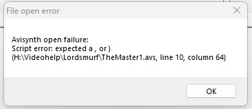

    Themaster, I'm getting this on your script:
    [Attachment 78540 - Click to enlarge]

    LS, I got a warning about being divisible by 4, so I cropped it to 336. Might be the same issue?
