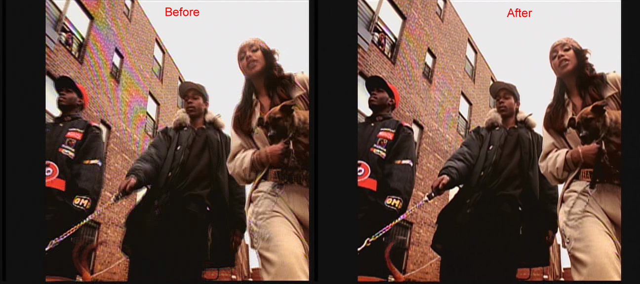

The new function created by StainlessS over at doom9.org gets rid of about 95% of the rainbow, except at the frame before scene changes. Here's the script I used. You'll want to tune the parameters to get the right trade off between removing rainbows and noise, and removing too much detail (typical denoiser tradeoff). You will see that the rainbow is gone from the brick in the upper left corner. Also, because of SRestore, all the fuzziness caused by the bad fields has been corrected. You will see this most prominently in the right hand holding the leash, and also around the woman's right hand (notice how her bracelet is now sharp and clear).
You can get more rainbow removal by increasing RadT. This uses more frames, but slows down the operation. You can decrease the noise reduction by reducing the two ThSAD values.
Code:source=AVISource("E:\fs.avi").KillAudio().converttoYV12(interlaced=true).AssumeTFF() bob(source,-0.2,0.6) srestore(frate=25, omode=6) output = SpotLess(ThSAD=1000,ThSAD2=1000,RadT=4,Chroma=true,BlkSz=8,OLap=4,Tm=true) return output /* Interleave( \ source \ , trim(output,1,0) \ ) */ Function SpotLess(clip c,int "RadT",int "ThSAD",int "ThSAD2",int "pel",bool "chroma", int "BlkSz",Int "Olap",bool "tm",Bool "glob",Float "bBlur") { RadT = Default(RadT,2) # Temporal radius. (MCompensate arg) ThSAD = Default(ThSAD,10000) # SAD threshold at radius 1 (Default Nearly OFF). ThSAD2 = Default(ThSAD2,10000) # Setting lower, sets SAD thresold to limit blurring effect of more distant reference frame BAD matching blocks. (MCompensate arg) Pel = Default(pel,2) # Default 2. 1, 2, or 4. Maybe set 1 for HD+. (1=precision to pixel, 2=precision to half pixel, 4=quarter pixel) Chroma = Default(chroma,True) # MAnalyse chroma arg. If set to true. Use chroma in block matching. BlkSz = Default(BlkSz,8) # Default 8. MAnalyse BlkSize. Bigger blksz quicker and perhaps better, esp for HD clips. OLap = Default(OLap, BlkSz/2) # Default half of BlkSz. Tm = Default(tm,True) # TrueMotion, Some folk swear MAnalyse(truemotion=false) is better. Glob = Default(glob,Tm) # Default Tm, Allow set MAnalyse(global) independently of TrueMotion. Bblur = Default(bblur,0.0) # Default OFF Assert(1 <= RadT,"SpotLess: 1 <= RadT") pad = max(BlkSz,8) sup = (bBlur<=0.0 ? c : c.blur(bblur)).MSuper(hpad=pad,vpad=pad,pel=pel,sharp=2) sup_rend = (bBlur<=0.0) ? sup : c.MSuper(hpad=pad,vpad=pad,pel=pel,sharp=2,levels=1) # Only 1 Level required where not MAnalyse-ing. MultiVec = sup.MAnalyse(multi=true, delta=RadT,blksize=BlkSz,overlap=OLap,search=4,chroma=Chroma,truemotion=Tm,global=Glob) MultiVec = sup.MAnalyse(multi=true, delta=RadT,blksize=BlkSz,overlap=OLap,search=4,chroma=Chroma,truemotion=Tm,global=Glob) # Need to test for OLap<1 MultiVec_re = MRecalculate(sup,MultiVec, chroma=Chroma,blksize=BlkSz/2, overlap=OLap/2,truemotion=Tm,tr=RadT) #thSAD needs should not be hard-wired like this c.MCompensate(sup_rend,MultiVec_re,tr=RadT,thSad=ThSAD,thSad2=ThSAD2) MedianBlurTemporal(radiusY=0,radiusU=0,radiusV=0,temporalradius=RadT) # Temporal median blur only [not spatial] SelectEvery(RadT*2+1,RadT) # Return middle frame }Last edited by johnmeyer; 19th Sep 2020 at 23:17. Reason: Added pictures
